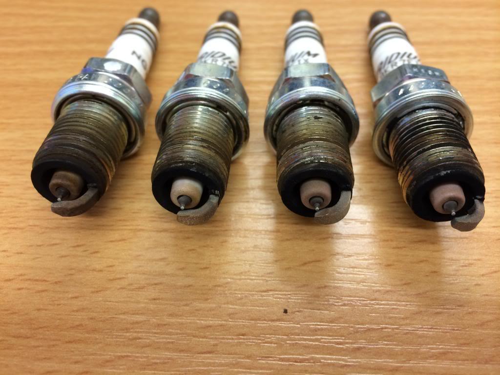

What spark plugs are you using?

Will take a look.  VW replaced them last service 8k ago.

NGK BKR7EIX
Don't look too bad.  Cylinder 1 (1-4 L to R) looks a tad different to the others so I'll replace them all to try and eliminate issues in this area.  Still doesn't get rid of the manifold flap faults. Just wanted to try and link the flap fault to the issue and didn't know if anyone who'd had this fault had noticed this hesitation at WOT.
