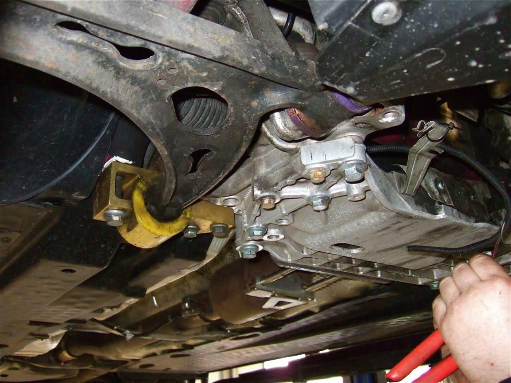

Do I see copper grease on your poly bushes?  If so, why?

they come with it in the kit

Poly bushes should NEVER use a copper based grease - only lithium based grease with MDS additives.  Otherwise the copper particles will just wear away both the actual poly bush, AND the housing which it sits in!  Copper grease is nasty sh!t at the best of times - and when use wrongly is just plain stoooopid.
Why was the Whiteline kit supplied with MDS grease?  :wink:
....Is it copper grease? I dunno - I don't know the differences.
If it's not what you think it should be, TT, and you want to know why? - Give VWR a call and ask - 01908 210088.
