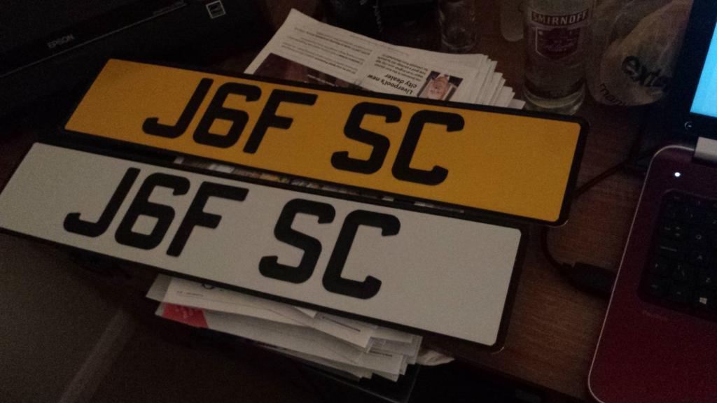

I got some pressed plates the other day, not sure whether to put them on as is, or buy some surrounds

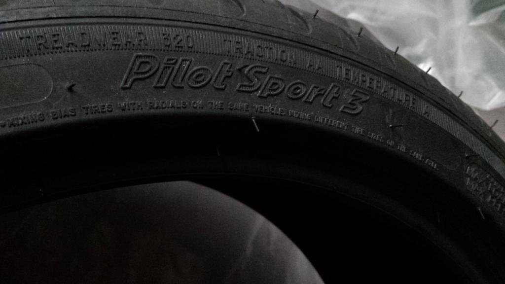

« Reply #48 on: November 25, 2014, 08:26:08 pm »

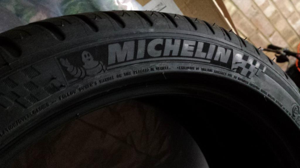

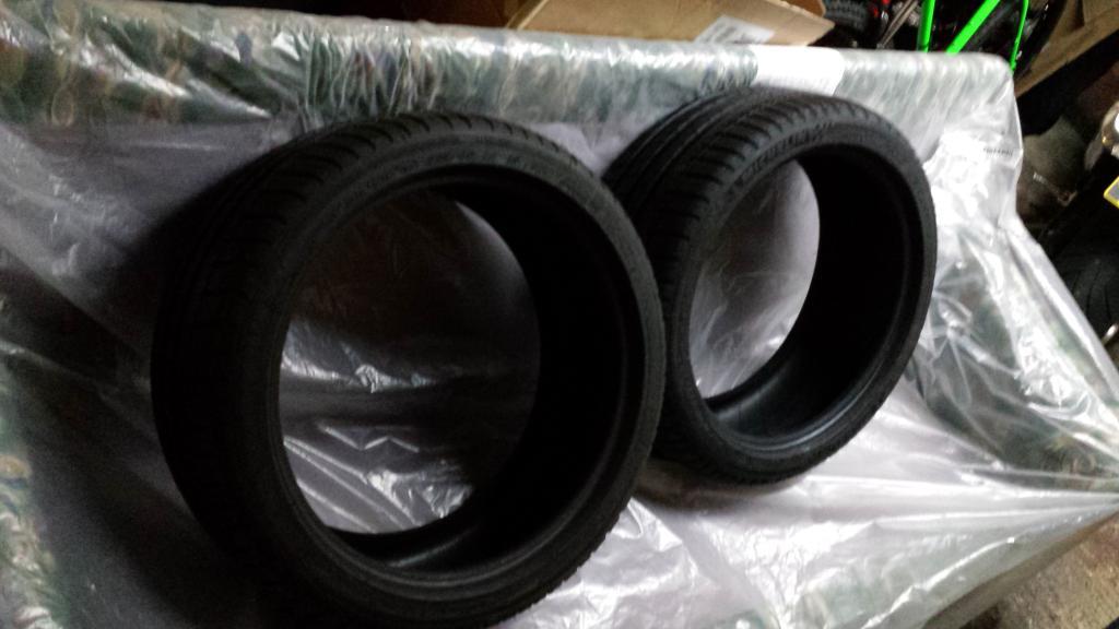

One of the remaining advisories on my mot were front tyres having low tread on the inside, so for my birthday I asked for a couple of Michelin Pilot sport 3's, Tom5190 has them on his s3 and recommended them over my bridgestone potenzas which i currently have and even I noticed they arent very good so i took his advise ill get them fitted when i have my wheels refurbed which im hoping will be my xmas pressie ;) I'll then buy my self another couple of ps3's probably early next year when the rears need changing
Im also going to buy some front radius arm bushes as that is the last advisory

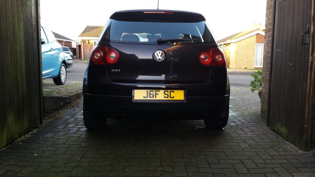

finally got around to getting my pressed plates on today, no more nails sticky pads should do the job!

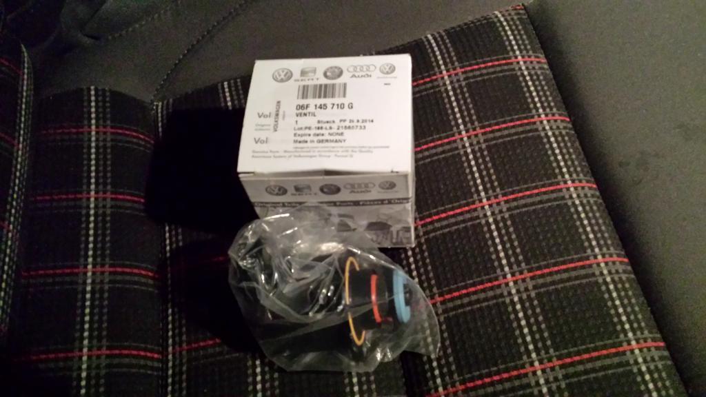

« Reply #50 on: January 20, 2015, 08:00:06 pm »

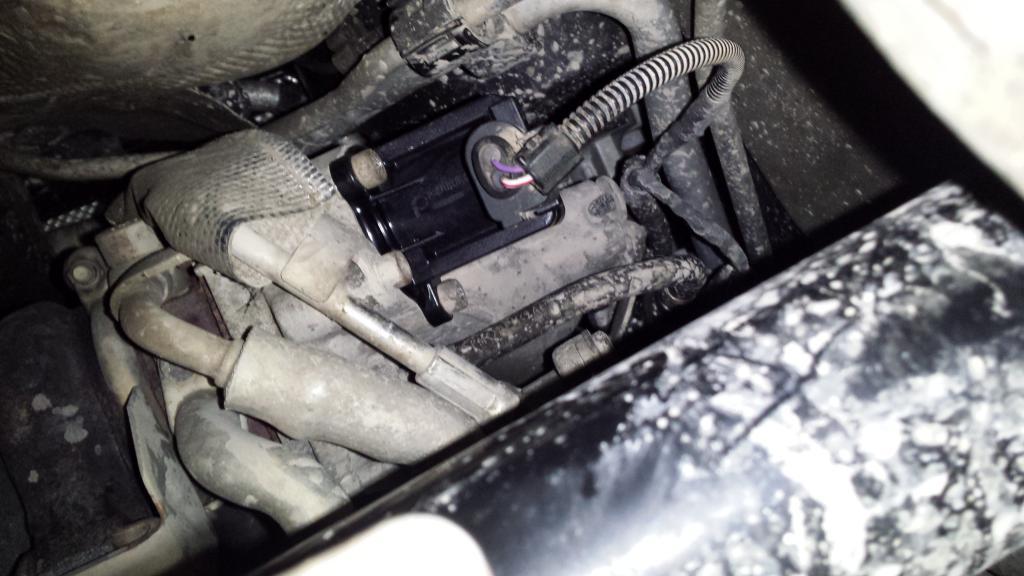

Just replaced my DV Rev B, i removed it at the weekend and it was fooked, picked up a Rev G tonight and just got it fitted, seems to pull better now
Bought it from TPS for £38, VW wanted £70 for a rev D, which is strange considering TPS is part of the VAG group where they get all their parts from.. also tried telling me the D is the same as the G 'its just a different manufacturer', so i just hung up in the end.. you cant tell them anything.....

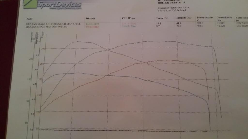

« Reply #51 on: January 28, 2015, 05:39:49 pm »

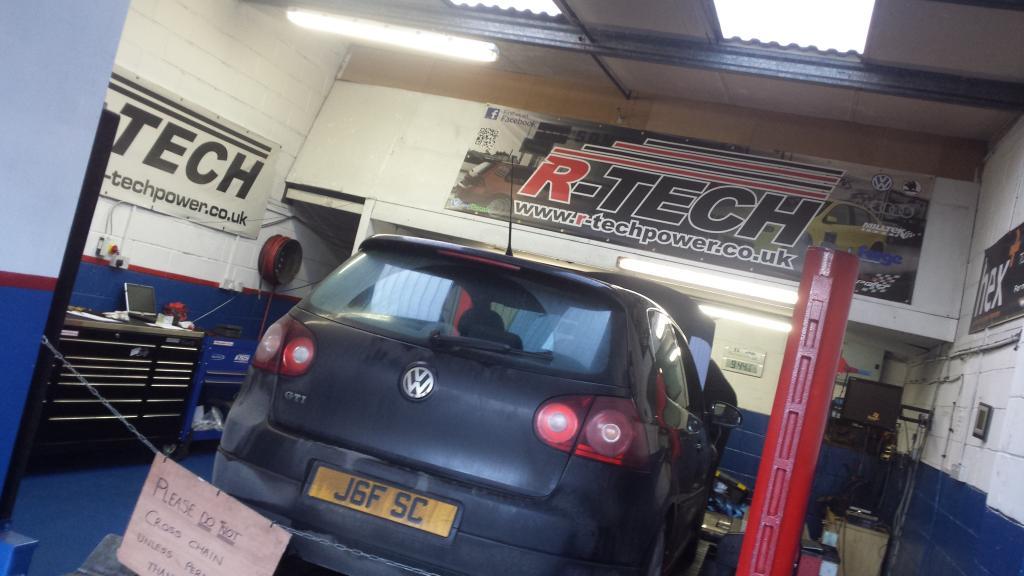

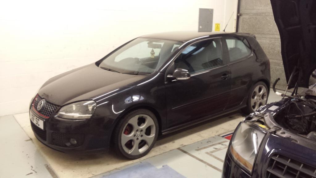

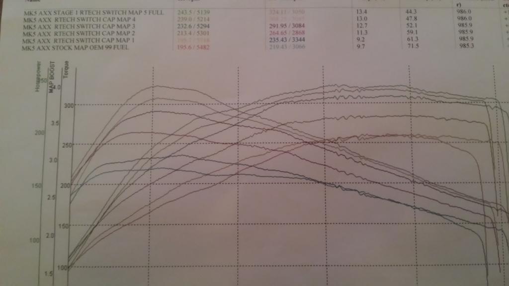

I got my car mapped today at r-tech, very pleased! By far the cheapest place at £290 and that is with the car mapped on a rolling road (not just road tested after the map is loaded like most places), so they also include before and after figures with a graph (again some places charge extra for this, even if they have a dyno) and lastly which I really wasn't expecting was that I had 5 maps loaded on to the car which i can change by using the pedals and the ignition, very cool and geeky! Which is ideal if the clutch starts to slip I can knock it down in power and torque.
She made 196bhp and 220ft/lbs standard and then 244bhp and 325ft/lbs after, so almost 50bhp more (25% more power).

Im also fitting audi S3 wishbones at the weekend and probably get my ps3's fitted along with a brake fluid change to motul rbf 600 in preparation for going to the ring

hi, no they didnt take the cat out or the pre-cat out if thats what you are asking. They advised me to get the pre-cat taken out by the company next to them (dynodaze, as r-tech now just do mapping) this obviously keeps the car legal, with an uprated panel filter they said I should get 250bhp from past cars they've tested, which tbh isnt far off a stage 2 set up,
the car is like a rocket ship now! ha keeps pulling nicely like a train up to the redline, but with the weather as it is and me living in the country Ive had very few chances to go for it, ive knocked it back down the the standard map this morning due to the snow

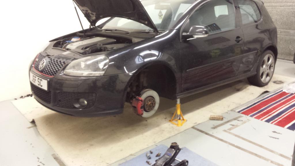

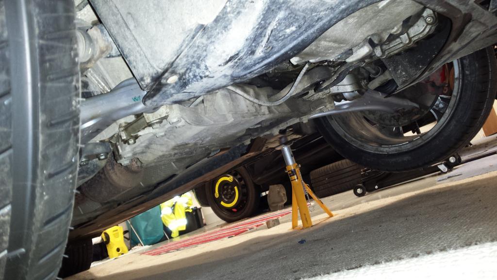

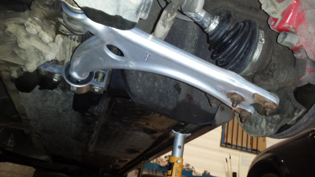

Offline Jeffchiz
  • Posts: 123

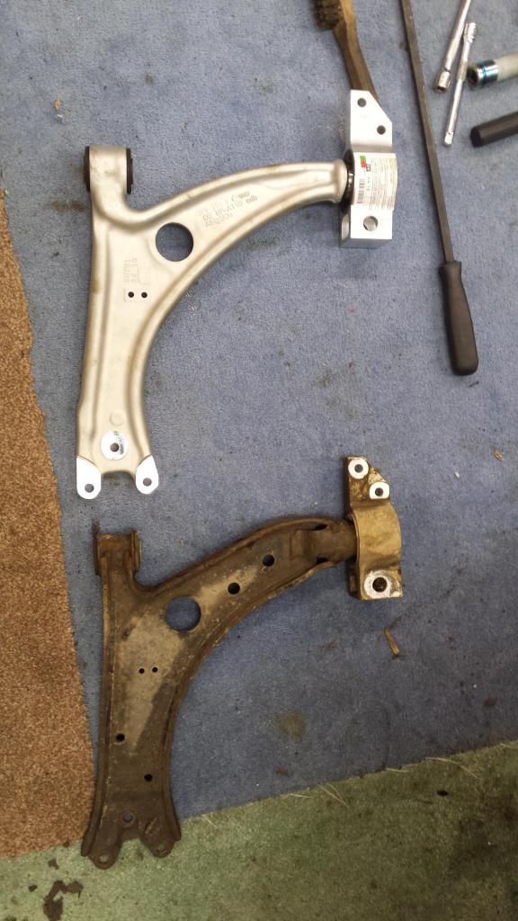

Been in the north east visiting my old mate tom so i could kindly use his unit and his help!

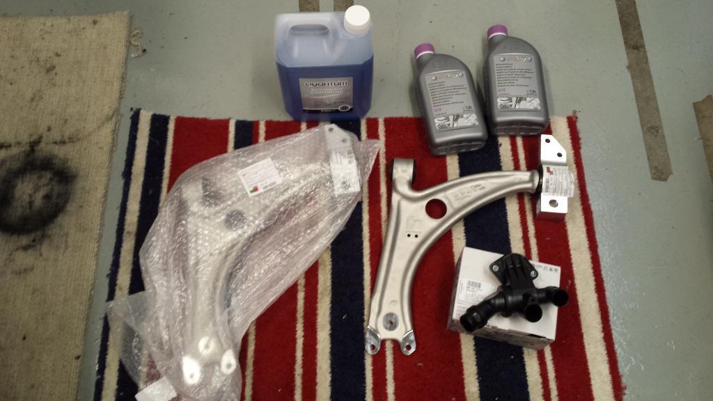

We got up early and after a fuel and coffee stop we got up to his unit and got the car inside after picking the S3 arms up from TPS along with a new thermostat and coolant (due to me being unorganised i didnt get nay brake fluid in time)
emptied the boot

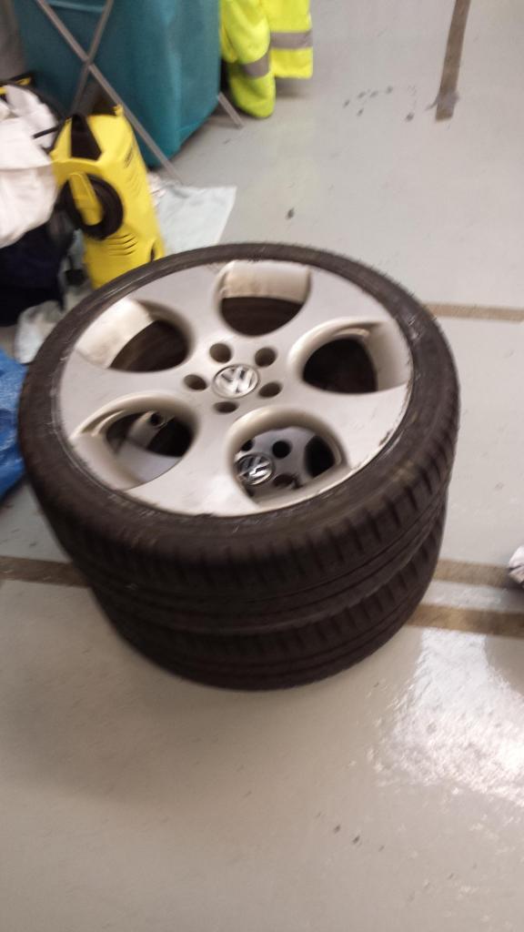

got the car up on stands, got the front wheels off an went around the corner to have my michelin PS3's fitted
Then once back at the unit we started on the wishbones, old gti vs new s3 arms
First one fitted (stupidly I forgot to order ball joints but mine are fine so no harm done
Tom fitting the second one (he loves pic of himself on my threads)
Final pic of both wishbones and wheels/tyres fitted, drove much nicer on the way home :D
Unfortunately we didn't realise how much of a ball ache the thermostat is or should i say how much of a ball ache it could be, either way its buried behind other components and it was getting late in the day so that will wait until next month when hopefully ill do another visit with the brake fluid and the bottom powerflex engine mounts, a bit more ring prep :homme:

great remap results considering the pre cat is still there. I had to remove mine to get those figures.
Offline patpong_pete
  • Posts: 313
so gti mkv 197 bhp std v remap 250BHP
r tech remap bhp ?? about 50 bhp
pre cat bhp ??
panel filter  ??
Offline Jeffchiz
  • Posts: 123
jeff coming along nice s3 wishbones how much are they from TPS
do they come with the console as well
just remember to get the tracking done as the new tyres might wear out on the inside
whats next on your list pre cat delete and panel filter
what the difference with s3 wishbones i know they are lighter
does it ride better less roll soild on a bend apex
thanks for all the updates and reply
They were  £225 from tps and yea they come with the consoles, as well as the lightness they also have solid rubber mounts compared to the voided gti bushes, basically the gti bushes have holes in them to allow more movement but makes the steering less precise
