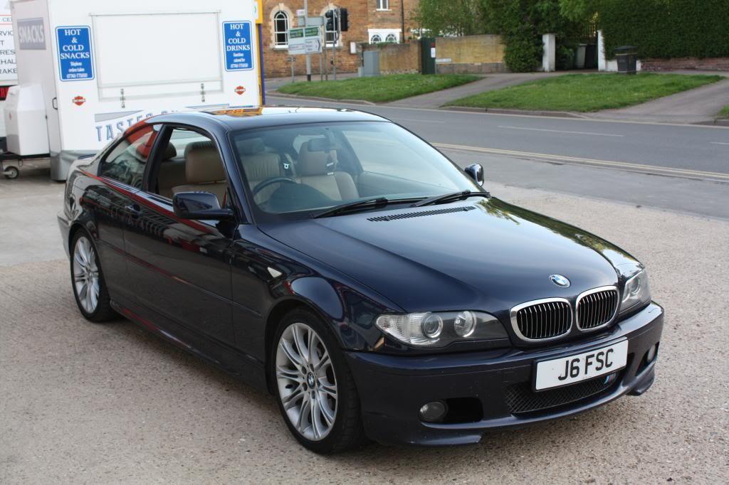

I think I remember your name from e46zone? You had a 320ci with engine problems or something?

yea thats me  :happy2: i replaced the engine in it, very impressed you remember
