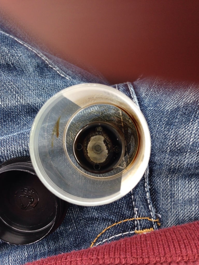

No mention of mine being done in the history so had it done when I bought the car. 93k in standard tune & this was mine

This one was at stage 5, no material left in the end of the follower.  Cam is like a 50p piece and the end of the pump is well munched.
It threw up the engine light with a code for low pressure over2 weeks ago and he just ignored it!!!

Changed mine a few weeks ago, I'm on 70k, no mention of it being done before but it was still in really good condition.  :smiley:
