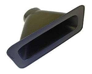

Yes RR squeezed these in (Merlin Motorsport) behind the grille and conected to Forge SHV2-63 V2 Ducting. Seem to work OK, I haven't  cracked another disc yet :happy2:

Yeh just put it through the liner and fixed it with cable ties, I have seen them strapped a lot closer to the disc, I think just getting some air circulating in the arch has got to help with cooling.  :happy2:

Sorry to the OP about the thread deviation but, Neil, how have you attached the Merlinsport vent 'trumpets' to the back of the OSIR vent slots?
can you get a pic of this in position in the grill with the ducting please. I like the idea of this, but maybe with a y  ytpe junction so i can get a hose onto air intake as well.

Sorry cant get a pic of it fixed in position, as RR knows the OSIR grilles are a bugger to fit and I ended up fixing mine on with mastic  :confused:
I had to cut the trumpet about a bit to get it in the opening and its not fixed to the grille just strapped in position directly behind the vent and a jubilee clip to the ducting.
Can you do away with the dust shield? Not sure how much protection it gives now as its smaller than the Brembo disc.
