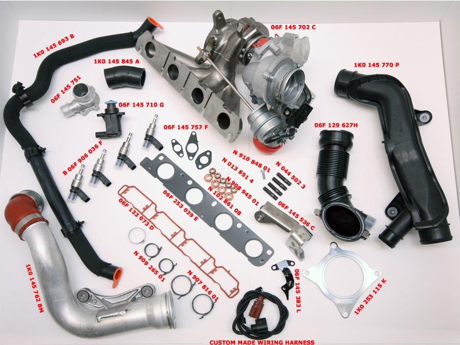

Hi, would a s3 turbo fit straight onto my mk5 gti 05 plate
Offline GarethB
  • Posts: 628
Re: S3 turbo
« Reply #1 on: June 22, 2014, 09:46:51 pm »
It'll fit, but will only work properly when connected up to the associated pipework, relocated DV, S3/RS4 injectors and a custom map  :happy2:

Offline Wooosh
  • -Receive: 87
  • Factory ponies.
Re: S3 turbo
« Reply #5 on: June 23, 2014, 01:35:58 pm »
The S3 & Edition 30 share the same KO4 turbo, which will fit straight on with the supporting mods as said KO4 conversion is a good investment. :happy2:

Offline Pikey Motorsports
  • Posts: 1793
Re: S3 turbo
« Reply #9 on: June 24, 2014, 02:55:45 am »
Pritty much all of this
Its a very straight forward conversion as all parts are oem! Really good upgrade from the k03
