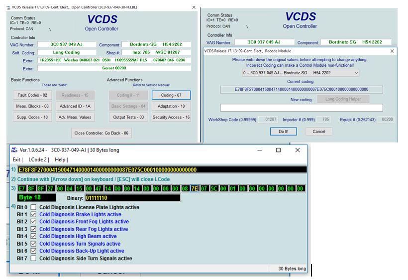

I am one of the unlucky ones with an Ed30 where the Check bulb light with genuine VW LED Mk6 lights occasionally comes on so I just disabled the bulb out in VCDS for the number plate lights. When is an LED going to fail anyway?

@Ripstop where in VCDS did you code it out?
Thanks

« Reply #40 on: March 10, 2017, 06:03:42 pm »
Let me pop out and have a look...
Central Electronics
Coding - 7
Long coding helper
Mine is Bit 0 on Byte 18 but yours might be different depending on features of the car.
Stage 1 2007 Black Eddy  #1000 - VCDS Hex+Can (Novice coder). H&R springs, newish Bilstein B4's. Gen 3 Steering rack, Helix organic.  The car is *always* work in progress fixing and upgrading things.

« Reply #41 on: March 11, 2017, 11:33:48 am »
Ah yeah I did that but no joy
Thanks for taking the time to have a look though @Ripstop
