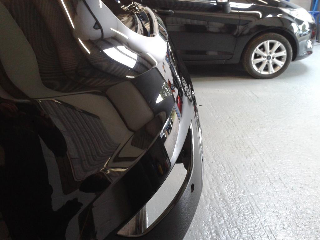

Hey guys
I've been trying to get the swirl marks out of my car. I've tried various products all of which have not worked very well.
I own a black standard gti
I use the following products to clean the car
-2 bucket method
-Lambs wool wash mitt
-meguires gold class shampoo and conditioner
Afterwards I have tried these  products ( after clay bar)
-farecla g3 scratch remover . This did absolutely nothing for even the smallest scratch but worked flawlessly with my wife corsa
-meguiares ultimate compound- again didn't do much but did notice a reduction when used with the super resin polish. With this I used the G3 scratch remover applicater
-autoglym super resin polish ( i do at least 3 passes)
- i use the meguiars sot foam pads when using the polish
-megs NXT wax to top it all off
After using the ultimate compound and then the super resin polish for the first time  the car did look beater against the sun but not sure if this was a combination of the 2 products  or just the filler effect of the polish.
I'm at a point where I find that working by hand is too long and does not give the the results I want  and I don't want to waste money on anymore compounds that potentially wont work by hand
Im thinking of using a machine polisher and Ive got my eyes on the kestral das 6
Now this is where Im getting confused. Im not to sure on what pads and brand to use and same with the compounds
Im tempted to try the meguiars ultimate compound as ive heards it has a similar cutting ability to the m105 compound and it maybe that the speed of a motor will correct things.
I've read jays guide to detailing and the menzerna/hexlogic looks appealing but again im not sure on what pad/compound combination to use
I am keen on using the autoglym super resin polish as last layer as i really like the shine it give. I would appreciate any advice about this
Ive attached a pic showing out the types of swirls on my car

By machine is really the only way to remove swirls.
By hand you are wasting your time, often using harsher compounds by hand you will actually inflict more damage than you remove.
You have to be careful what polishes you use if you are new to paint correction as you can easily do more harm than good
i have written a guide which i recommend you read to get you started it's stickied at the top of the detaling subsection.
the products don't really matter that much you just need to be aware of what's out there and more importantly how to use what products you actually decide to buy/use

First of all, correcting the hard VAG black paint will take a lot of time and patience. Also it is important to be familiar with the technique of machine polishing in theory before starting it in practice. I would recommend reading this guide: http://www.detailingworld.co.uk/forum/showthread.php?t=63859 as well as this http://www.detailingworld.co.uk/forum/images/misc/rotarypolishing.pdf
As for your car, the black VAG paint can be a pain to correct with a dual action machine. The DAS-6 basic model is not powerful enough for the job and even the more powerful DAS-6 Pro will struggle to correct your paint. Using normal common sense you can easily start off with a rotary machine (it's not as dangerous as the internet makes you believe it is). You need to be aware of leaving holograms into the paint and just take it a little bit easier with plastic body parts with a rotary machine. For your case I would probably get the Shinemate EP801 rotary polisher, a 3,5" M14 backing plate, Hex-logic pads in 5,5" and 4" sizes (at least orange, green, blue and black) and them Scholl Concepts S17+ and S30+ compounds. The Scholl compounds are lovely as they work much faster than the traditional Menzerna ones and they don't leave any dust behind.
I don't know about Meguiar's Ultimate Compound, but I wouldn't use the Farecla G3 for paint correction as there are so much better compounds available. AG super resin polish is just an all-in-one product that fill up and mask the swirls. It also doesn't last very long at all, and the swirls come back in sight after just a few washes.
