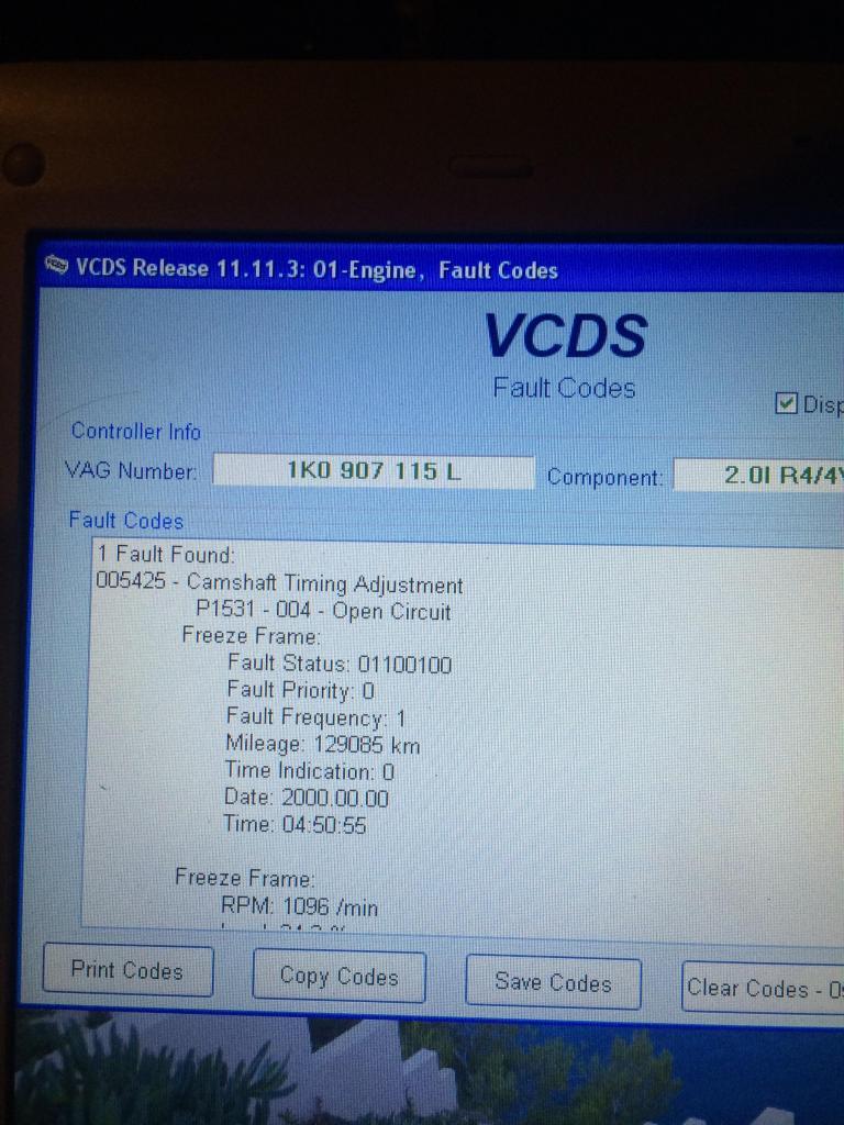

Ok alex cheers.. I just plugged it into vagcom and got a camshaft timing adjustment fault
and then found this
Also found a fault for leak in air intake system

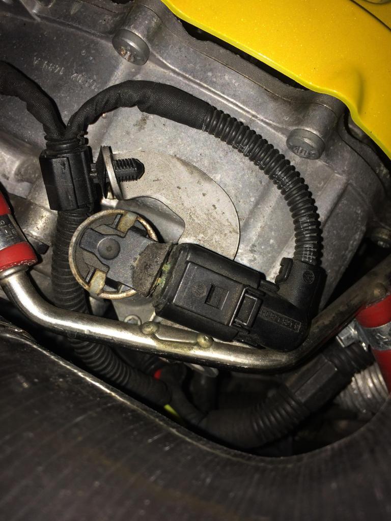

Its the n205 sensor right alex? How do i remove it dude

That's been broken and glued up before. It just has two screws. T-15 or T-20.  Have a rag as some oil will come out if it. Around £100 iirc.

I thought it looked like it had been glued.. Hopefully will fix the problem but not sure as also has the leak in air intake fault.. Either way it needs replacing and im sure its not helping the prob
