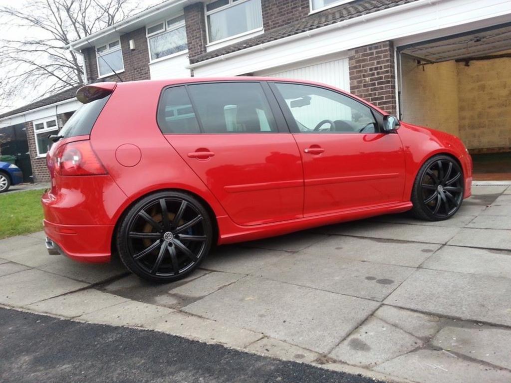

These are the 19" kahns I have on it at the moment, just a little confused about which size 3sdms to order  :confused:

« Reply #5 on: February 11, 2015, 04:20:30 pm »
If you want it to sit the same as on the kahns then get 19's if you want to go lower then it's easier on 18's

« Reply #6 on: February 11, 2015, 05:29:33 pm »
I'm quite happy with the way it sits so I do want 19s but I'm unsure about what other info I need ie offset etc. Basically I want them the same as the kahns, would it have the size info somewhere on the wheels I've got?

« Reply #7 on: February 11, 2015, 05:32:06 pm »
It should be stamped on the back of the spokes somewhere.
