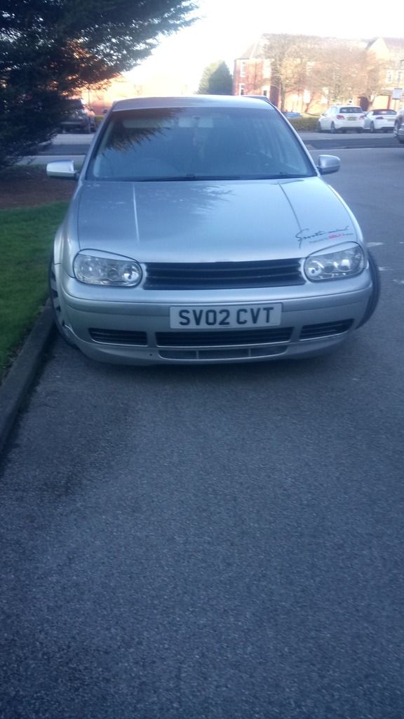

scott :happy2: sorry newbie didn't no how to send u these pics
[/URL  :driver: she still alive n going strong got told its been mapped but no Prof just wondering if you had put map on cheers

Hey Hey now thats a quality car right there!!!!!!
still looks great...
i never got it mapped
