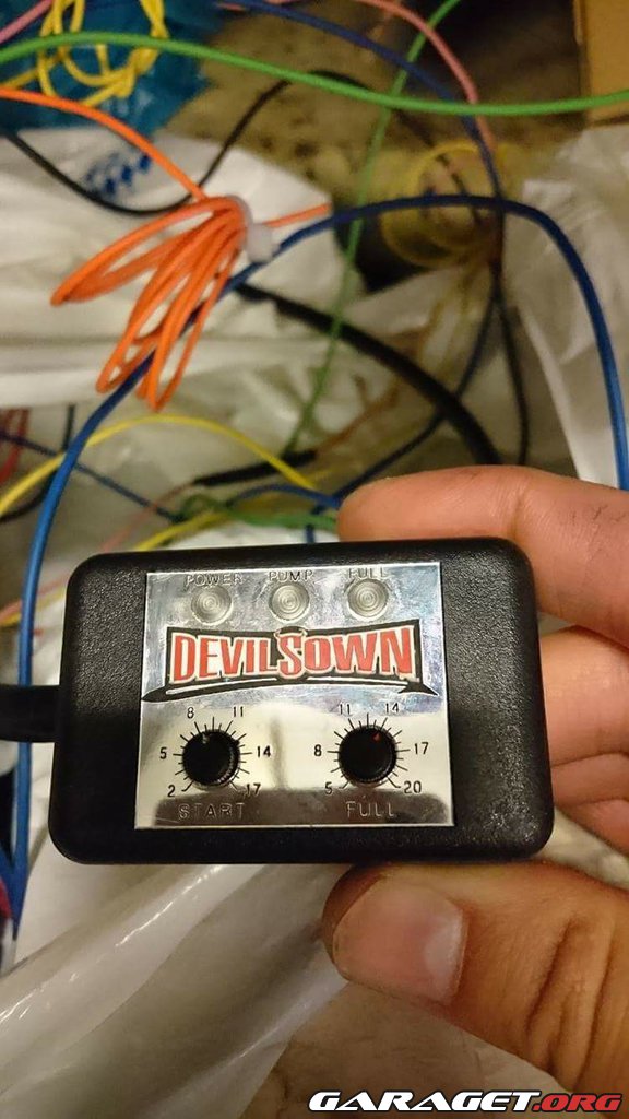

Today I wited in my do w/m controller and when I switched it on I saw smoke right away... :thinking:
I have connected everything as described;
Black - ground (through a on/off switch)
Blue - pump minus
Yellow - w/m level sensor
Pink - ignition
Orange - battery 12V +
Green - map sensor
When I was switching it on i had forgot the plug in the map sensor connector but it shouldent be like this anyway?! The key wasen't even in the ignition!!
Pump is working whwn grounding the black wire and has a 10A fuse to battery.
Ignition is taken behind fusebox side of dashboard.
Green to lilac/green pin 14 on the connector front of the battery near the coolant hose.
So my controller is now cooked... :sad1:
What have i done wrong?
My controller is the 2.5 bar version...
Please help!!

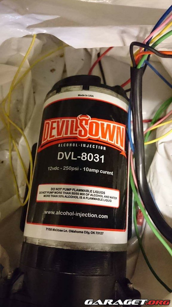

I bought the pump and controller from a friend who had them on his cupra...
Pump says DVL-8031
I followed dvc30 install.... :scared:

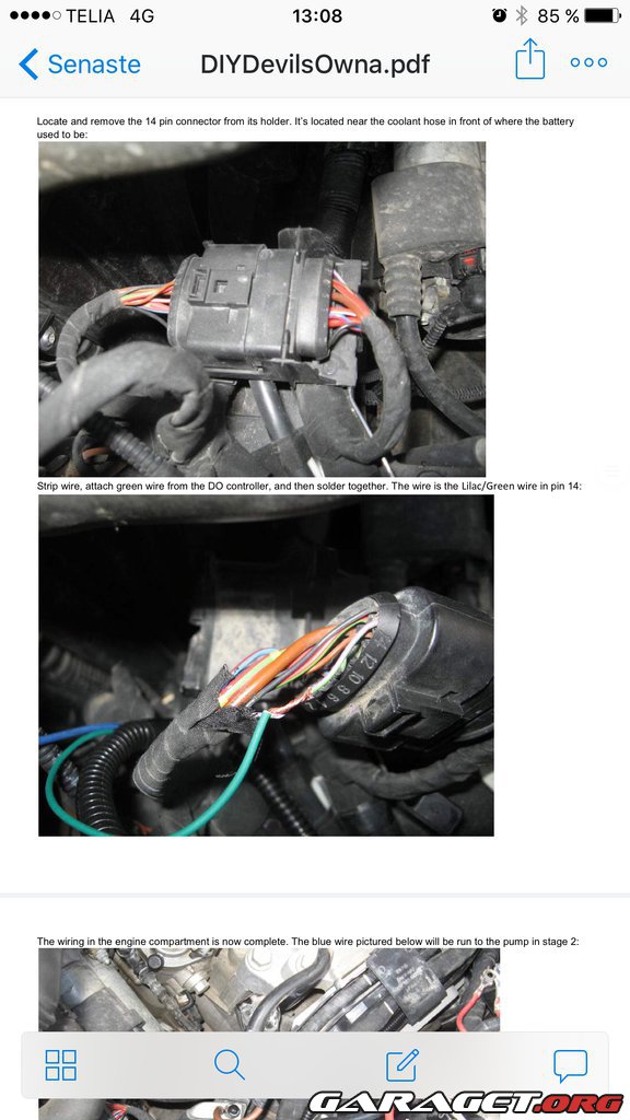

Here is were the green wire is connected...
Offline Dan_FR
  • -Given: 132
  • -Receive: 189
  • Posts: 1845
  • wait...what?
Re: Devils own w/m problem...
« Reply #10 on: April 18, 2016, 12:31:07 pm »
Where did those instructions come from? Did you not check it with a multimeter?
If you have 100% wired it up correctly then the controller must be faulty - nothing else it could be
Offline Softishman
  • Posts: 273
« Reply #11 on: April 18, 2016, 12:38:38 pm »

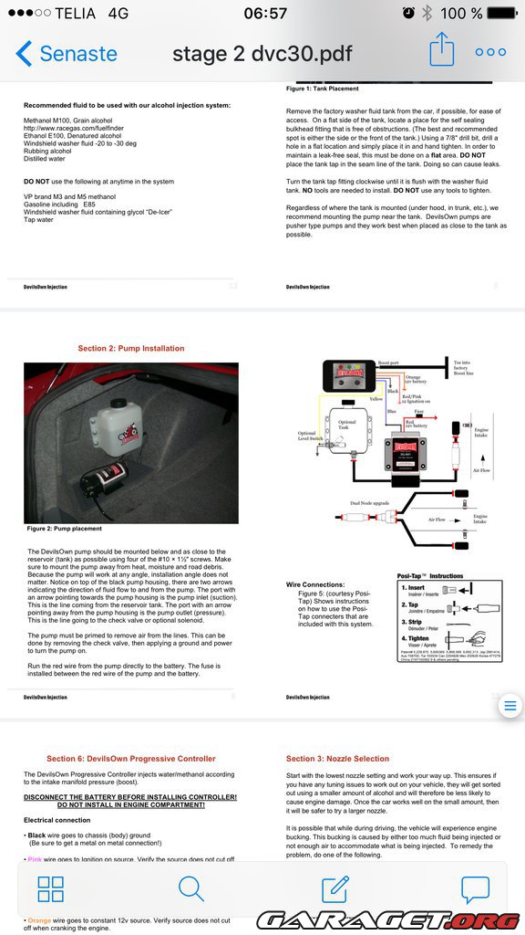

https://www.dropbox.com/s/9kbghk4re3574ju/DIYDevilsOwna.pdf?dl=0
Here is the instructions that i had.... Have to check with a proper multimeter again then... :sad1:

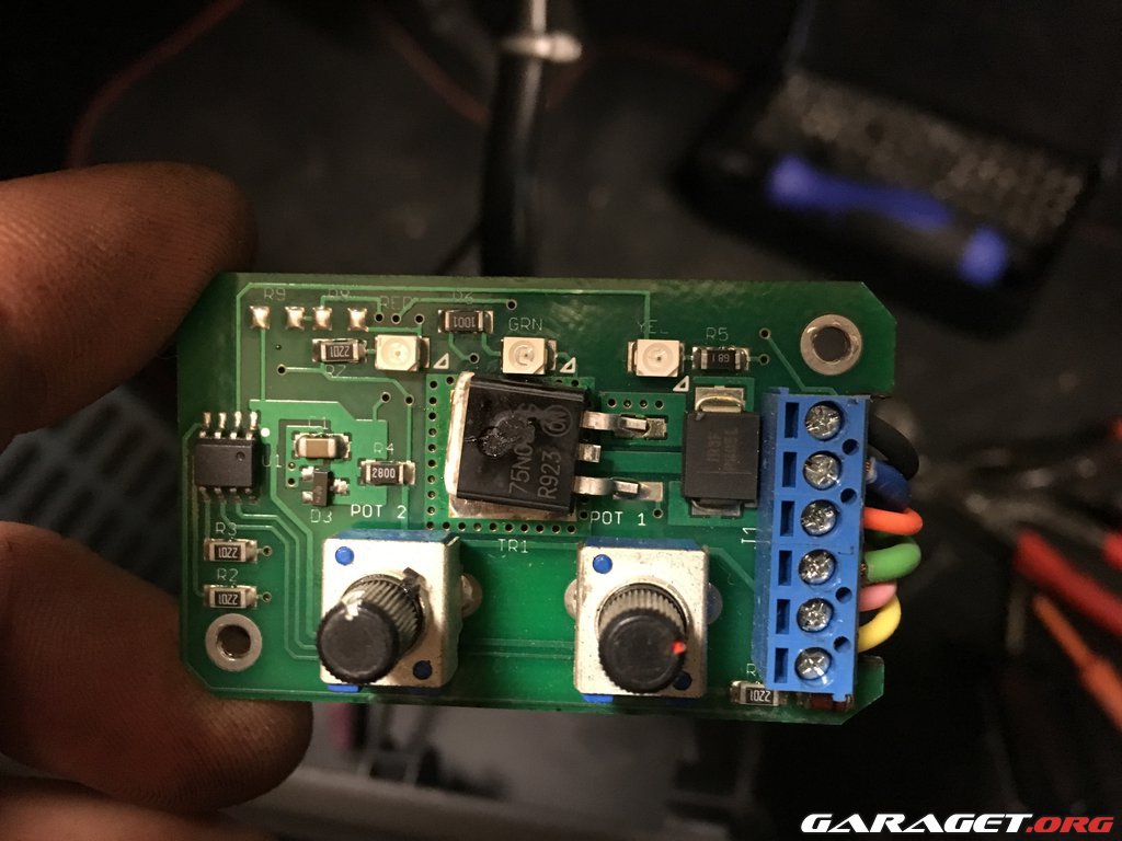

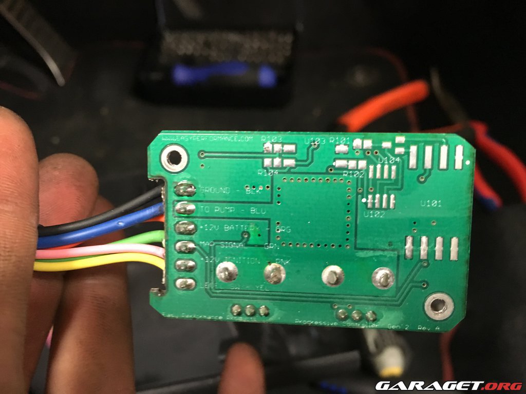

I have now tripple checked every wire and it all looks good. I measured on tje green wire while driving up to near 5V.... I must be the controller itself that are faulty... Is it worth 200$ for a new one or just order the pressure switch?
Offline Softishman
  • Posts: 273
« Reply #13 on: April 29, 2016, 05:12:07 am »
Just to share some info. It is the mosfet transistor on the board that are faulty and the reason was the connection terminals that was broken...
Hoping to just get a new trasistor and it should be ok again!
