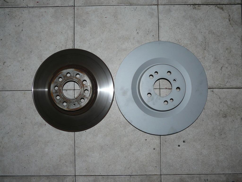

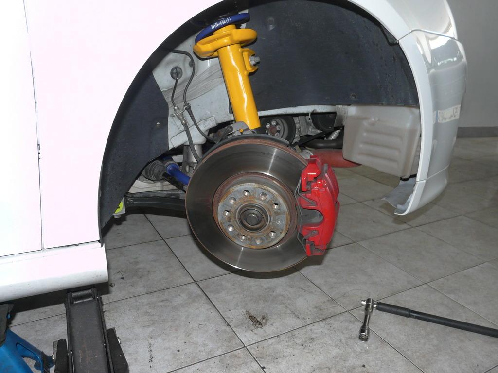

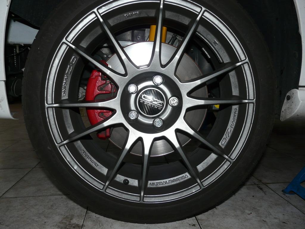

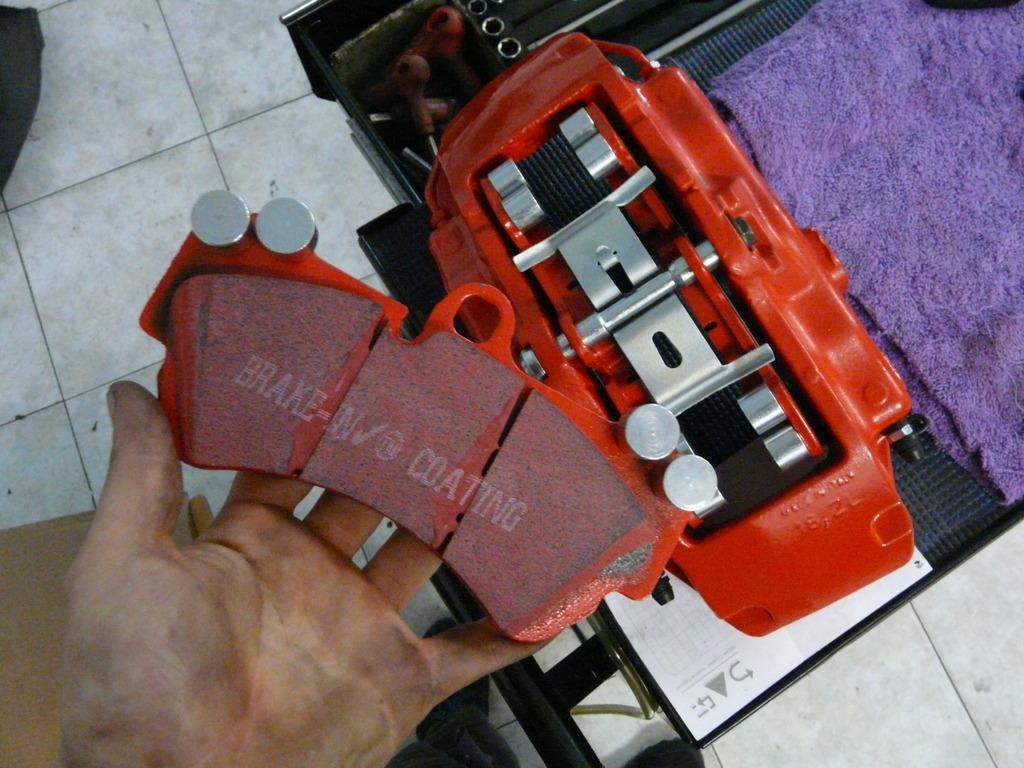

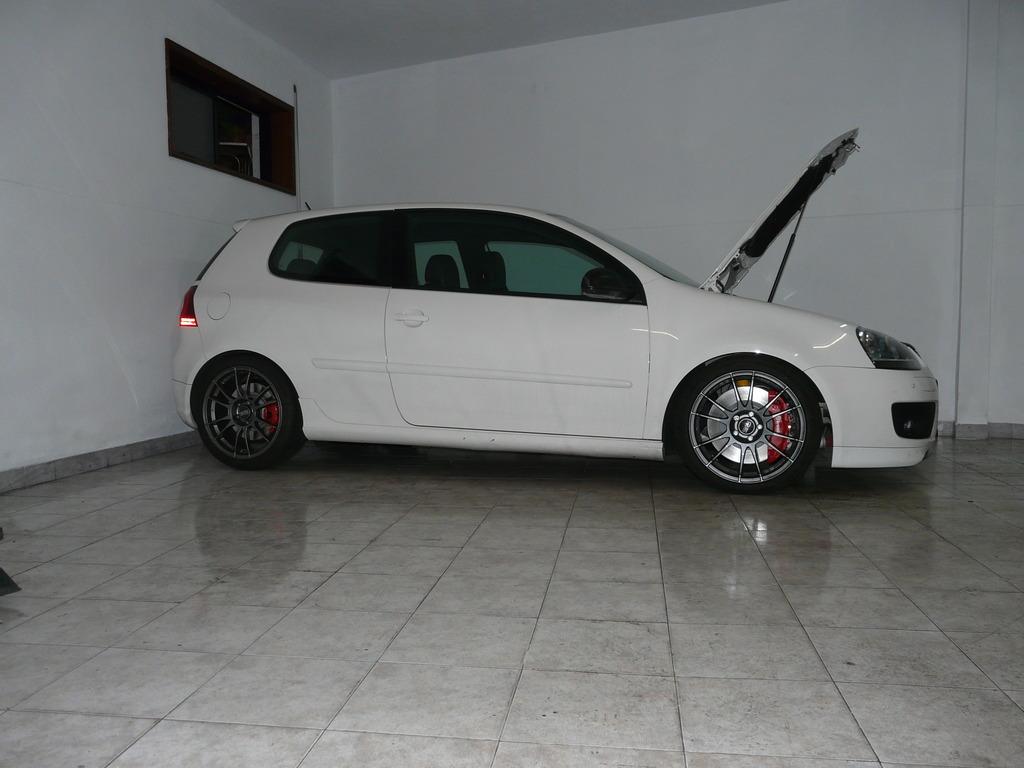

Got the pictures from the front BBK fitting process! :pomppomp:
OEM brakes:
OEM discs (312 mm) vs MB GL450 discs (350 mm):
Brembo 18Z calipers with EBC Redstuff pads for Brembo 17Z:

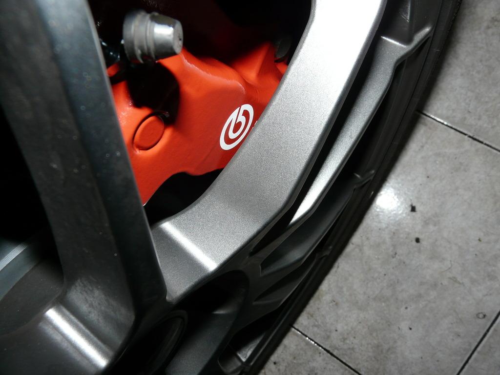

Brembo calipers fitted with centering rings for the discs and bolt spacers for the calipers:
1,4 mm of space between caliper and wheel:

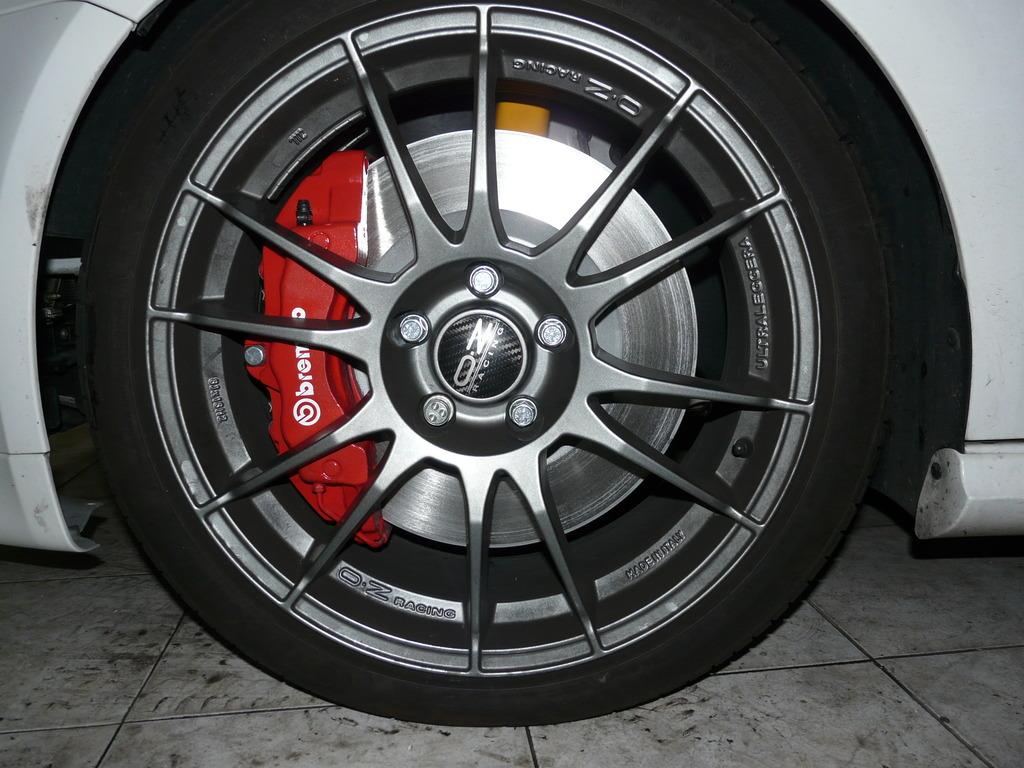

How they look fitted:
New front and rear brake setup fitted:
OEM vs Brembo 18Z:
My mechanic then went to do a full wheel alignment. He said the ride quality is better with the new dampers and springs. He still hasn't had time to bed in the brakes properly. At the moment the acceleration suffered from the weight of the new brake discs, as expected.

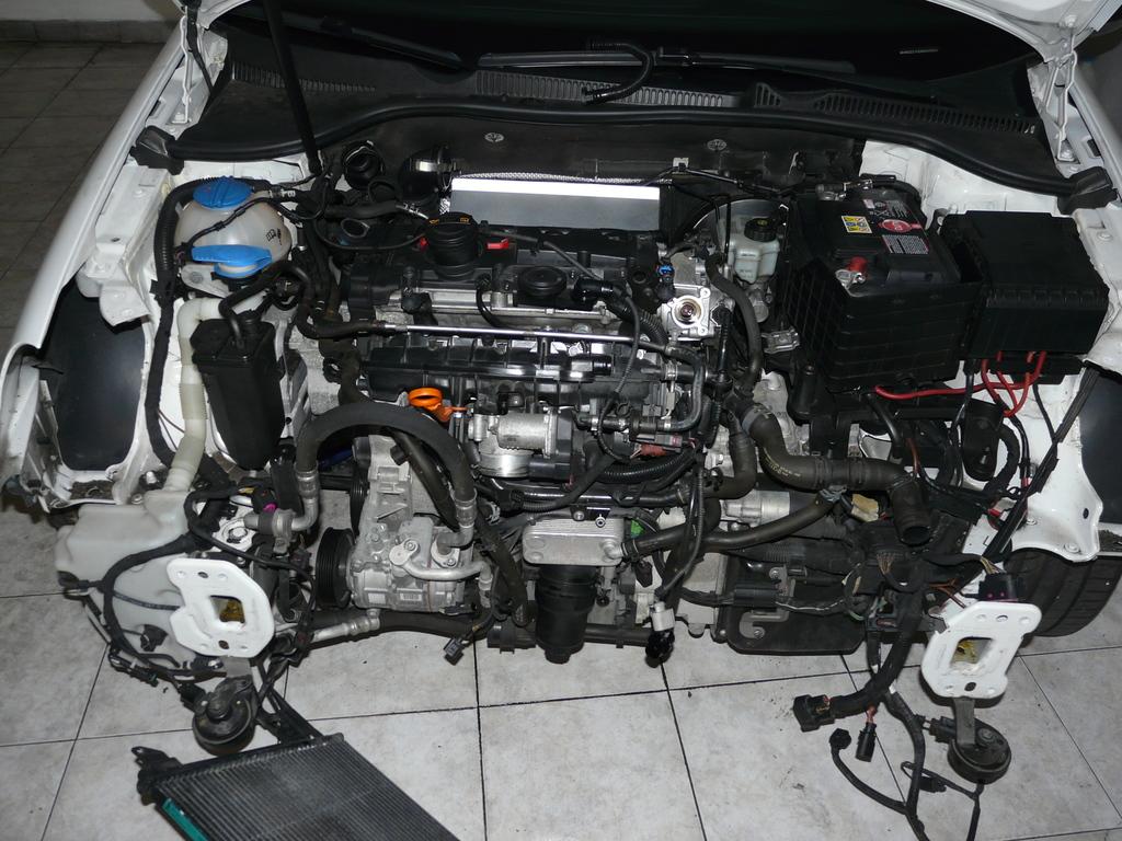

Small update of the work in progress. :smiley:
Front end off to fit the new engine upgrades:
Currently fitting:
  • Darkside Developments S3 uprated IC with alloy end tanks and silicone boost hoses

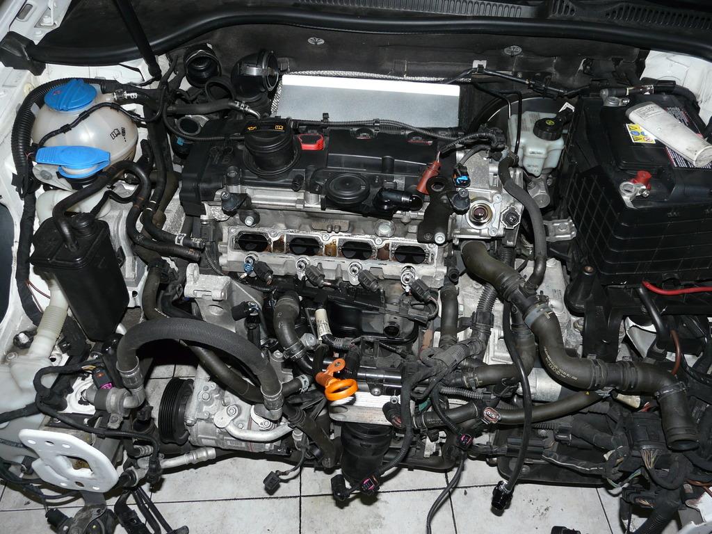

Intake manifold off:
Quite a lot of carbon build for just 35.400 miles. :confused:
Maybe due to the engine running cold due to the malfunctioning DSG thermostat? :confused:
Well, it was all cleaned and the RFD kit installed.
My mechanic while updating me the developments questioned the advantage of removing the manifold flow dividers, since their purpose is to channel the air and reduce air turbulence. After considering that I'm not going to max out my K04, we've come to the agreement of leaving them fitted. The RFD kit will prevent future problems with breaking runner flaps and that's enough for me at the moment.

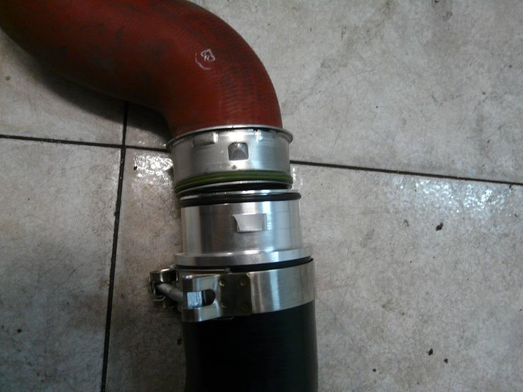

While fitting the Darkside Developments IC hoses a problem occurred. The coupler for the turbo outlet pipe didn't fit. The OEM coupler fit perfectly both OEM and CTS Turbo outlet pipe but the DsD's coupler clip was too wide:
Searched online and found that others from the Seat Leon Cupra forum had the same problem before too. Eventually they found that Creations Motorsport sold one just perfect for the job: http://www.ebay.co.uk/itm/171266960379. It's the Type “E”: 64mm clip side outside diameter (o.d) male coupling, suitable for a 63mm internal diameter (i.d) hose.
Big thanks for those guys for sharing the solution. The coupler arrived yesterday and was a perfect fit as expected. :pomppomp:
Talked with DsD complaining about the fitting issue and they've agreed to make a refund after I return the defective coupler. Not sure how much they will refund me, but I've asked for the 30 £ I had to pay for the Creations Motorsport coupler.
