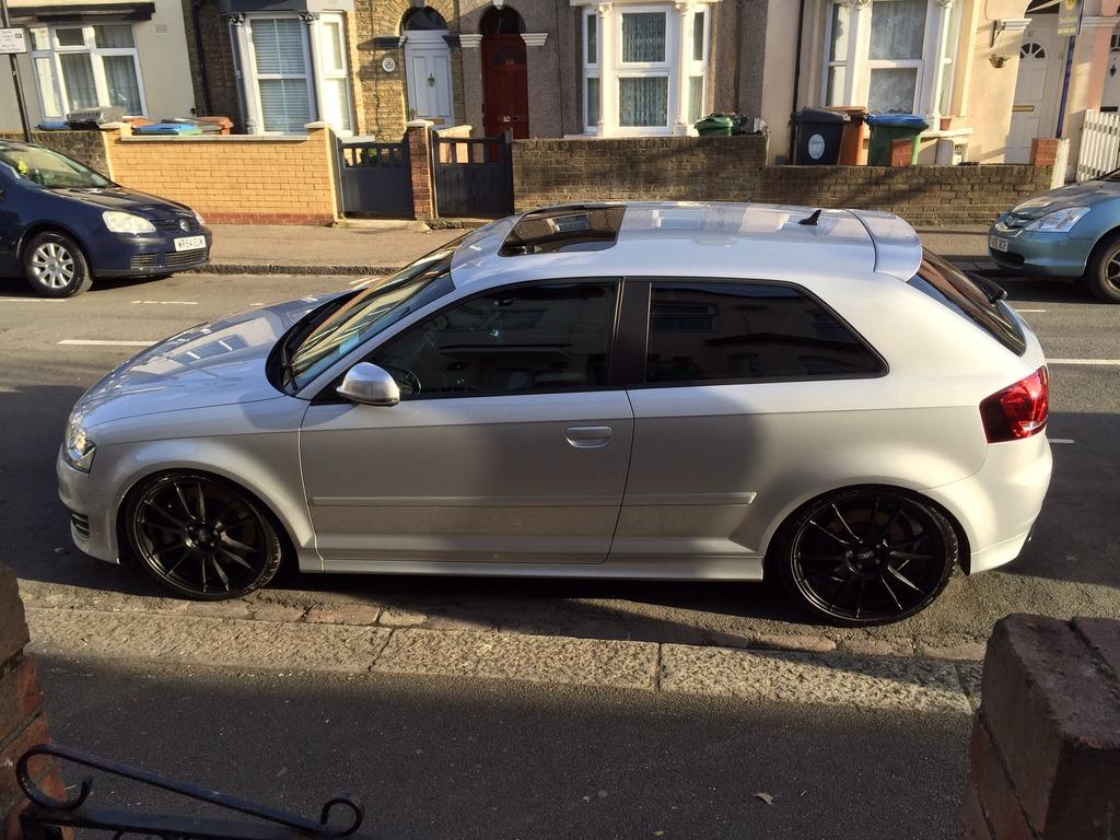

BBS CH in 19s for the golf will be in 2 sizes for genuine wheels.
CH026 19x8 ET50
CH009 19x8.5 ET35
In my opinion the 026 are the ones to go for. 8.5 width with ET35 will give you potential rubbing issues when lowered. Also I don't like the look when the wheels are so far out.
Ive got the CH026 and with 225/35/19 tyres mine is fine.
Check my build thread for more pics.

« Reply #6 on: May 01, 2015, 09:56:38 pm »
That's looks spot on Jedi  :congrats:
Although different wheels I chose 8s over 8.5s on mine for the same reason and very glad I did
