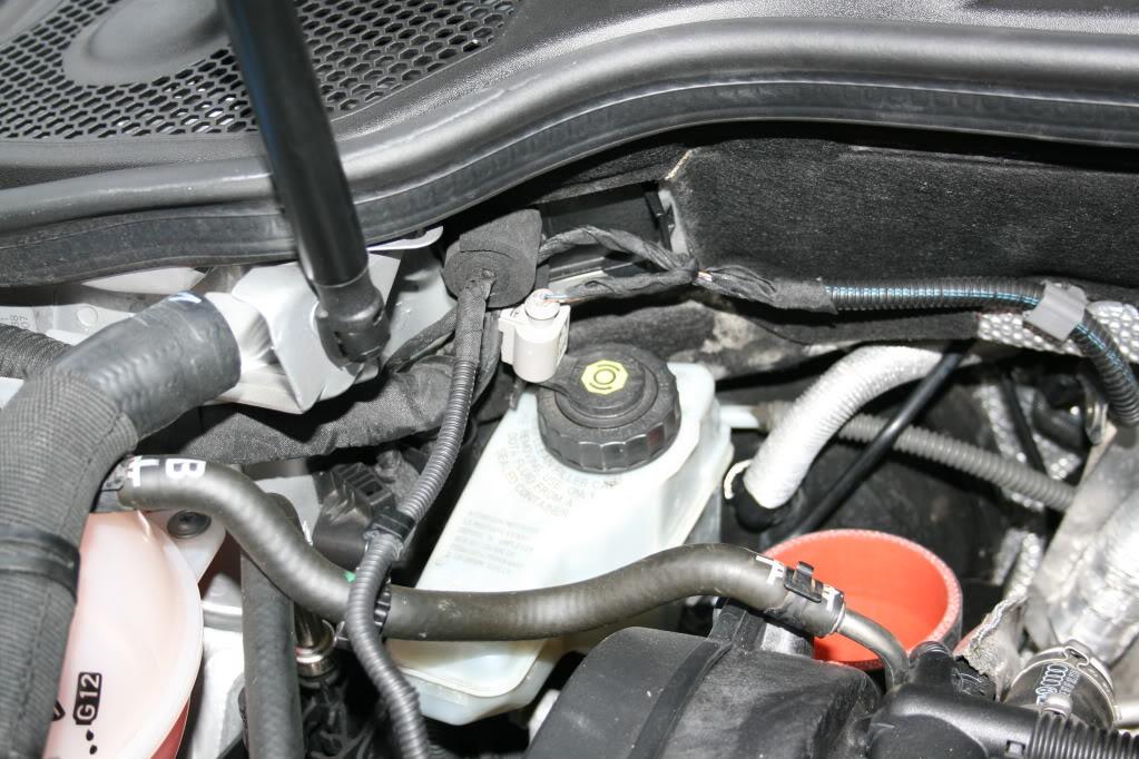

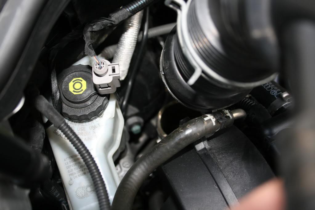

In the S3 space is very tight so first of all I had to move the sensor plug on the brake  reservoir to the opposite side  This can be done by loosening the cap onto top of the reservoir and then spinning the sensor round to the left hand and then re tightening (note you may need to pull the intake tubing out to do this):
Before
After
Depending on how close to your break reservoir the port is you may need to cut away some of hose on the 38mm end of the silicone reducer.   I needed to trim roughly 1 inch off it.

Great instructions but word or warning, watch out with the reducer on the break reservoir as it could chafe under load with the engine moving. I found out the hard way and it lasted no time at all (all be it with the supplied rubber bung for the K03).

It was mainly and it warped significantly due to it, but when I removed the kit there were signs of it all over the reservoir . Just an observation.
