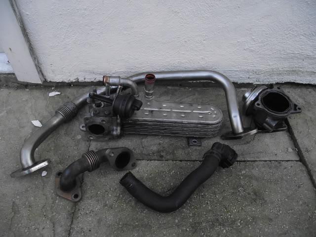

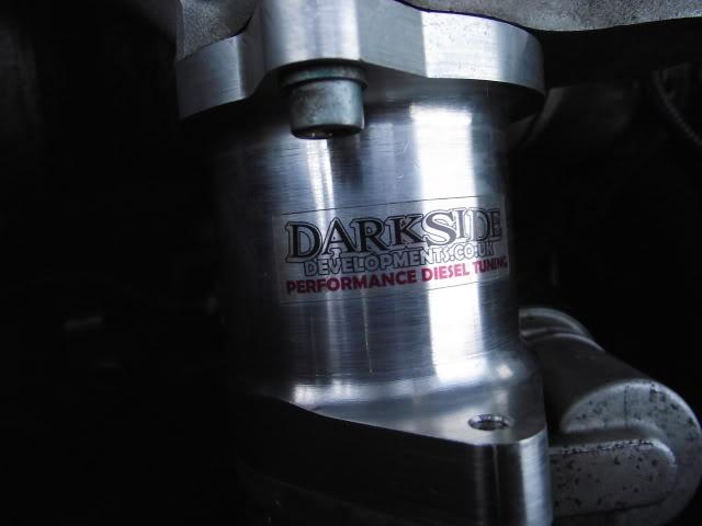

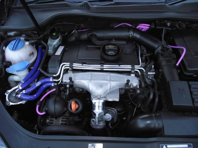

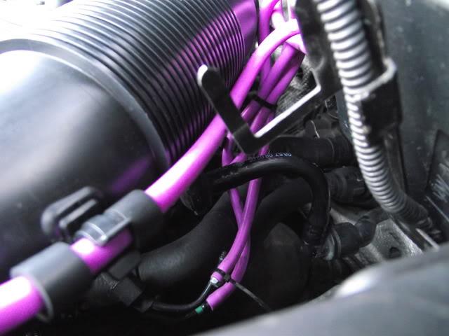

Couple of pics for you guys who are interested.
The new re-designed EGR delete from Darkside Development:
The next pic is where the cooler was and now just a diverted coolant pipe from the bulkhead to the pipe where the coolant temp sensor is.
And whats been taken out you may ask, well all this, proper loads of space and it was proper easy to take out.
Hope its to your liking tdi lovers next up is the cylinder head swap and then race injectors.....
Darren :happy2:

Jake the downside of NOT taking it off is a clogged up manifold, Intercooler and turbo, the benefits so out way the downsides but it does spool up better and feels much smoother on idle...
GTSport yes thats all the parts of the EGR system and its all going in the bin :grin: :happy2:  :fighting:
Darren
