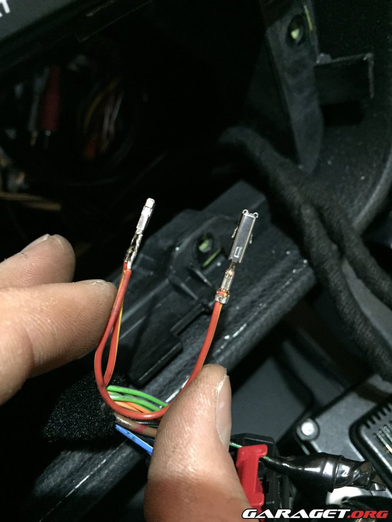

« Reply #11 on: July 06, 2015, 11:22:32 am »
Or getting a loom fron a golf mk6 where the pins are correct size and colour on the cables...
Did this to be able to switch back to mk5 clima easy!
The left connector is mk5 and right mk6.
« Last Edit: July 06, 2015, 11:28:53 am by Softishman »

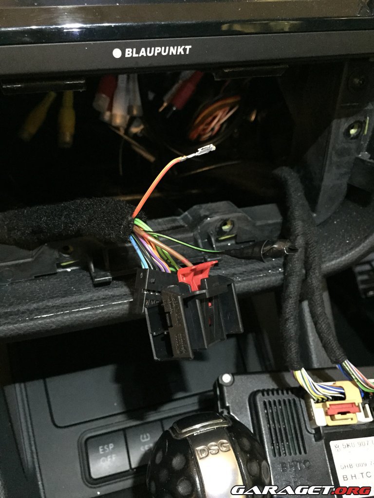

Offline Softishman
  • Posts: 273
Re: Mk6 climatronic in golf mk5 gti
« Reply #12 on: July 06, 2015, 11:27:34 am »
Here is the cable you don'r re cinnect, black/green

Offline Softishman
  • Posts: 273
« Reply #14 on: July 06, 2015, 10:47:00 pm »
When i bought my mk6 clima panel i got the loom from tha car (mk6) aswell, i took the cable with rightcolour and right type oc vonnector and soldered it the my mk5 loom as pictured! Now it is really easy ti switch back again if tou want to!
