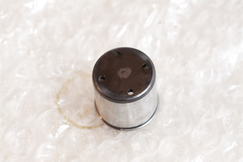

The follower when i purchased the car  :sick:

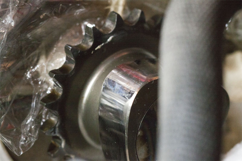

Cam Lobe.
Cam lobe after a bit of a polish
New follower at 2000 km
The follower at 5000km/1 year
Is there anything that would cause the noise to be louder? Faulty hpfp pump/spring or cam lobe??
In the last service i changed the oil pickup pipe and switched to millers nano drive so i'm hoping next service the follower looks better.

The pump drive lobe doesn't look too clever tbh, which could be eating the coating off your followers.
After 8,000 miles with a Loba pump, there was no wear at all on the coating when I checked it.  I only mention Loba as it's stiffer spring puts more pressure on the follower / drive lobe.
The lobe is on my todo list. I recently listened to a 2008 gti with 80,000 km it was way quieter than mine. I keep homing in on a noise from the HPFP area. (not the chain diesel noise)
