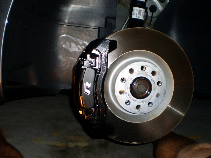

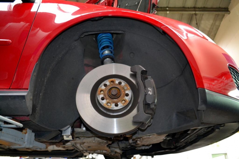

Scirocco R brakes, same specification to the R32 / Cupra / Golf R setup with black paint.
345mm discs.
Single Piston design.

Much better than Standard but...
by Scottymon, on 2014-10-21 21:35:02
Noticeable stopping grunt over the standard calipers, but also heavier, something you can feel over standard. If unsprung weight is an issue looks at the NQSBBK, or a proper BBK.
A great first BBK
by th3_f15t, on 2014-10-23 18:25:21
For many people, a simple re-map with a few other additional modifications are enough in terms of power increases. To compliment this, bigger brakes should always be considered, and this OEM upgrade has many advantages; 1. Bigger friction area resulting in better stopping power 2. OEM parts means plenty of spares available and kits are very cheap (second hand) 3. Relatively easy to swap over, just bolt them in place of the stock GTI parts Only real downside is weight, they aren't what you'd call light! A way to overcome this is to use 340mm TTS discs which save 2kg per wheel. Above all else, this kit should be considered the most essential mod to compliment a power increase.
