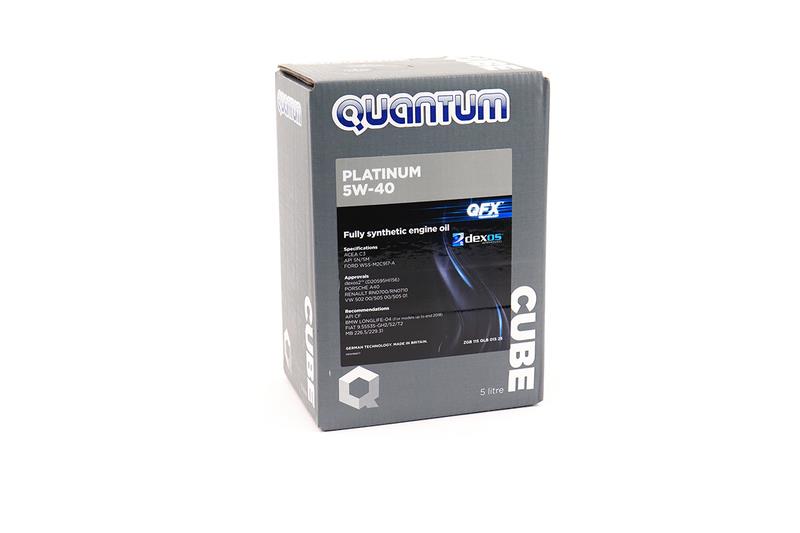

hi, i'm not too sure if using 504 is the best, maybe someone else can comment on that. but currently i use 5w40 quantum platinum which meets 502/505 spec. a lot of reputable garages and tuning companies recommend it.
i switched from castrol edge 5w30 to this and noticed less consumption.
