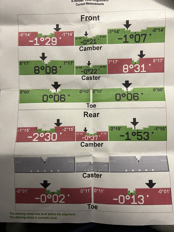

Needing my alignment done. Is there anything i should be noticing when driving the car with the alignment the way it is ?  I have bilstein b8 dampers, kw springs and a powerflex anti lift kit fitted. Is there anything i would benefit from fitting before getting the alignment adjusted or even different settings. The car just gets used on the road. Many thanks

From the readings you have added, assuming the powerflex anti lift kit is still good, it looks like either Left top mount has sagged or front control arm bush is on the way out - if it is loose you may be finding vague steering and tramlining.
Rear left look suspect for failed bushes - for OEM bushes the quickest option is replace entire arms.
