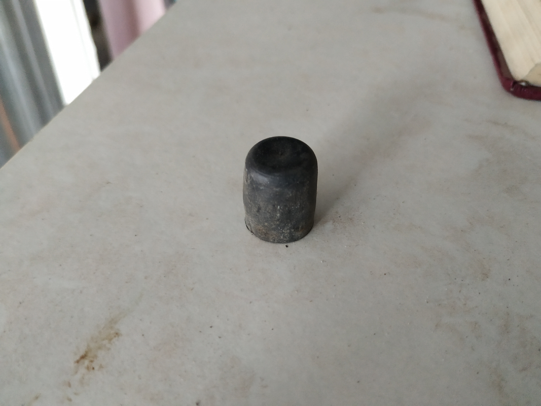

All done just need an alignment and a couple of new tires.
I found this cap on the floor and cant remember where its from?  :scared: :rolleye:

« Reply #26 on: July 15, 2021, 11:20:39 am »
Nice one, congrats
Don't remember seeing one of those. Having said that, the caps on my axle stand release handles look like that. Worth checking your tools maybe
