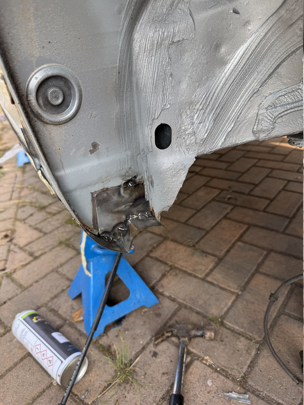

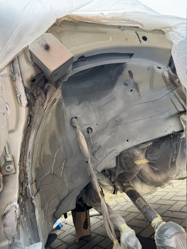

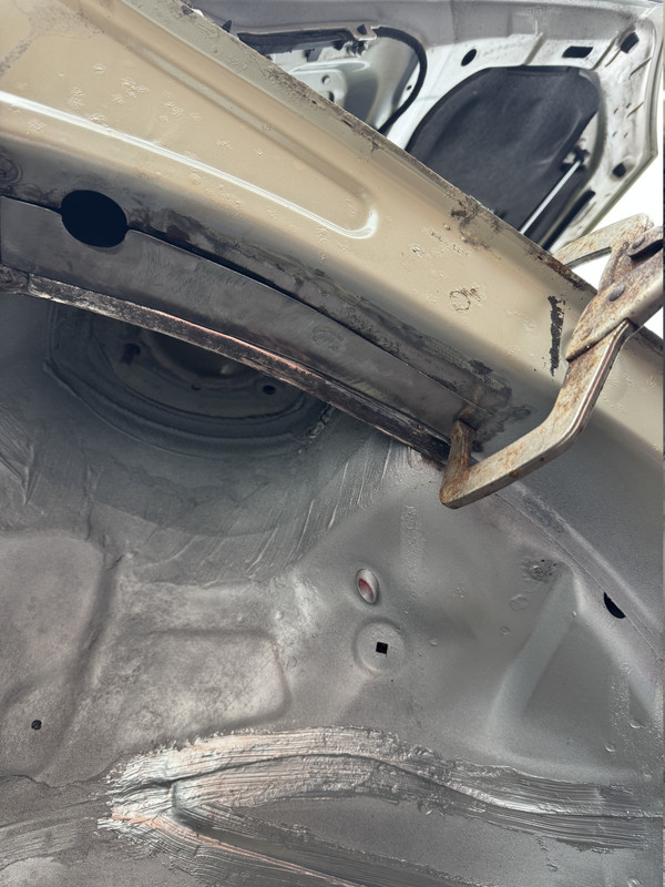

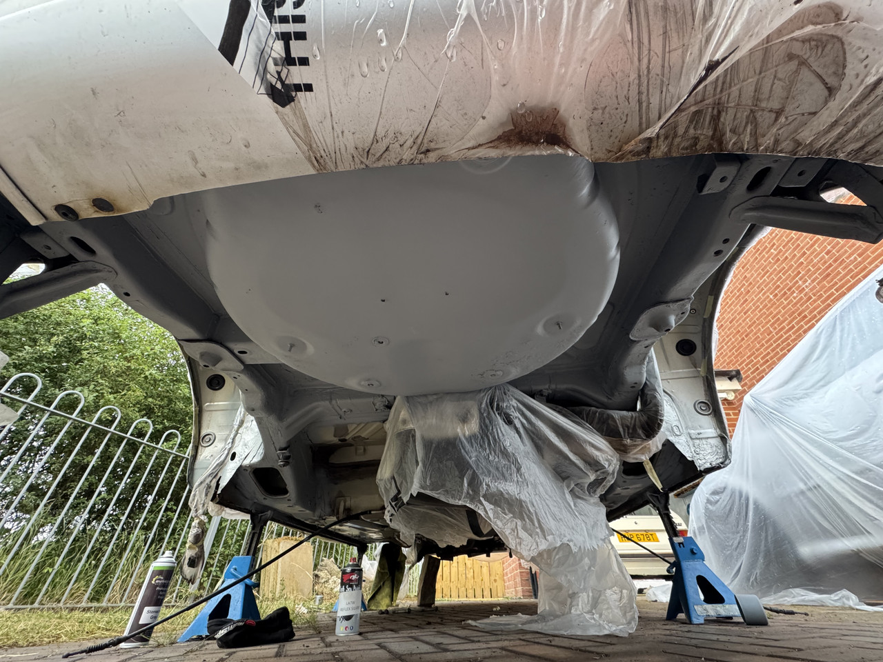

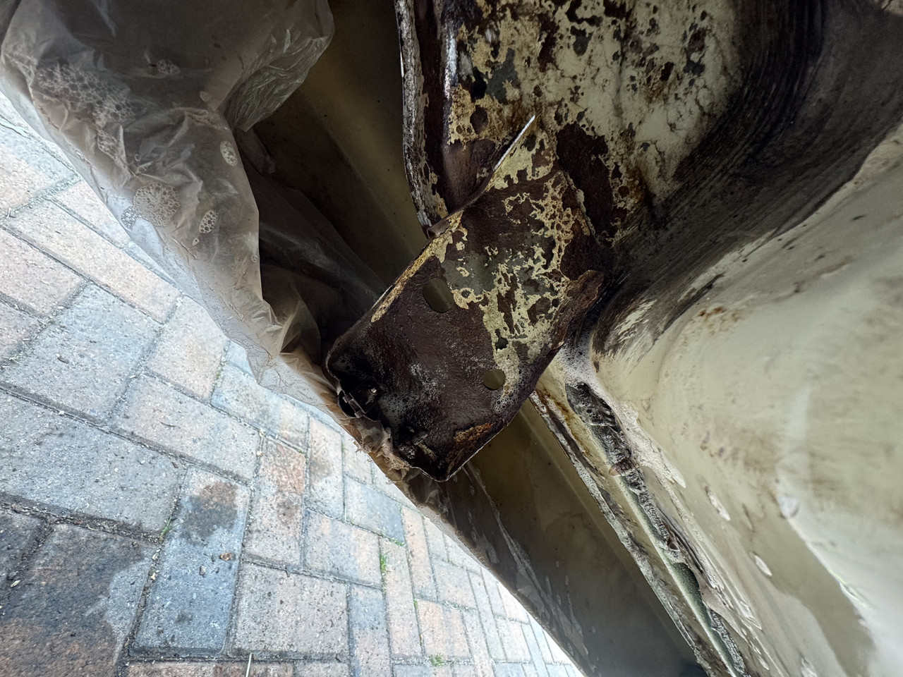

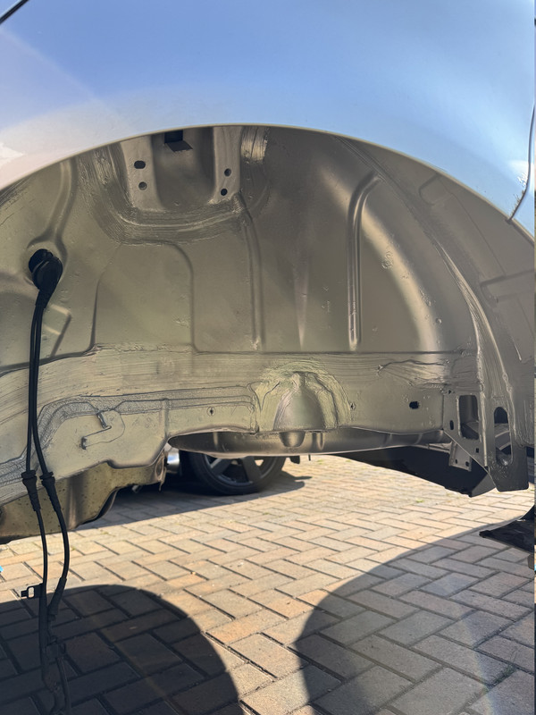

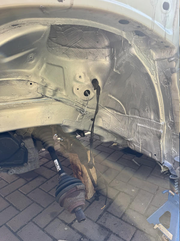

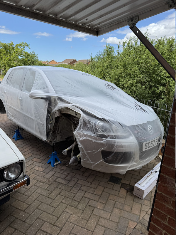

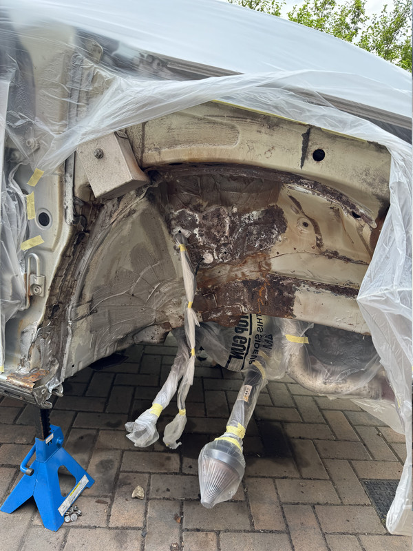

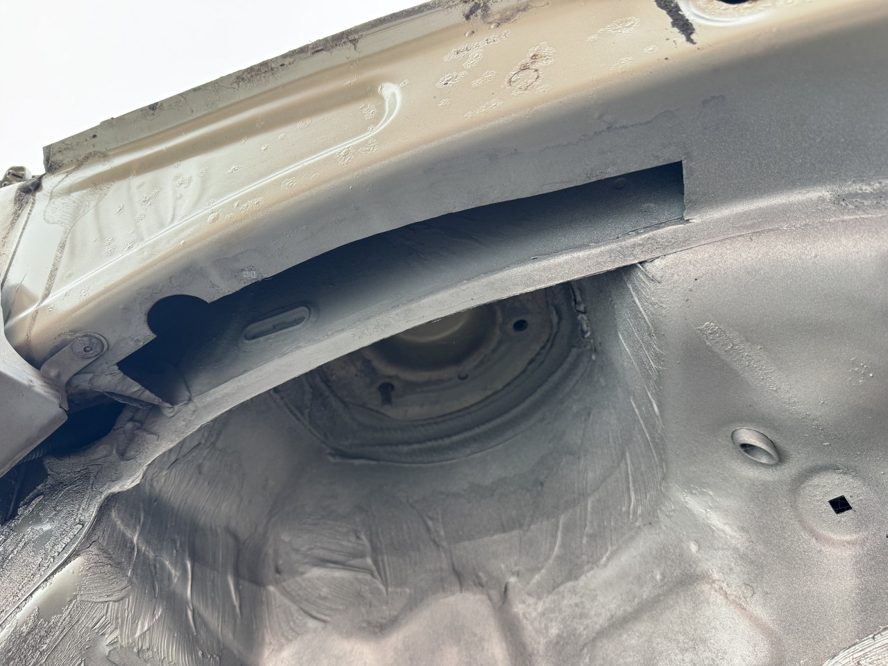

So, been finding the time to get on with bits between work and other things but I feel this is going into full restoration now haha…..I need to keep myself from stripping the entire thing 😂
Everything has been cleaned and wire wheeled/flap disc’d then applied with the De-Ox gel and covered with clingfilm to keep it working over the next 24 hours.

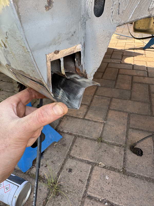

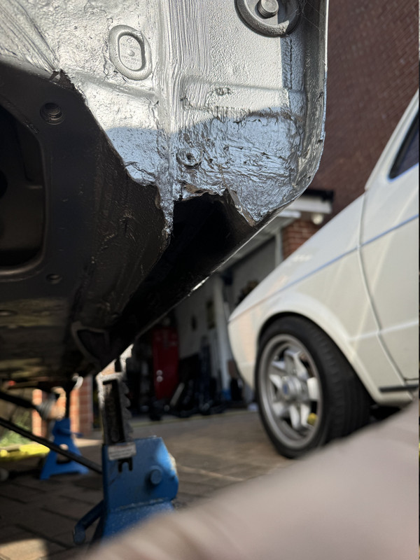

I’ve also checked the rust “hole” - yeah it was worse than I thought but still not the worst I’ve seen, I’ve also discovered another in the drivers side front, weirdly at the top rather than the bottom corners…….but I should be able to tackle these myself as I’ve done a bit of this type of stuff before.

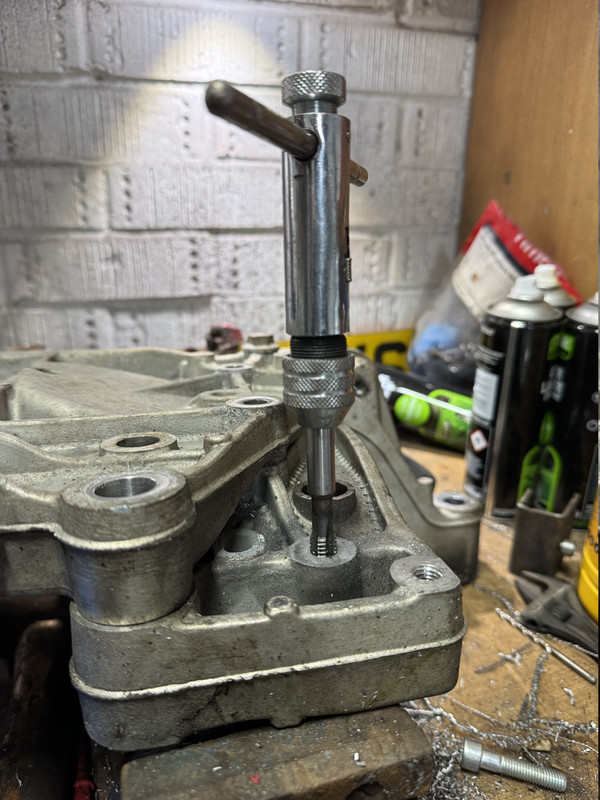

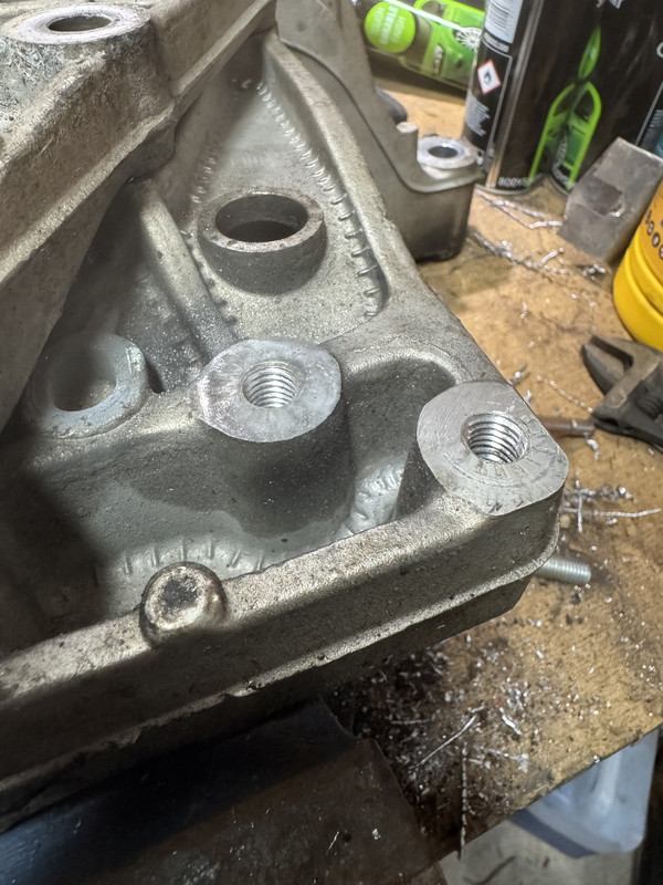

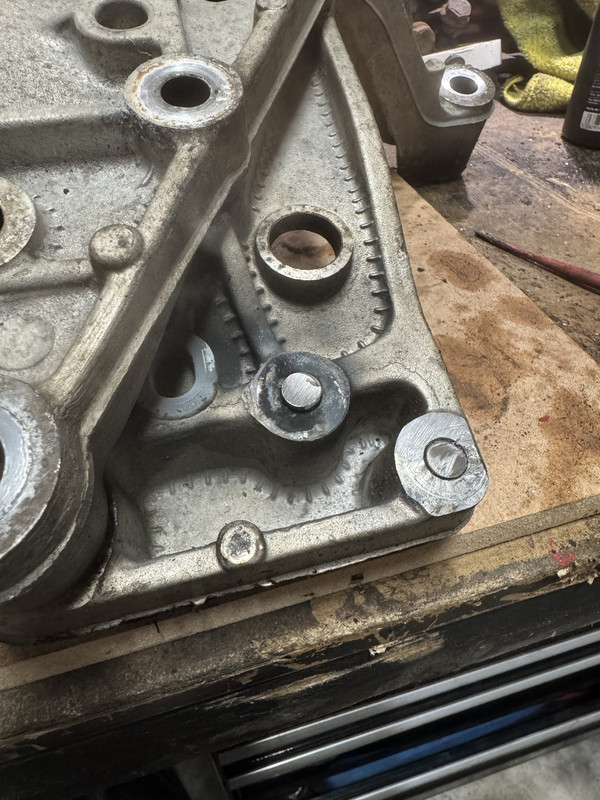

Also had to drill out and re-tap the subframe bolts that snapped….they were absolutely SOLID 😂

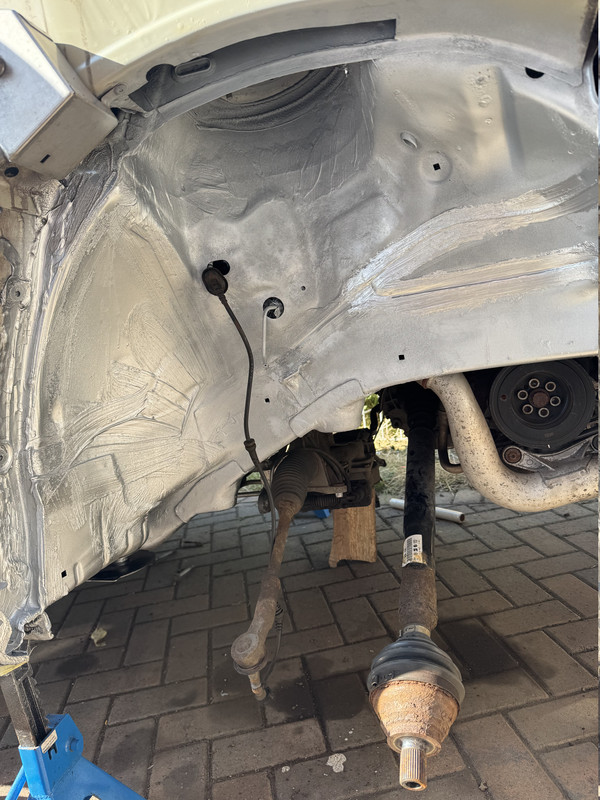

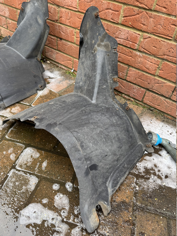

Finally, whilst I’ve been waiting for some more bits to turn up I decided to clean up all the wheel arch liners/plastics, I can fully vouch for this CarPro Perl - absolutely transforms plastics

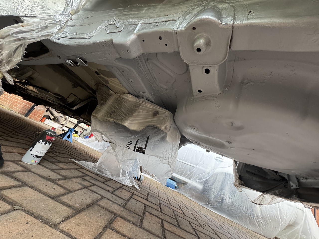

Car is now all masked up and ready for some seam sealer/primer/stonechip/paint - all the stuff is done at the powder coating place so just need to go pick that up, however I’m leaving it there until the car is ready for it because I’m running out of space 😂
Hopefully next post should be it welded up and painted!

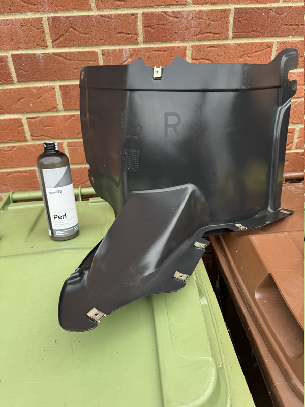

Looks like I definitely  need to take off the sill covers, did you have any problem getting them off ?
Well impressed with that carpro pearl never seen that before. :happy2:

The sill covers are on quite tight with the adhesive, you can cut it with a Stanley knife - but other than that it is just 2 torx screws under the sill then they slot into the guide rail that is on the sill, just lift them up and off
Aye a was well impressed with the plastics stuff, amazing

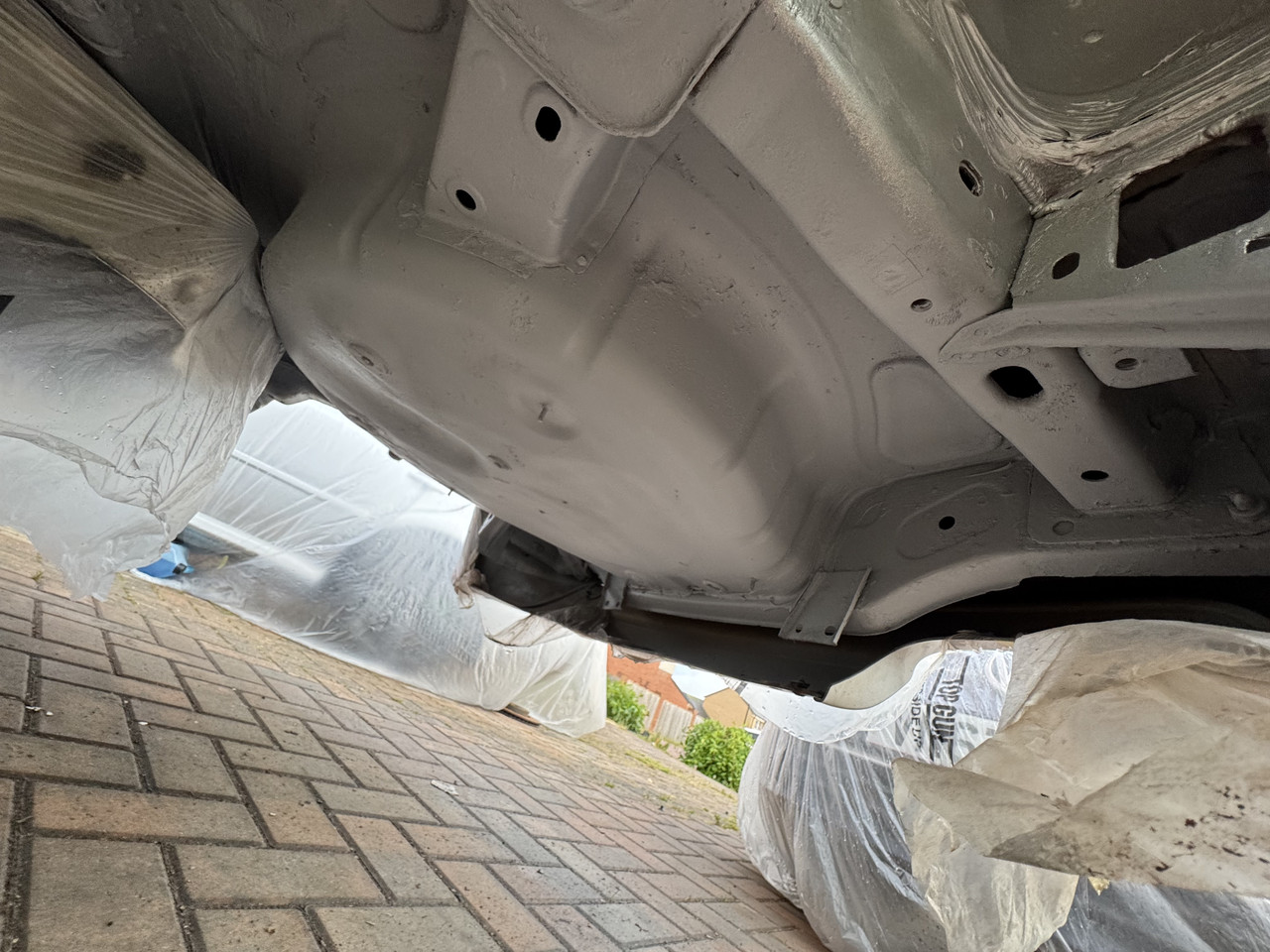

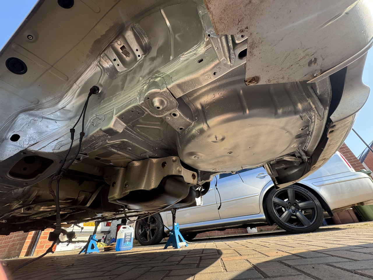

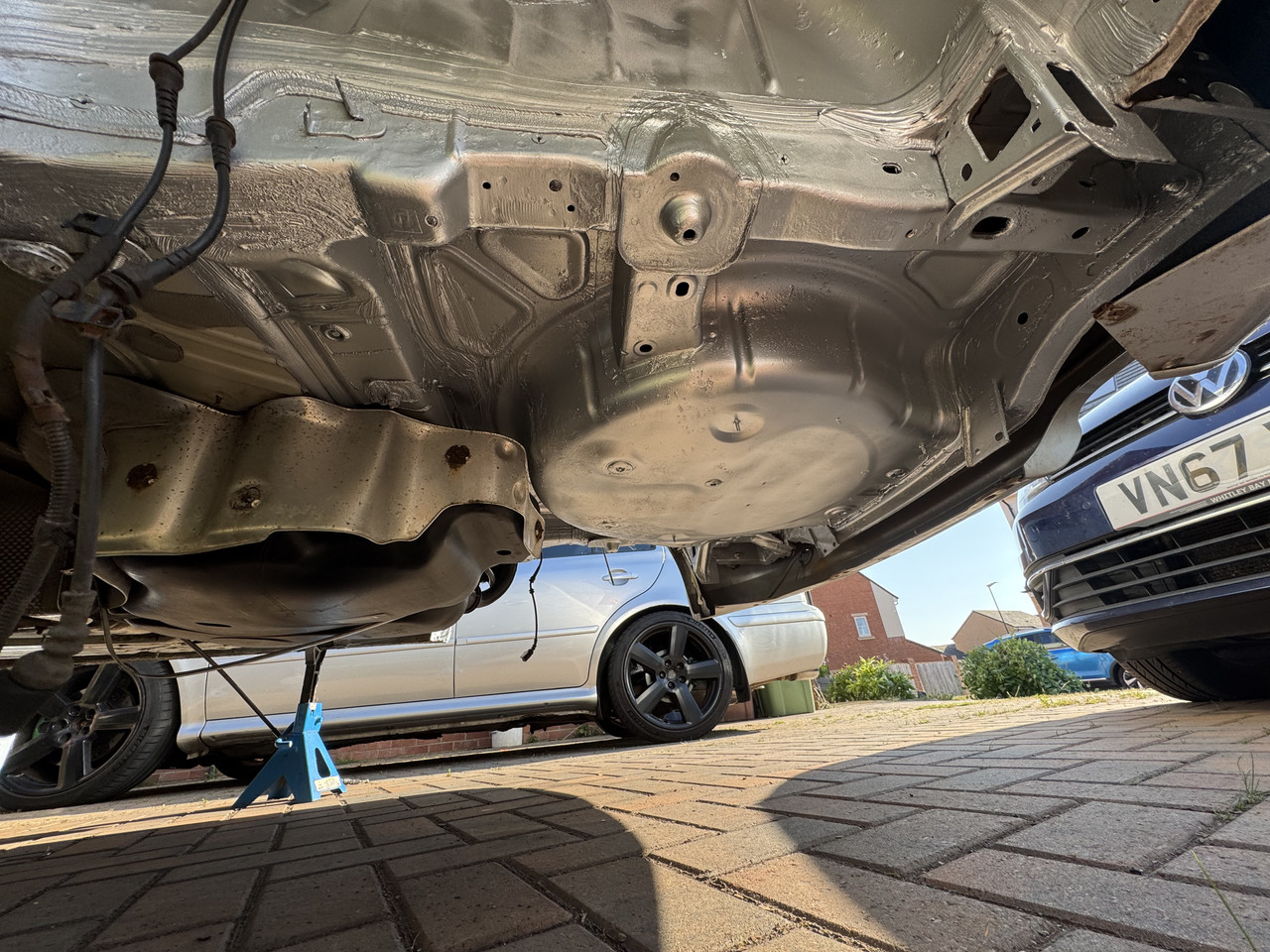

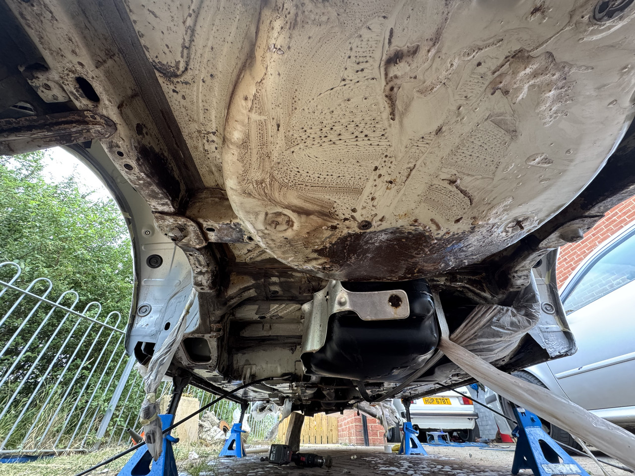

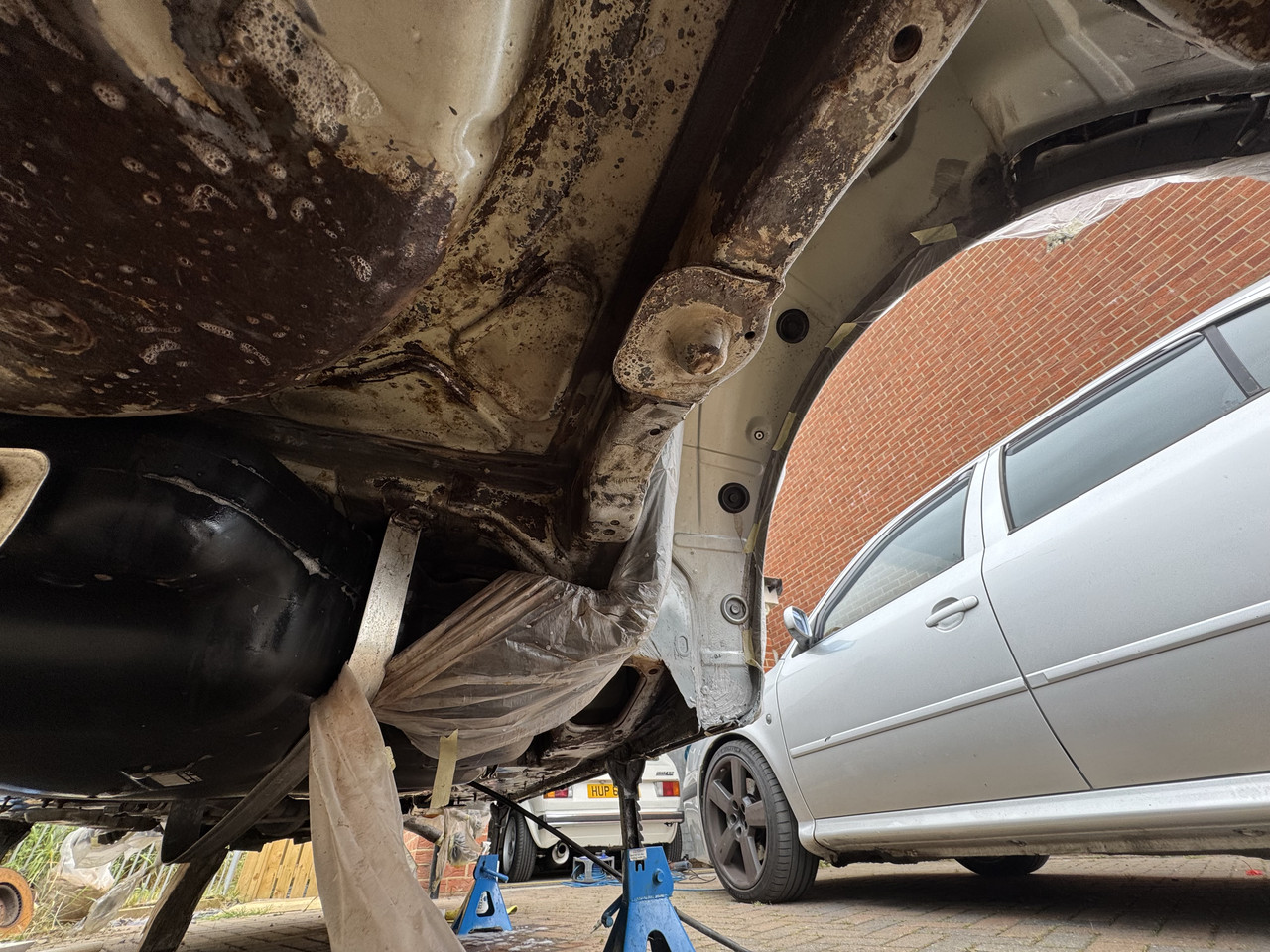

Bit more progress - basically got all the De-Ox treatment done, washed it all down and prepped the surfaces, then gave it a prime with the Bilt Hamber primer:

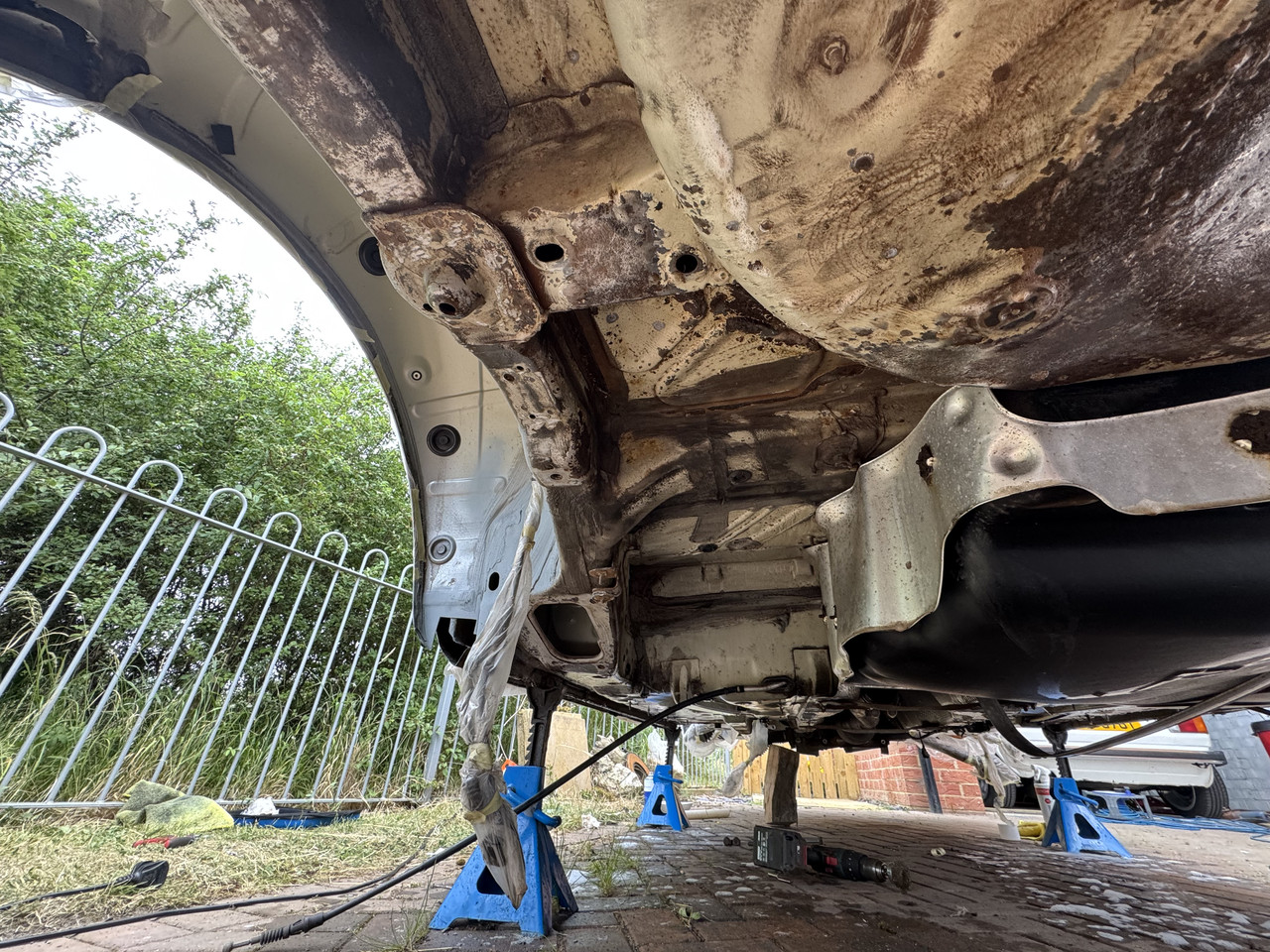

Then moved onto the underneath - I’ve not done the full floor like but most of the rear and a few spots that were bubbling further along near to the front.
First step was a full degrease and buzz with the wire brush/flap disc
Also found another bit that needed cutting out and re-making 😭
Then primed and given a coat of stonechip
Then finally covered everything with a couple coats of LA7W and some lacquer - starting to take shape now 😎
Last things to do before fitting all the bits back on is to get the holes patched and welded (didn’t have enough time the other day so just wanted to get everything coated so it didn’t start to rust again being bare metal) and then give everything a coat of Dynax UC
Then need to make the new brake lines as none of the 4 old ones came off without shearing 😂 - suppose its another ‘While I’m in there’ job, then finally back on with the bits and hopefully get it finished off! The hope is to get it done before I go on Holiday at the end of the month 🤞🏻

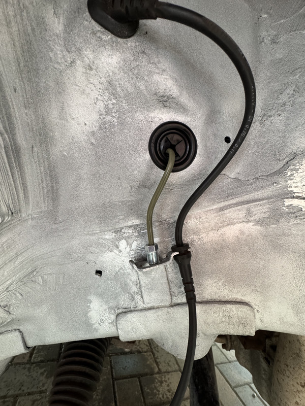

Nah there is a small joining block just under the passenger footwell, they go to the ABS unit from there. I’m really hoping the front solid lines come out easily 🤞🏻

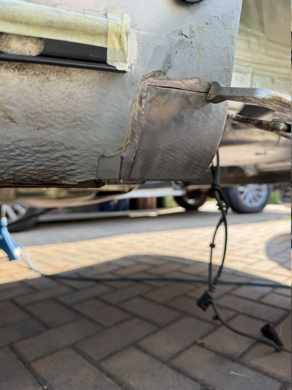

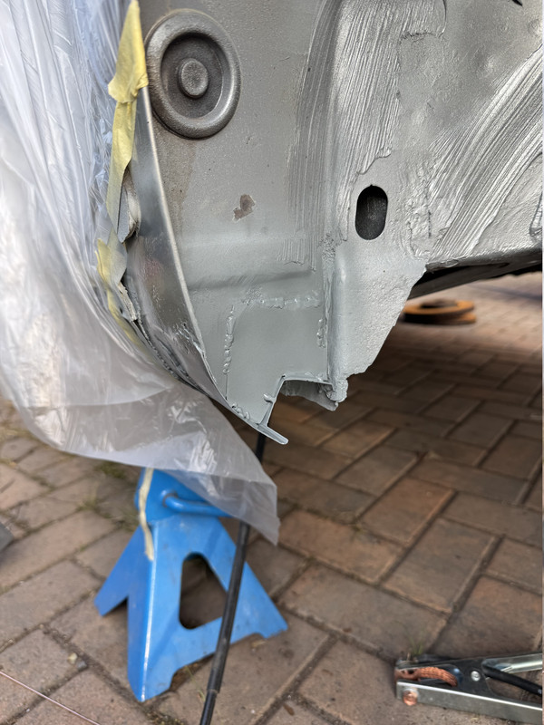

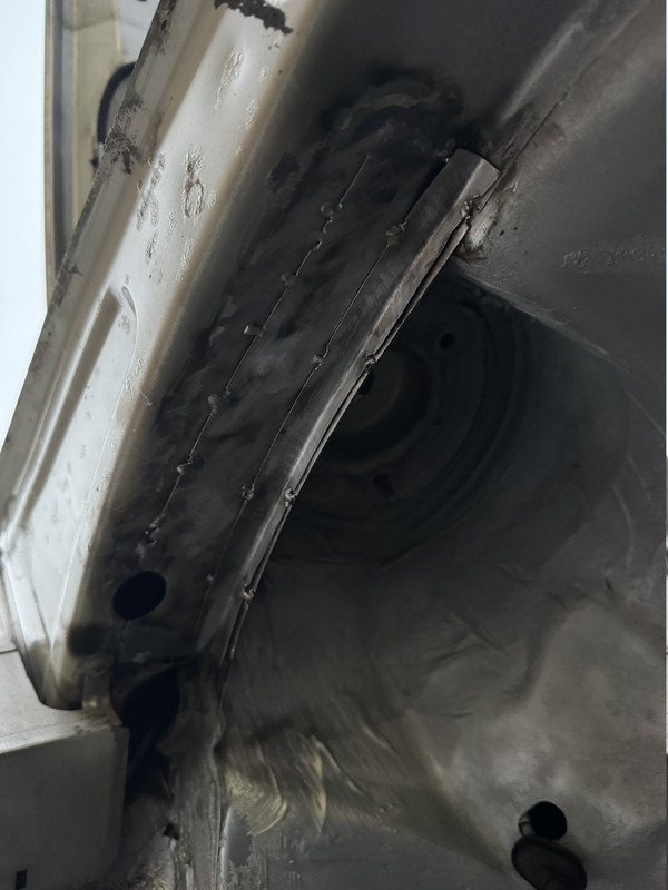

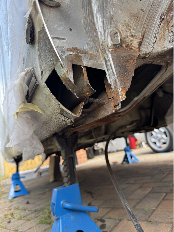

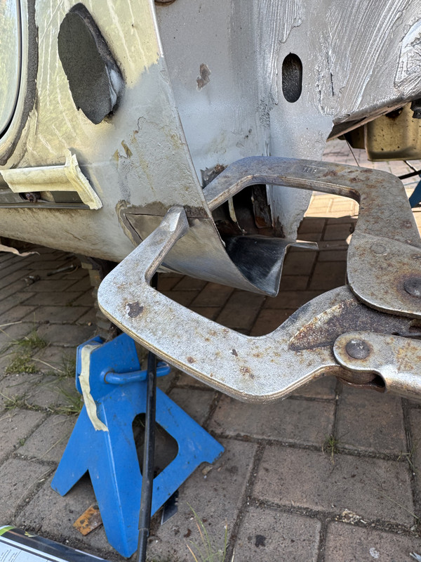

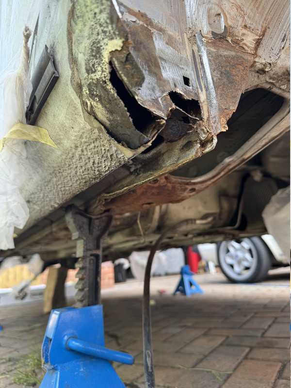

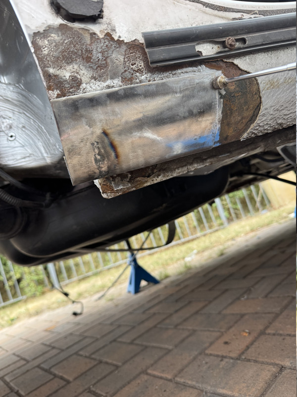

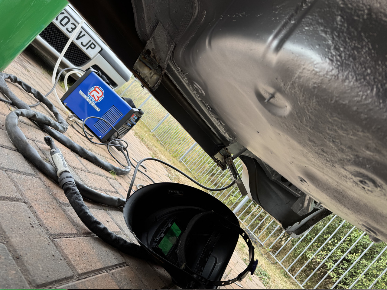

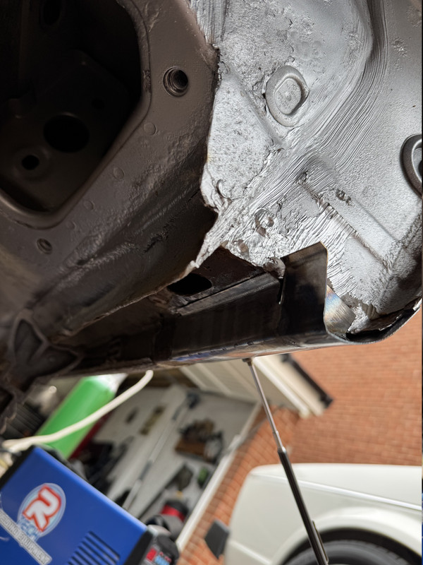

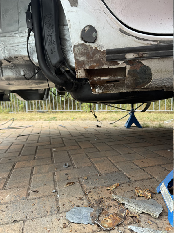

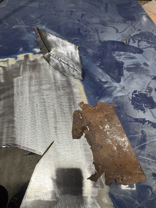

Main thing I have been doing is sorting ANOTHER rust section which I found on the drivers gate rear sill (same as the other side) but it actually turned out to be worse! I didn’t take a photo of it before but it honestly looked like nothing, but I ended up having to cut away this much:
So, made another patch panel and get it welded in, seam sealered, painted and stone chipped - it’s not the prettiest but it is solid and should last another 20 years!
Also cut off and made some new rear bumper supports as they were completely rotten

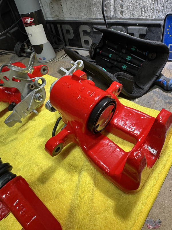

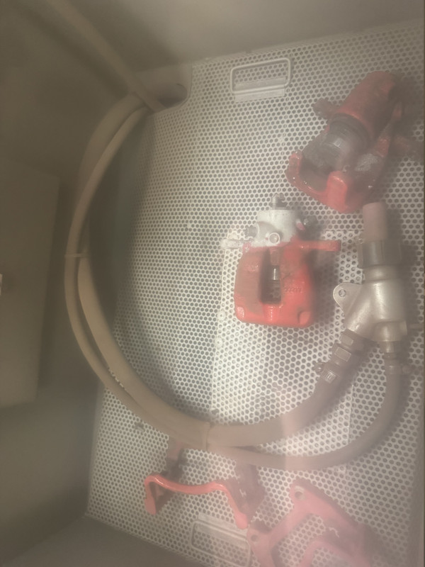

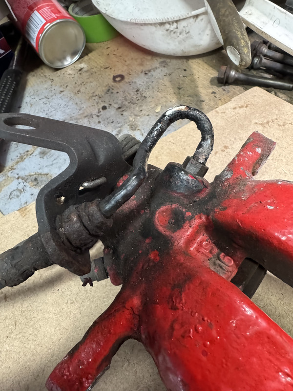

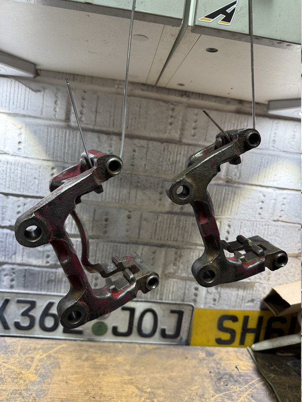

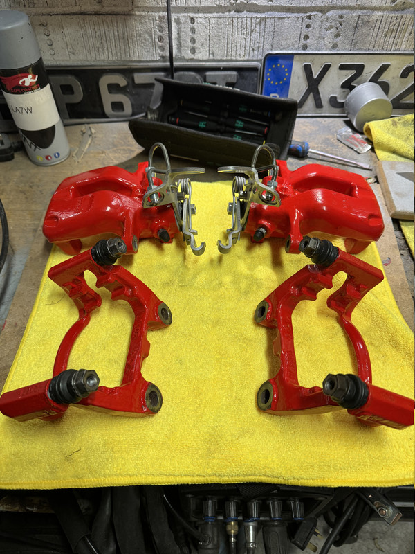

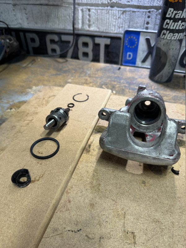

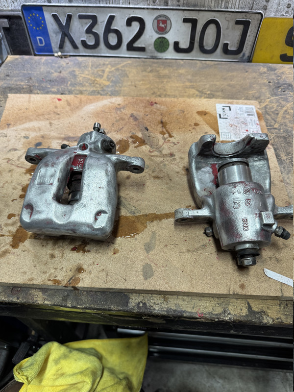

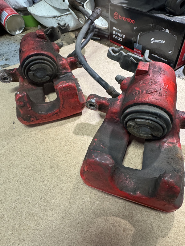

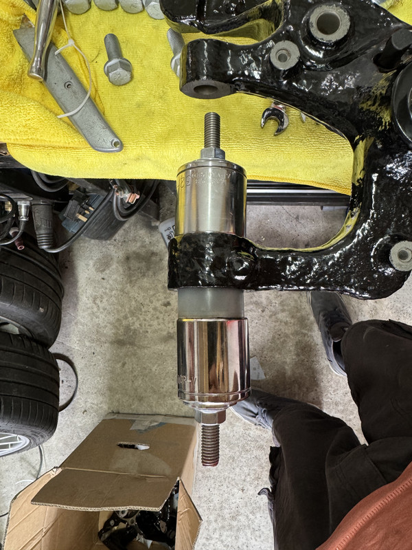

Next, I moved onto the rear brakes, I’ve not refurbed a set of calipers before but thought I’d give it a go since the car is off the road, they came out pretty well.
I’m a member of a restoration club here in the northeast where I have access to various bits of machinery, blasting cabinet being one of them, so stripped them all down and blasted them first:
Then bought a seal kit from big redd to replace all the seals, wasn’t too bad to do, main issue was I snapped one the lugs off the internal circlip so had to order some more which hindered progress!
Then painted them all up ready for assembly, they have came out pretty well, just hope they don’t leak haha!

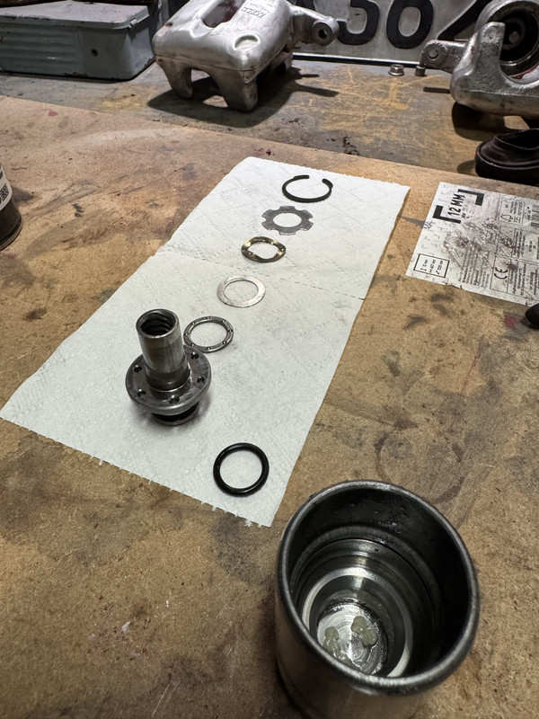

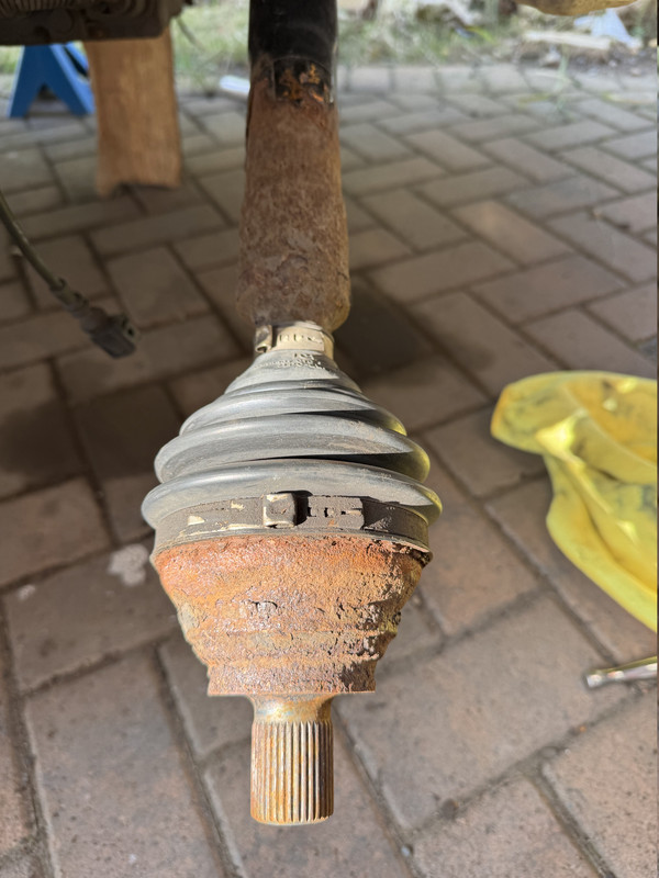

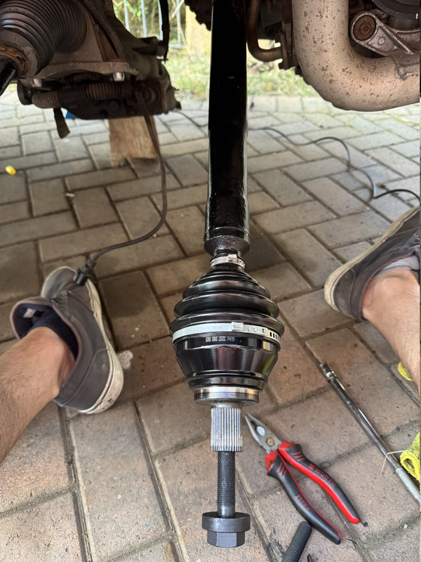

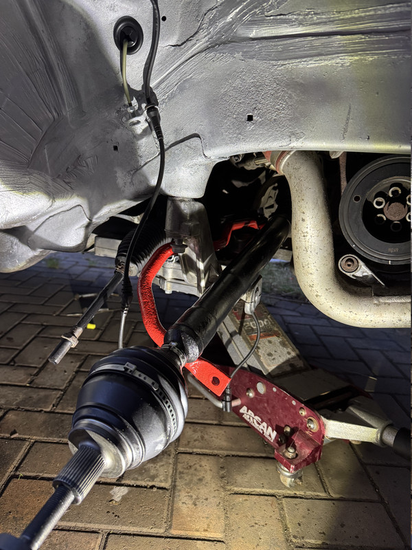

Then moved onto replacing the outer CV joints, the driveshafts were fine but it was more the fact that they were rusty so it was cheaper to just replace the outers and paint the rusty bits 😂

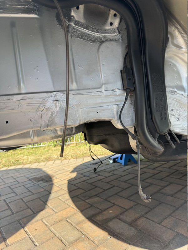

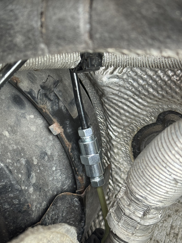

Other things I’ve done, I got replacement front to rear brakelines from TPS but the fronts from ABS unit to arches are discontinued so had to make those, I only got a couple of photos of those though! I had to put a join in the one to the drivers side as getting it in without removing the engine was pretty much impossible without bending it all over!

I think my drivers rear sill will be the same when I finally get to that bit.

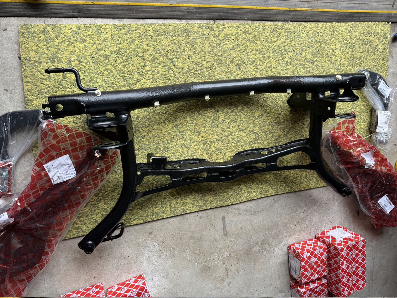

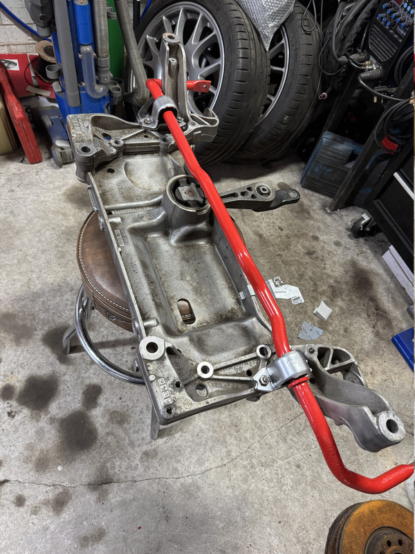

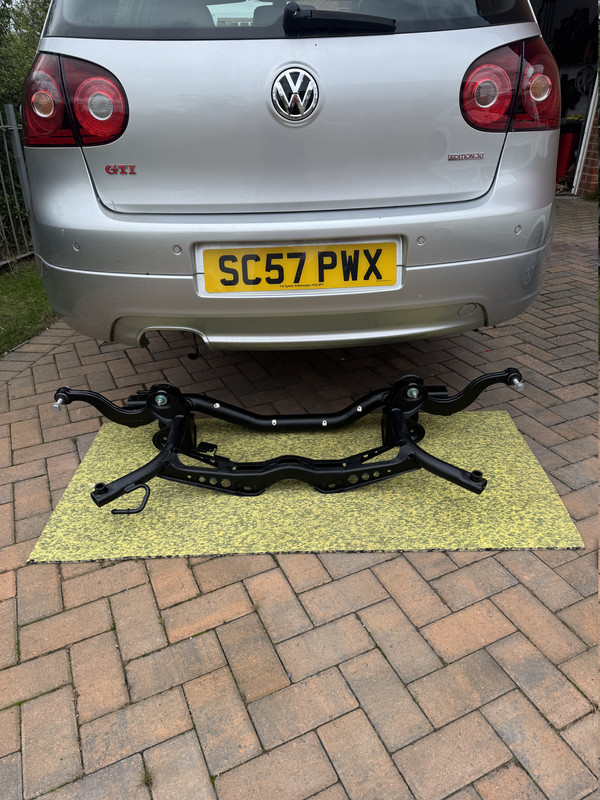

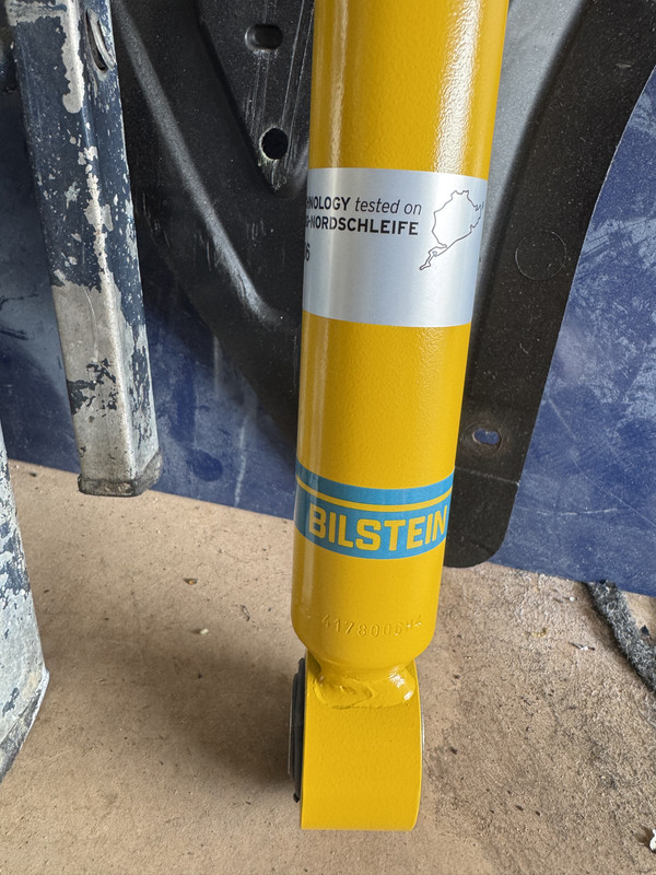

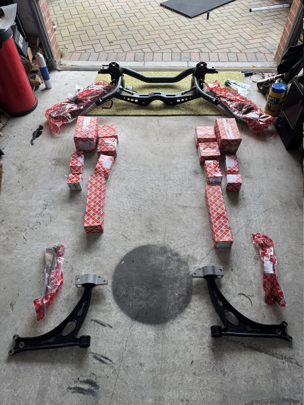

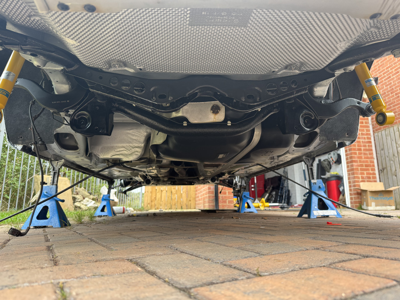

Yeah I had a good day at it yesterday, got both the front and rear subframes on, track rod ends, bottom arms, fitted up a couple of the rear arms, got the rear shockers on and a few other bits.
Pressed the rear hub bushes in, fitted the front bearings and also fitted all the new ABS sensors to the hubs.
However, I have realised that a few of the bits from autodoc are not correct, and I am missing some bolts too. The inner race of the rear wheel bearings are too big by like 2mm so they need swapping, and one of the front bearings is missing a bolt, so will need to get those sorted and I also missed off the rear swing arms 😂 so I’ve ordered those.
Feels good to finally start putting things back together!
