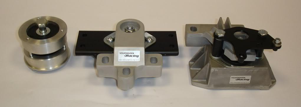

^ The VWR full set of 3 'Fast Road' engine mounts ^

VWRacing offer 'Fast Road' hard bushed mounts or 'Race' solid mounts. The Race mounts will transfer more sound and vibration from the engine bay but will firm up the drivetrain to the absolute maximum and increase vibration levels - This doesn't matter in a racing environment.
There is also the choice of whether to change all three engine mounts or just the dogbone one. Mark Farmer at VWR advised me that the dogbone one was the mount which would give the most advantage and to leave doing the other two at least to begin with. The 2.0T FSI engine is well known for having a fair amount of movement and twist under power in the GTI chassis.

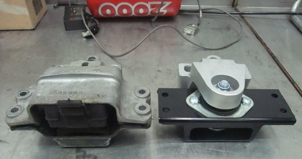

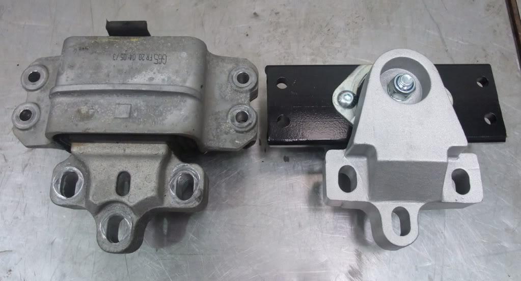

^ You can see just how much damping rubber the stock engine mounts have in comparison - It's no wonder that there is so much engine movement and that you can't hear the engine itself while driving. But hey-ho, it's what most car buyers want.

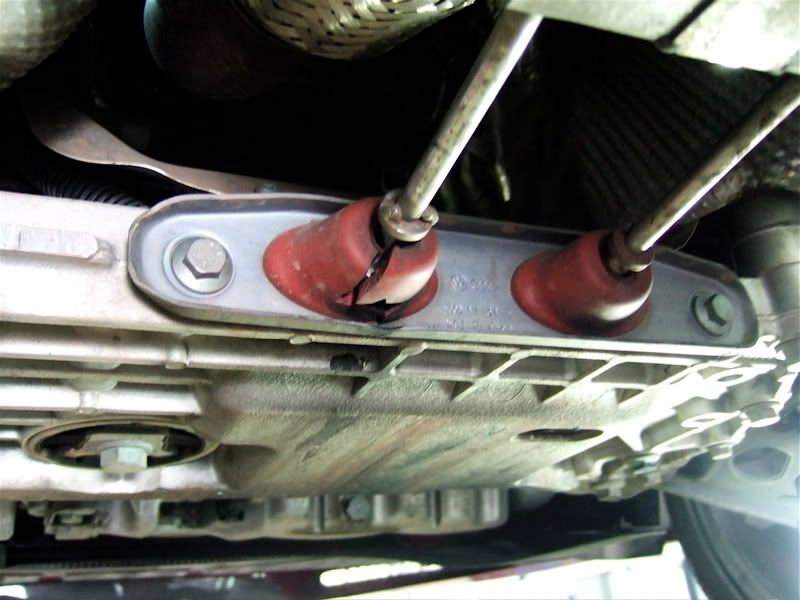

- To further reduce engine movement and subsequent breakages - Exhaust brackets being the most common. Milltek now include a free torque arm insert with their new exhausts.
^ Broken exhaust mount as a result of too much engine movement ^
