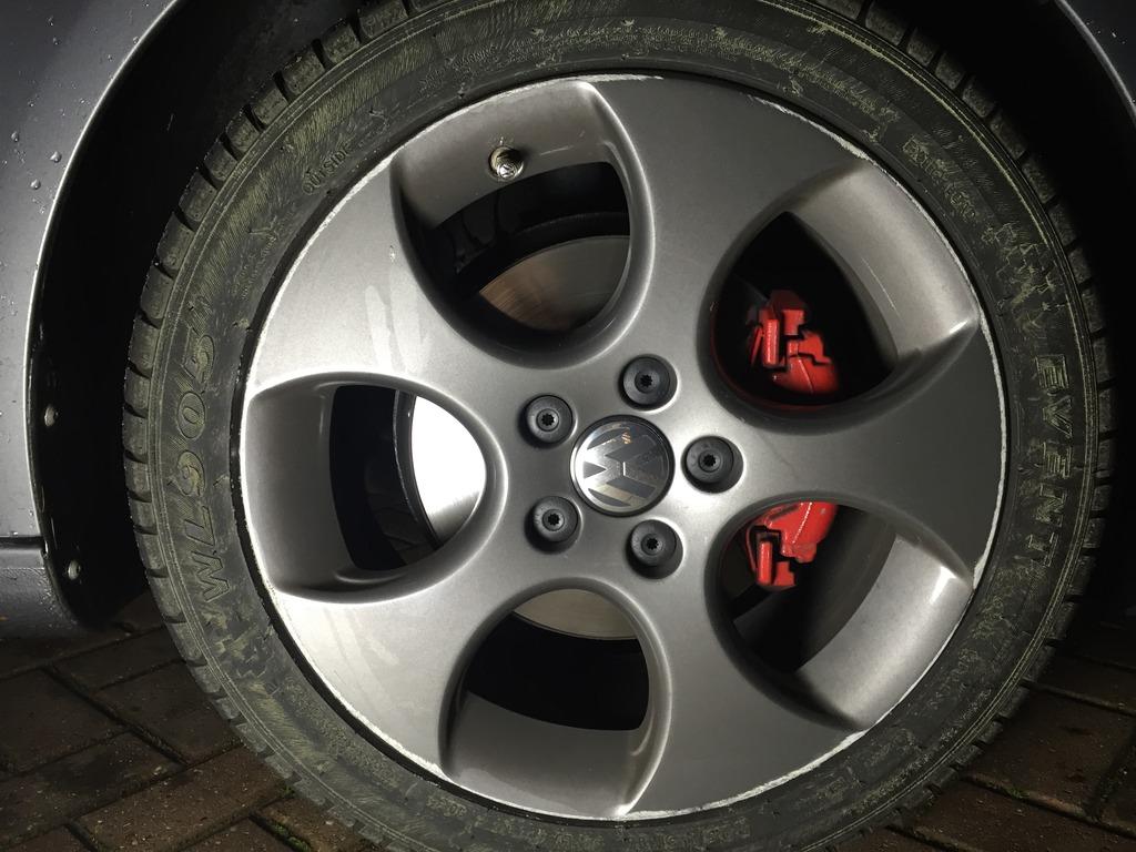

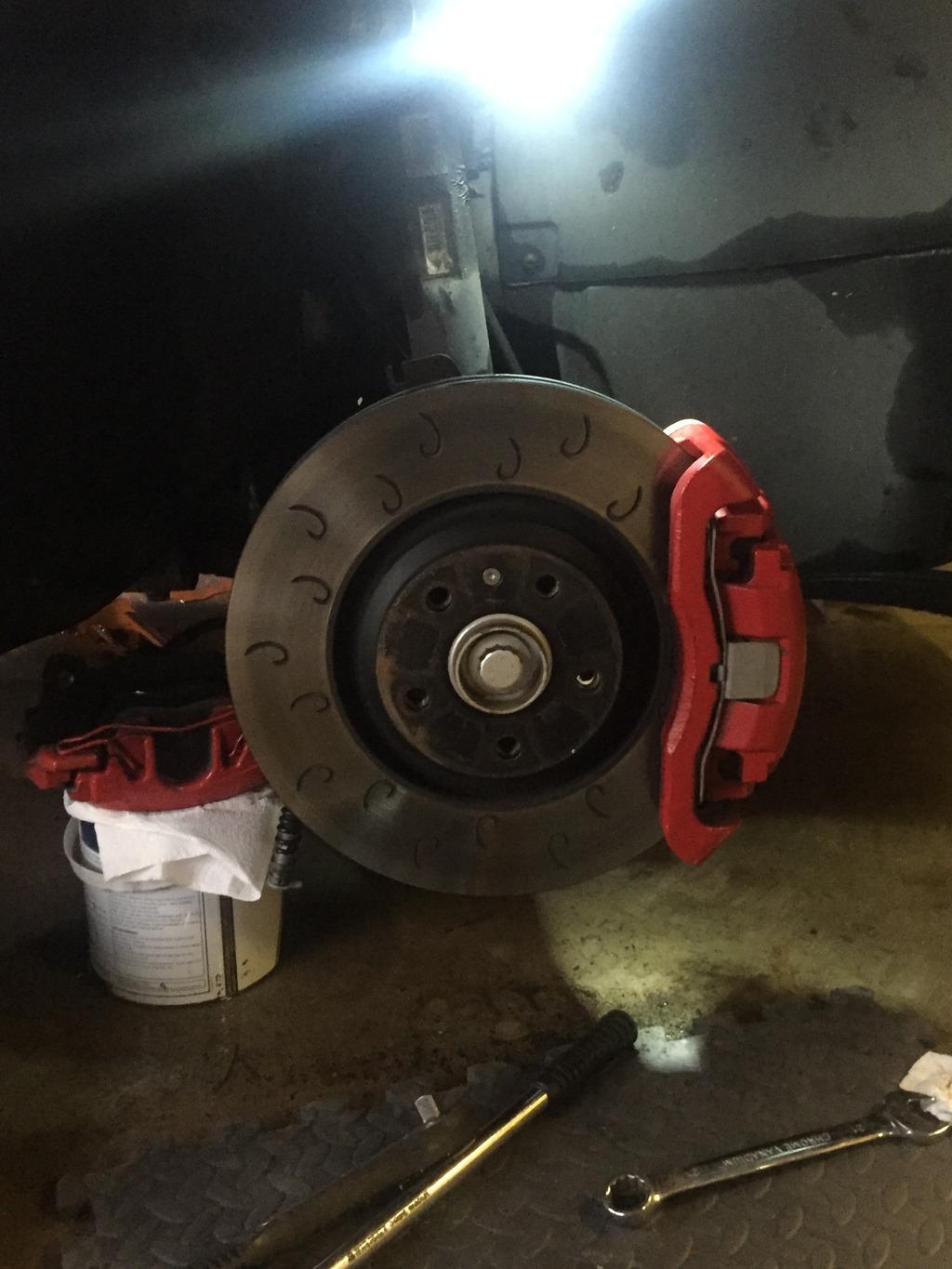

Bit of a brake upgrade now on the fronts...
A comparison in disc size lol
old brakes
new brakes :D
Will try and get some better photos tomorrow, but a massive thank you to @jhook661 for these! And fitting!!! Over the moon now and I can start looking forward to my remap sooner now  :party:

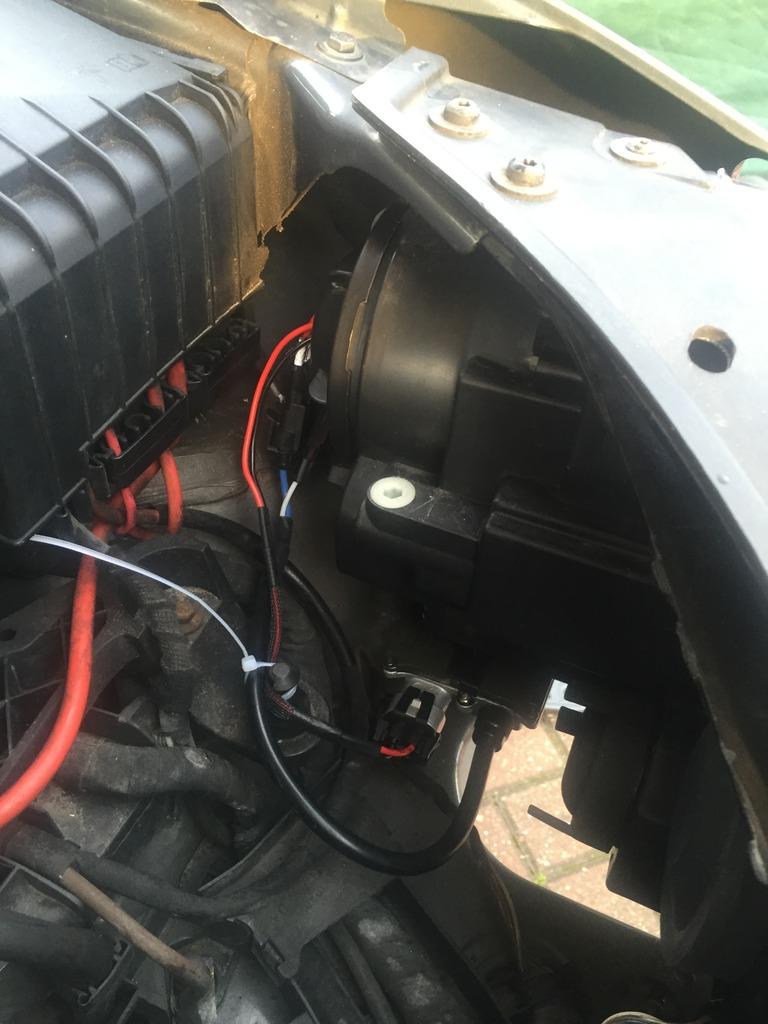

Broke my crappy replica ED30 front lip this week, but I bought a genuine one off the forum so went about fitting it this evening!
Whilst I had the bumpers off I thought I'd try and fit the HID Kit ive had laying around for the past 5 months
a "21mm" hole they reckon... Just about fits with a 26mm hole but there we go!
Managed to get the ballasts mounted to the underside of the lights which is nice that they aren't visible but still replaceable now as there is a clip and retaining screw which is accessible :D
In all the excitement I forgot to grab a pic of the new bumper but I am genuinely over the moon with the HID kit :D
