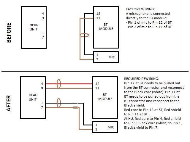

Reviving this thread if poss, I have a 08 golf edition 30, fitted rcd510 dab works fine, now fitted a 7p6 Bluetooth module which also works but no1 can hear me! I have now got vagcom which is saying I need to code it so coming up as a error , any1 done this or is there a tutorial in which I can't find! New to vagcom and don't want to make things worse haha
Did you get the loom with the bluetooth module? The mic might need the wiring checked...

Yes pal I got the loom as well. Checked the wiring all ok. Bought another mic before I realised to plug it in vagcom. Tried the new one and still not working

« Reply #22 on: August 16, 2015, 06:50:40 pm »
Check this picture to see if it helps you:
Not sure how your loom is making the connections.

« Reply #23 on: August 16, 2015, 09:44:02 pm »
May help, will crack on with that over next few days now am back at work. Many thanks for your help
