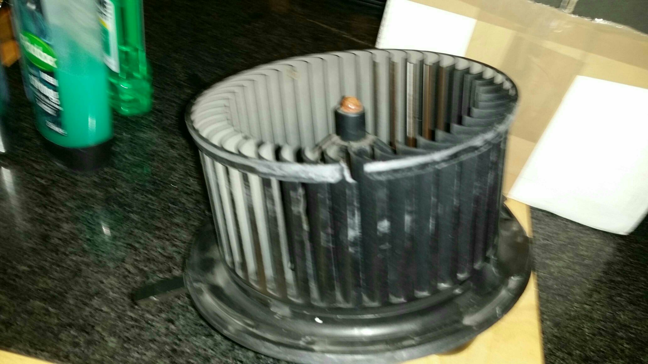

Hey my blower motor started vibrating today its not really noticeable at low speeds but when turned up full with the air con its really loud ! Has any1 got a guide on how to remove the motor and check the fan / fan blades

I had this, really easy to take out, guide on you tube, I found a tissue stuck in mine, took it out and back like new now.

Cheers! popped it out there and the fan itself.is cracked and missing a piece just ordered one from eBay

Here's the source of my vibration all.sorted now
