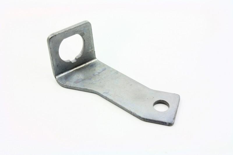

When fitting the s3 calipers and upgrading to braided lines, what happens to the bracket on the rear of the calipers as cannot get the bango of the lines through the hole
Photo for example

The banjo connects directly to the caliper. You must remove the bracket and the hardline.

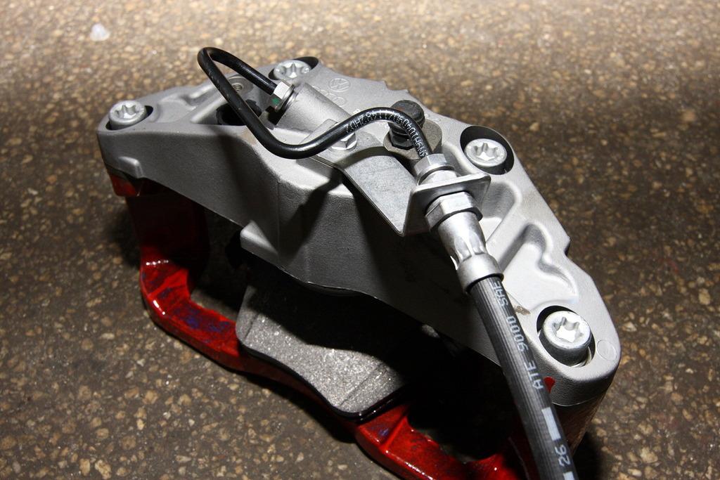

Borrowed of Rich

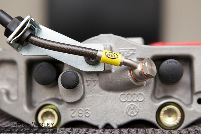

Sometimes you have to file the hole to get the banjo thru... I did
