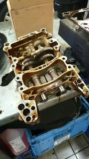

this was changed cured the start up rattle but the hot running tappet noise was still there my mechanic traced the noise to the bottom left hand rear of the engine he'd already dropped the sump when doing the valve gear

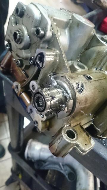

when he looked for the noise he found this in the balance shaft unit
this is the balance shaft unit it also houses the oil pump , its driven by a chain from the front of the crank shaft

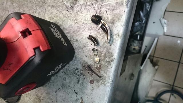

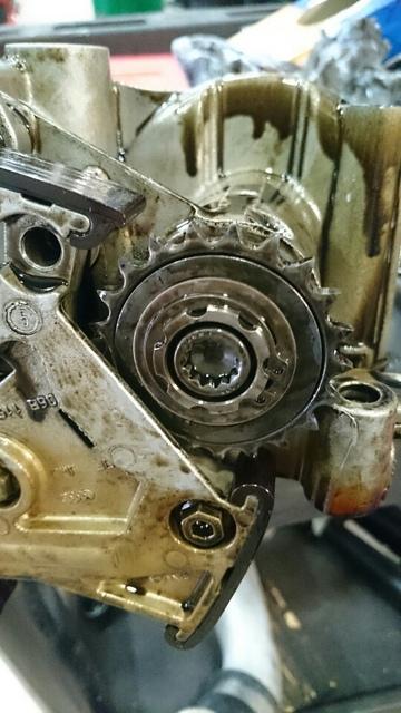

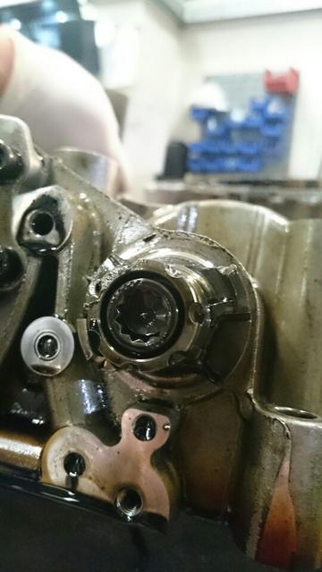

the sprocket drive is a damped type and was moving side to side and when removed look like this
the balancer shaft unit has no serviceable parts apart from the oil pump and is sold as a complete unit cost £1200 lucky my mate had a second hand unit that was good and is now on the car running quieter than its ever done
