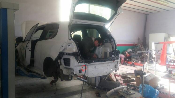

also,is the a3 crush bar a straight swap over to the mk6 golf r?
It's only requqired one small hole
You see the marked spot just a hole,the nut is there.just dril and put the screw.

great appreciate it m8,any particular year a3 bar id need? preferbably say 2007 onwards
Στάλθηκε από το SM-G920F μου χρησιμοποιώντας Tapatalk
I think they are the same.the platform A3 and golf 5 6 are the same.if you see there are 4nut in there under the square spot that crush bar is bolt so you can have any possible combination to screw it.this bar is too light

Well done mate nice build, is the alloy rear subframe off a mk5 r32 ??
This one is from a3 8p 2.0 quattro.mk5 r32 also had the same frame.

Do you have part numbers for the rear crash bar and subframe
I don't have part number but i can find.there are too many part number beacuse many cars share the same platform seat leon,audi a3,skoda yeti,vw golf.
