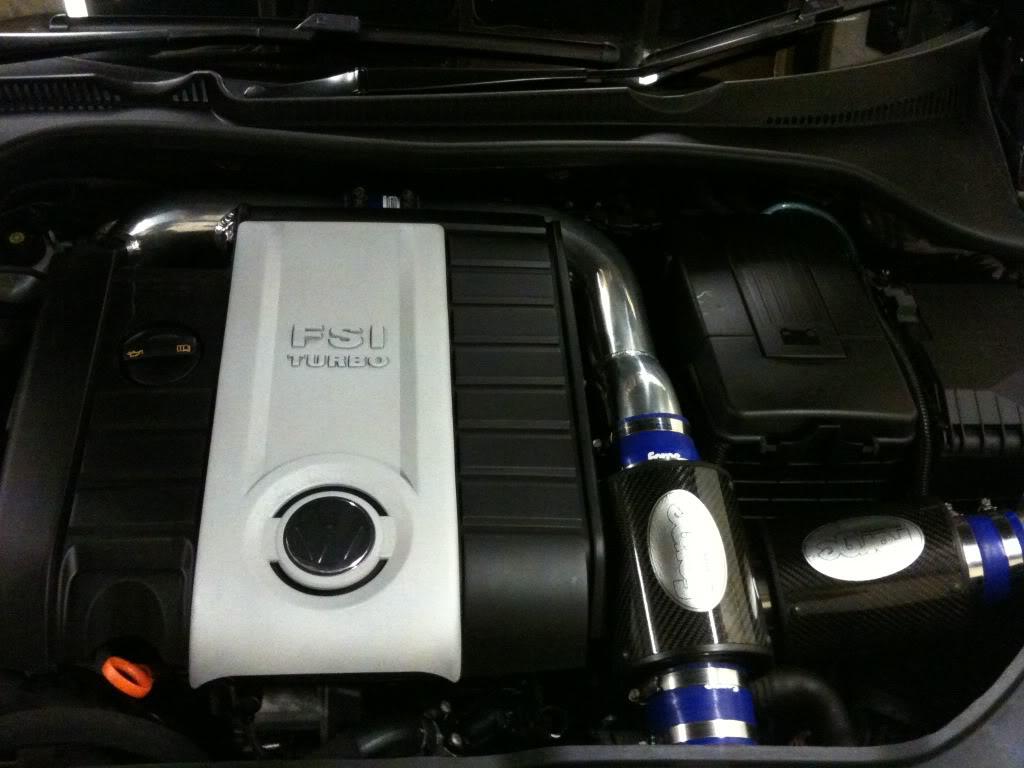

After being inspired by pics from flyboy and Big Al, I bought an old engine cover and modded it to fit with my twintake.
I decided to try and stick to an OEM look so kept it simple with black and silver - hope you like  :happy2:

looking very good mate,
is this held on with just the front two mounts??
if so have you done anything to the rear to keep it in place?

« Reply #49 on: June 02, 2011, 10:49:09 am »
Cheers :drinking:
Yes, just the front 2 mounts hold it in place - nothing required at the back as it's secure and doesn't wobble or move.

« Reply #50 on: June 02, 2011, 11:10:18 am »
cheers will have to cut mine down this weekend
what did you use to cut it if you dont mind me asking

« Reply #51 on: June 02, 2011, 11:27:43 am »
I used a combination of a circular saw for the main straight cuts and a jigsaw for the smaller cuts.
Then just cleaned up the edges with a file and some sandpaper, degreased all the bits and sprayed the cover satin black and the silver strip a colour called aluminium (it's a matt finish).
I seperated the VW badge from the centre strip by gently heating with a heat gun so the double-sided tape softened enough for me to prise it off.

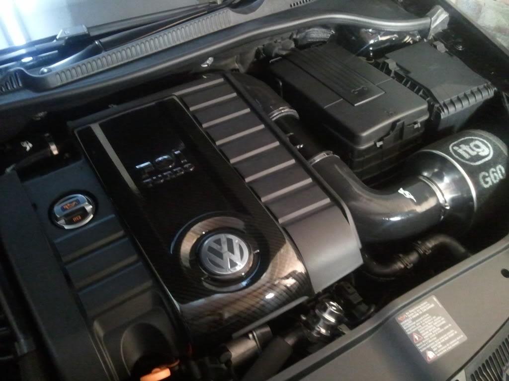

That looks very OEM Skavia, you get a full  :happy2: thumbs up for here  :drinking:

@Jake: this must be one of the ONLY mods you don't have?!
@flyboy: I still prefer your engine bay - how much does the carbon dipping cost?

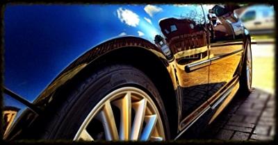

Didn't like the bright silver finish on the wheels so had them acid-dipped and redone the same shade as the Audi R8 V10 wheels :smiley:
