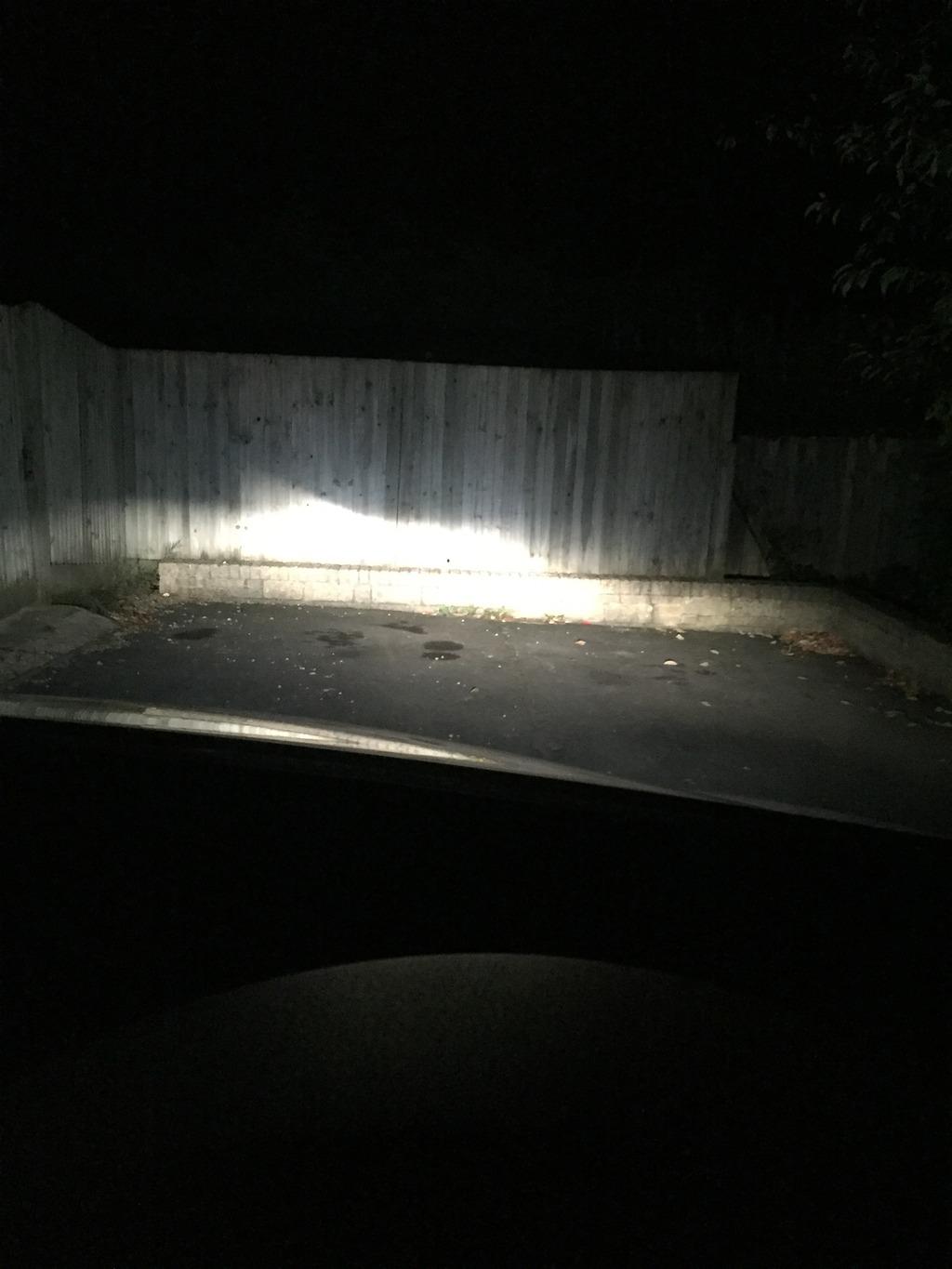

I find my bulbs brilliant at night, they light everything up perfectly and look a lot whiter than every other car.
Here are a few pics I took of them

HID's inside halogen reflector headlamps don't give the correct beam pattern. They are too bright for the reflectors so the light scatters and goes everywhere, blinding drivers  coming the other way. Plus on the MK5 golf there's a chance that it can fry you wiper motors and leave you without any wipers  :laugh:
