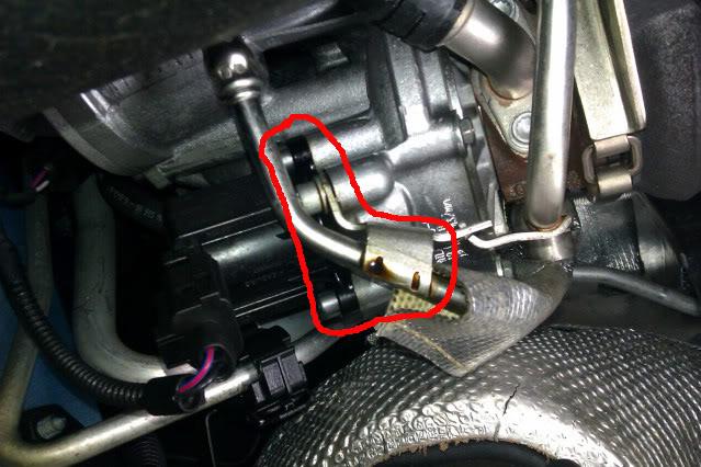

Car only has 8000 miles on it 99.99999% of those are commuter miles. :ashamed:
OIL HERE --- Under the car on the turbos diverter valve seal/join ---  06F 145 710G

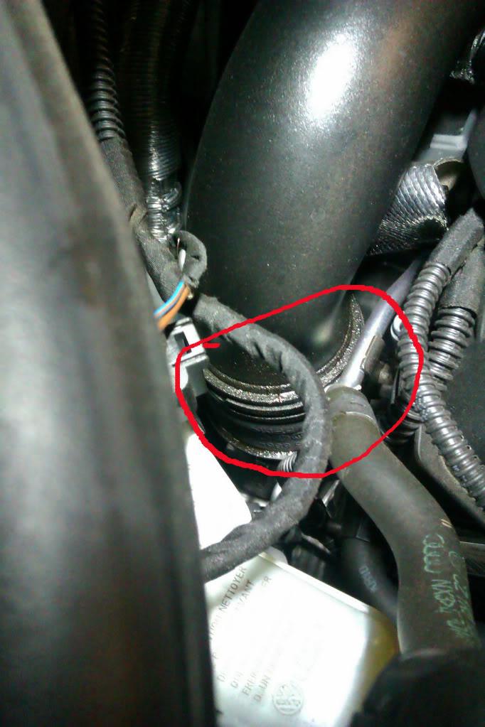

OIL HERE --- Main air feed pipe join down the side of the engine.

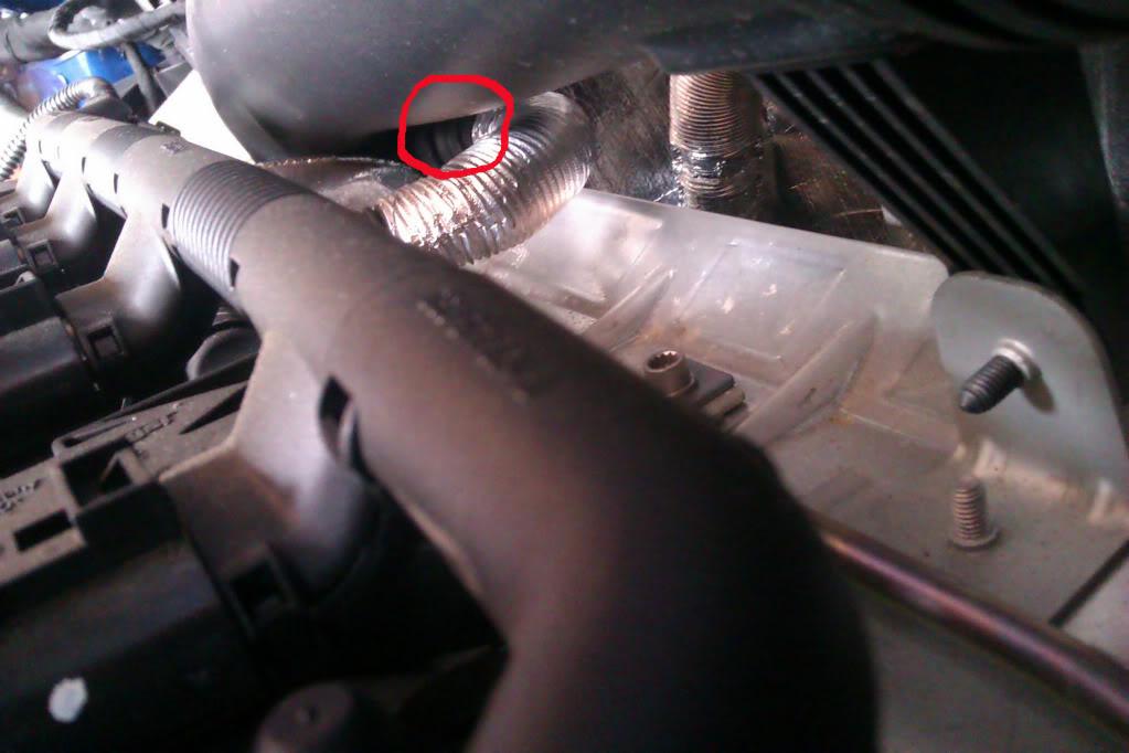

OIL HERE --- Small pipe join connection to air feed pipe.

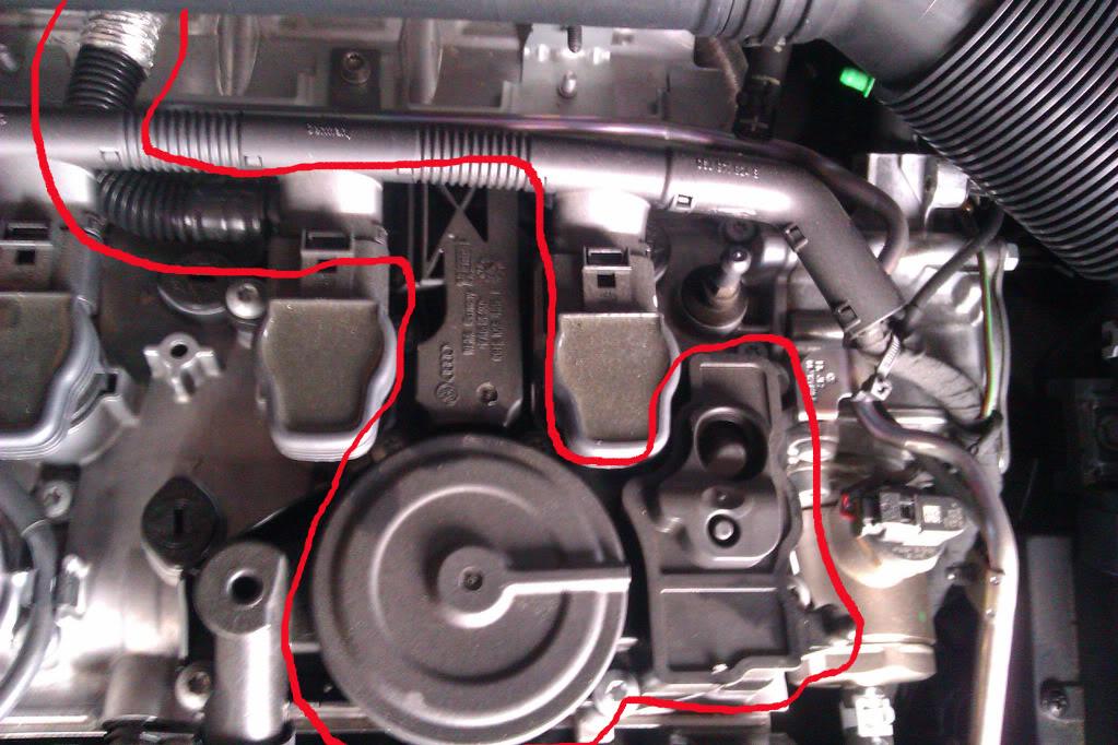

Above small pipe is connected to this --- 06H 103 22A A  --- 06H 103 495 E
And that is this
