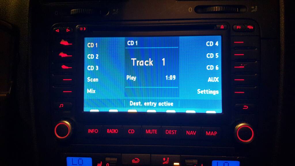

Hi guys I'm new to this forum and was after a little help. I have sat nav and went to put a couple in the top of the nav unit but it wouldn't take it as the nav disc is in. When I press the CD's button it pulls up on the screen that there is 6 discs in but won't eject any. My head is a little battered on trying to figure out how to get discs loaded. I can't find a cd changer anywhere so I assumed the nav unit would load 6 discs. This is my nav unit if it helps as you can see it says it's playing a disc but there's no sound even with the volume right up.
Any help would be greatly appreciated. Cheers Dave

I'm taking it you have an armrest in the car? The 6 disc changer is in there.

Cheers for the reply mate. Yes I have an arm rest but no changer. I figured it all out a few weeks back when I found an ipod lead in the glove box lol

when I press the cd eject button mon my RCD unit, it then prompts which slot to i want to load or unload?
