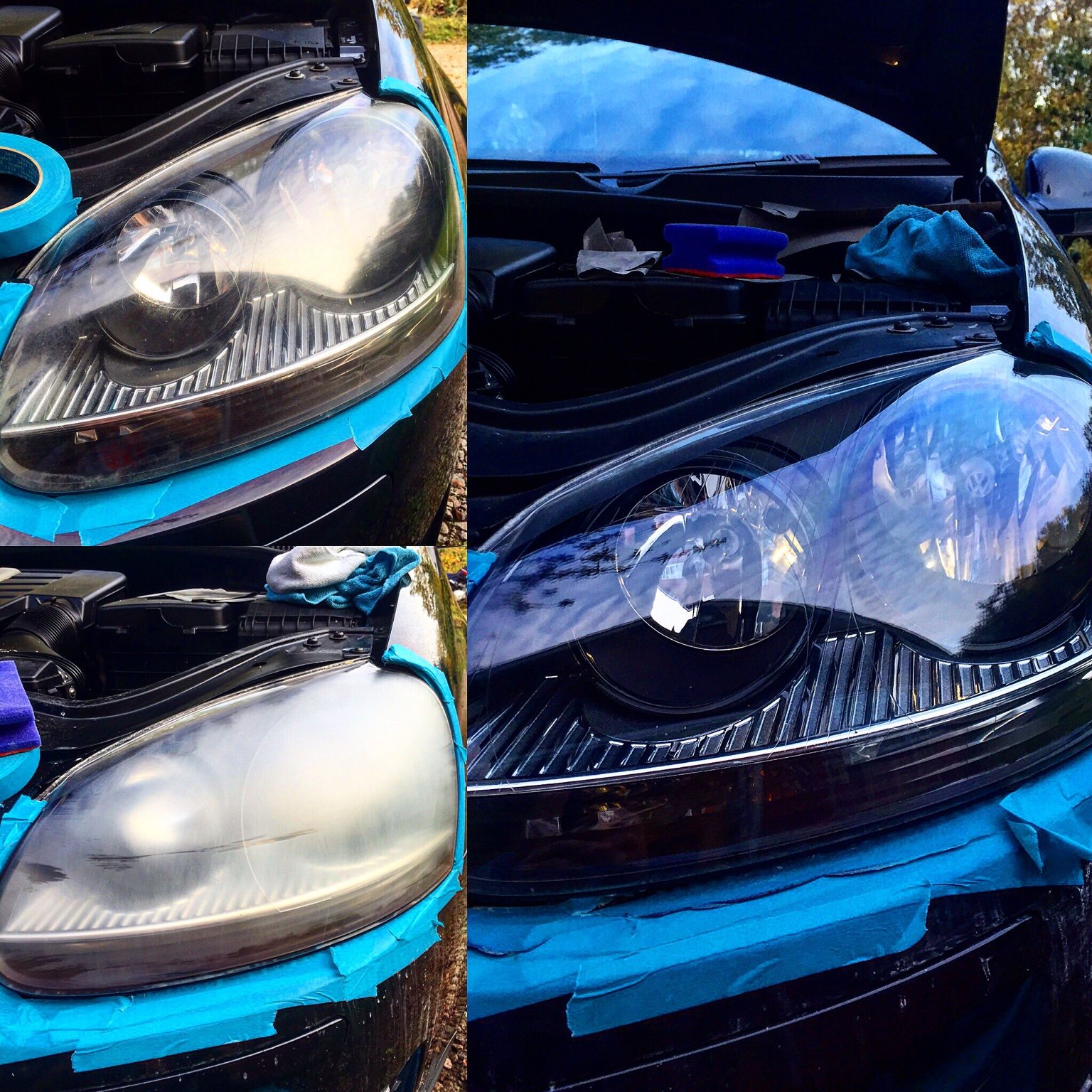

I'm new to here and I was wondering is the clouding of the headlights a common problem? I own a TDI so was looking to buy some GTI headlights but it seems mine and most of the ones I've found for sale have this problem. Can anyone help?

It's a common problem on most cars it's a combination of factors breaking down the plastic. Thi is what you need,
http://www.ebay.co.uk/itm/3M-Headlight-Headlamp-Lens-Restoration-Kit-/111799290119?hash=item1a07c1c907:g:3iUAAOSwyvBV9xql
And a drill.
you will also need to seal the headlight.

Awesome thanks! some good results on your lights. Will have to give this a try.

They came out great, mine need doing I was going to try the meguiars one step kit but for the extra £5 I think I'll try this kit now!
