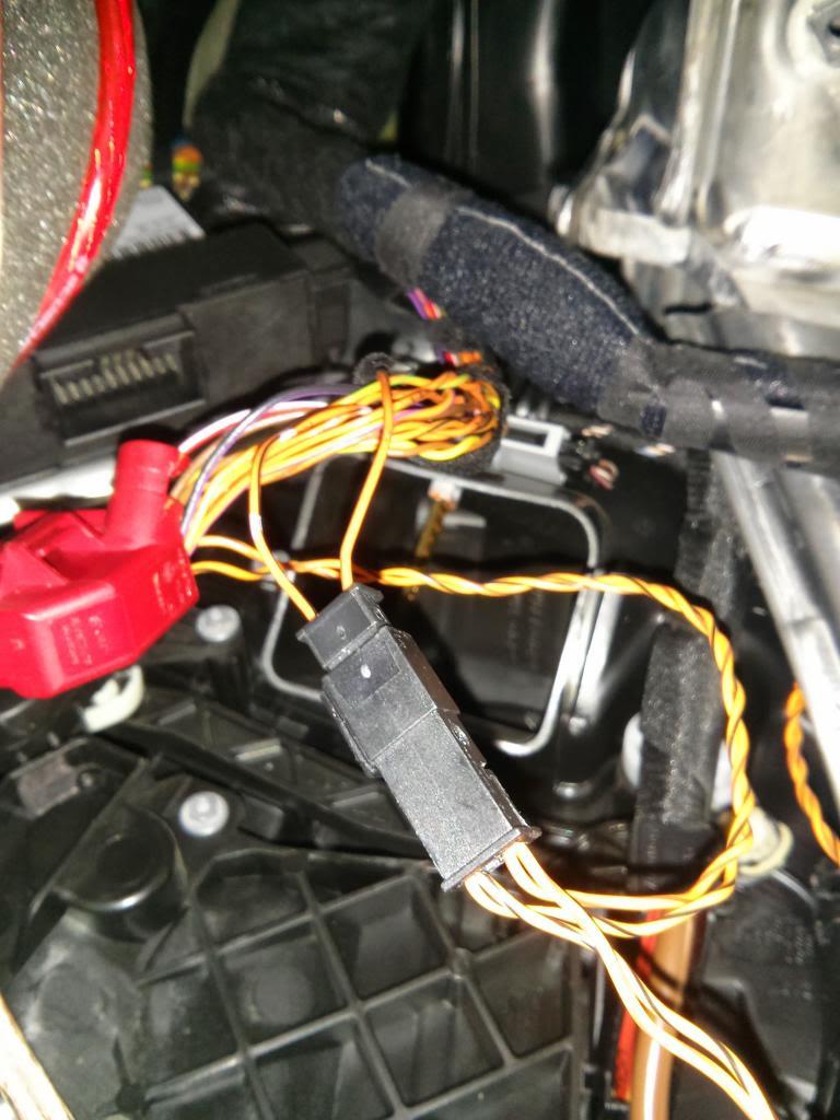

Well folks - I think I've fecked it up and I need some help.
I got the system wires routed to the front and got access to the CAN Gateway wires and to pull the pins out and replace with parking sensor's CAN low / CAN high (Pin 6 / 16) .
Unfortunately the CAN high pin got a bit stuck on the way out of the gateway and once out, we saw the terminal was slightly bent and the terminal itself was loose (the cable was just sliding in and out of the terminal).
So we decided to solder the CAN high cable to the parking sensor's cable.
CAN low went into the new parking sensors' loom without a hitch.
Got ground connected and postive power with an inline fuse connected to the fuse box.
Started it up and saw the following:
Cruise control light on dash flickering and then eventually turning off (with no function from CC).
Indicators being eratic/sticking.
Door locking/unlocking repeatedly while driving.
Window controls inoperable for other doors from driver's side.
MFSW slow to respond.
Clicking noise happening every 3 or 5 seconds (sounds simialr to click from indicator relay - and in the same region).
Not sure what to do here - we spent a good couple of hours checking everything over to make sure it was all connected in the correct sequence.
Does anyone have any ideas on what's gone wrong? Slightly worried I may have done some damage somewhere :(
Will post a VCDS log of all of the issues that are now present.

Did you cancel all the DTC's after your scan and recheck they cleared when rescanned?
What pin connectors did you remove from the can gateway connector cause from memory mine were On the CAN gate connector (T-20e) Pin 16 is CAN High and Pin 6 is CAN Low.
Now I know you say you removed the same pins so can you confirm the wire colour code including the trace wire colours you've remove.

Cleared many of the faults after this scan. Will get a new scan in the morning.
I don't believe I've gotten the pins wrong (but hopeful I have, as easy fix, right?).
These are my "before" pictures.
CAN high is pin 16 - it is had a black trace wire in it and also has a slight white ribbon at its bottom - you can see my photo of it all connectted that it is now soldered into the CAN high of the parking sensors:
CAN low is pin 6.
I will get a few shots of the Gateway connector in the morning to make sure they are in their rightful position - cheers for your help! :)

As a check if you follow the can gateway wires into the vehicle harness the correct two wires will be as a twisted pair.

the best thing you can do today is make sure the orange and black (high) from the car 100 % goes to pin 16 of the gateway and the orange and brown (low) goto pin 6 unplug the ops module cancel all fault codes and see if the cars ok
next have you changed your gateway in your mk5 golf or is it still the same version?
Will do to confirm.
Will check CAN high goes fully to pin 16 today and CAN low to pin 6.
Will also try plugging the car's CAN low directly back into the Gateway again. Can't do the same with the CAN high due to soldering.
Will disconnect the OPS.
Yes, I upgraded the Gateway to 7N0 907 530 AN to support my RNS 510. Is this one okay?
