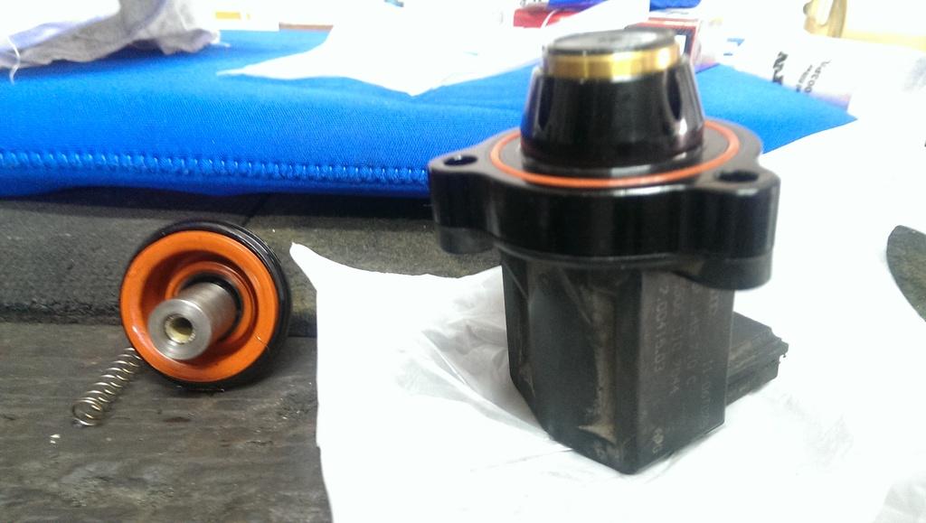

R-Tech have been doing tests with the genuine and copy items recently. Copy items are extremely poor in comparison and prone to leaking.

It's not just the leaking - the quality control isn't there and the machining tolerances are very fine. The cheap ones were seizing and not opening/closing as they should
Also expect a fault code to be stored in the ECU if you use both springs. Won't get an EML though but the underlying code will be stored. I think I have 3 or 4 codes stored now for various things I've removed or changed

today installed DV +
impressions, more than satisfied,Old divert valve was not torn eraser, but in cycles up to the red line had a pressure loss, followed by 0.8 bar when it reaches the red line falls to 0.5 bar pressure.
new DV +, there is no loss of pressure :smiley:Now the pressure is always the same 0.8 bar up to the red line :smiley:

I can shed some light on this as I actually installed one.
It worked perfectly and I had no problems, it allows the boost to be held between gear changes, which means your straight back on the boost and the car feels faster.
Great mod for the money and would recommend it
