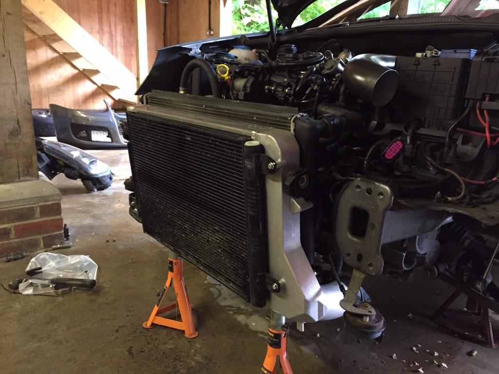

Hi Chris what you've got to do roughly is
Disconnect battery for the airbag crash sensors on the front of the car they are yellow
Unclip fog lights connectors
Remove grille
Remove bumper disconnect headlights
Air intake pipe
Remove the entire front end
Intercooler sits between the aircon rad and radiator like so
« Last Edit: December 02, 2015, 08:12:51 am by jhook661 »
Thanks for that it's cleared a lot up but what's the reason why you can't put all the rads together then sit them back in the whole front panel and lift them all (panel + rads) in one piece and fit to car? It'll probs come clear when I start but just want to know things now so I don't get stuck

« Reply #4 on: December 02, 2015, 10:11:48 am »
the radiator plug, hoses and A/C hoses (on the driver side)dont need to be disconnected/regassed etc.
so just swing the A/C out like a door on a hinge

I managed to change my Intercooler with only removing the front bumper and removing the bolts for the slam panel and sliding it in from underneath....
