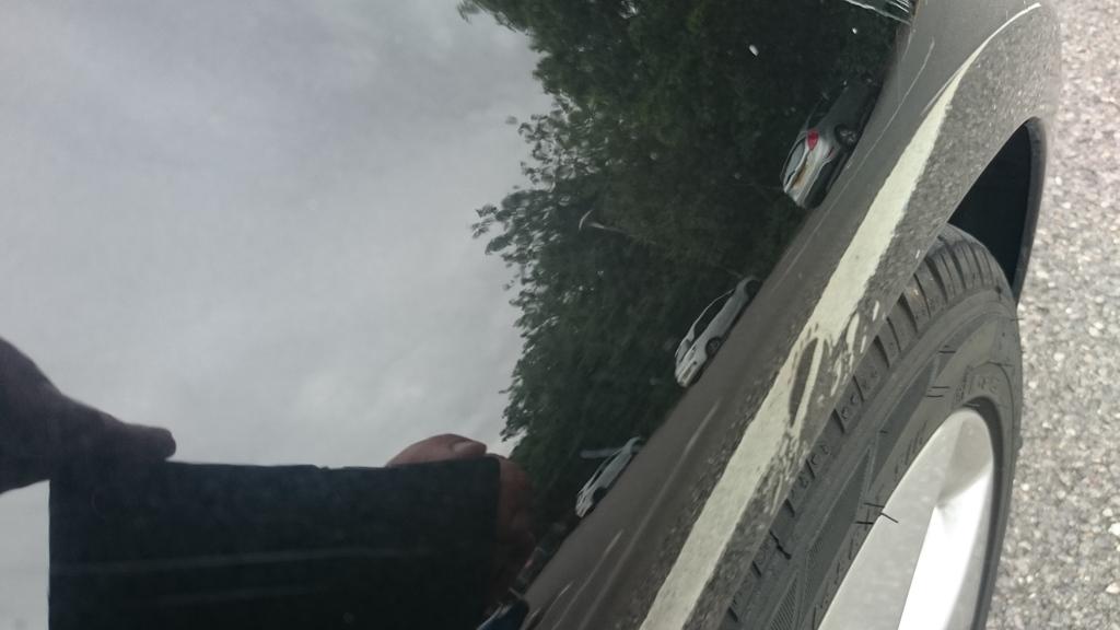

Hi all
Would like some advice, I picked up my Golf GTI a few weeks ago but have just noticed that the paint is bubbling over the driver's side wheel arch. Must admit this is something I have never experienced before on any of the cars that I have owned (Jag X Type, Honda Civic, VW Bora, Peugeot 206 GTI).
To be completely honest I cant believe that I didn't spot it when I purchased the car, in fact to say that I'm annoyed with myself right now is an understatement. However as I understand, Volkswagen offers a 12 year warranty on a cars paintwork. Therefore as my car is a 2005 I should still be covered for this?
My car has a full service history with a stack load of invoices, heck in fact a lot of them from VW dealers. One particular being way over £1,000 for a service and 2 replacement headlights  :laugh:
Let me know what you think,
George
2005 Golf GTI Mk5

Thanks for all your replies, contacted Lancaster Volkswagen Milton Keynes on Friday who put me in touch with an official body shop repair company around the corner.
Took my car there Saturday morning and they proceeded to take photos and measure the paint depth over the wheelarches using a James Bond style gadget!  :grin: According to the readings, my car has never been resprayed, so now its a case now of them putting a case together to VW and waiting to find out when/if they can replace the parts under the 12 year warranty.
Should be a few weeks until I find out, anyway fingers crossed.....
Best regards
George
2005 Golf GTI Mk5
