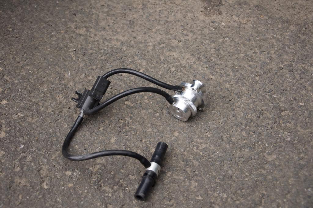

Just actualy realised that the N75 actualy comes as part of the Forge DV, it was that long ago since I fitted it  :ashamed:

You'll find if you unplug the n75 in your pic it will have the groove like the one I posted, Forge apparently use a tdi valve with the DV to allow it to work properly (vacuum operated?)
I will have another valve near the turbo (I'm ko4) that's the one I'll repose seeing as I have a new one sat here now :)

Did you find out a way to get that N75 valve without the groove to fit? I'm running into that problem. No groove, but I got a Forge DV on my MK5 GTI. In dire need cause I think it's whats causing the problem on my car. Thinking of just trying to manually carve a groove.

Would be awesome man! I'm thinking of just trimming the edge of the plastic myself. There shouldn't be a big difference between n75 valves. I'm sure the one they use is stock besides the groove.
