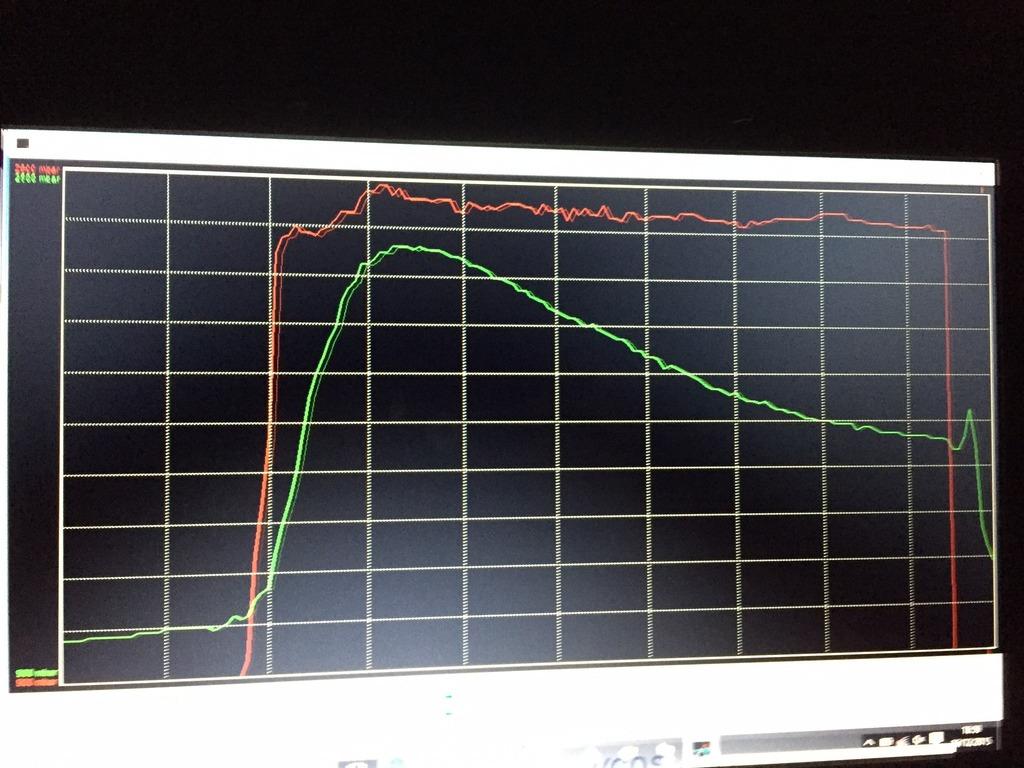

Evening guys did some logging with
@bluebert92
the other night on my turbo pressure side of things and it come up with this..... my tuner said my actuator is shot anyone else has seen this ?? Red is specified and green is actual

DV confirmed to be ok?

Rev g fitted this year and also running APR Intercooler
I've looked around the boost pipe no leaks from what I can see
