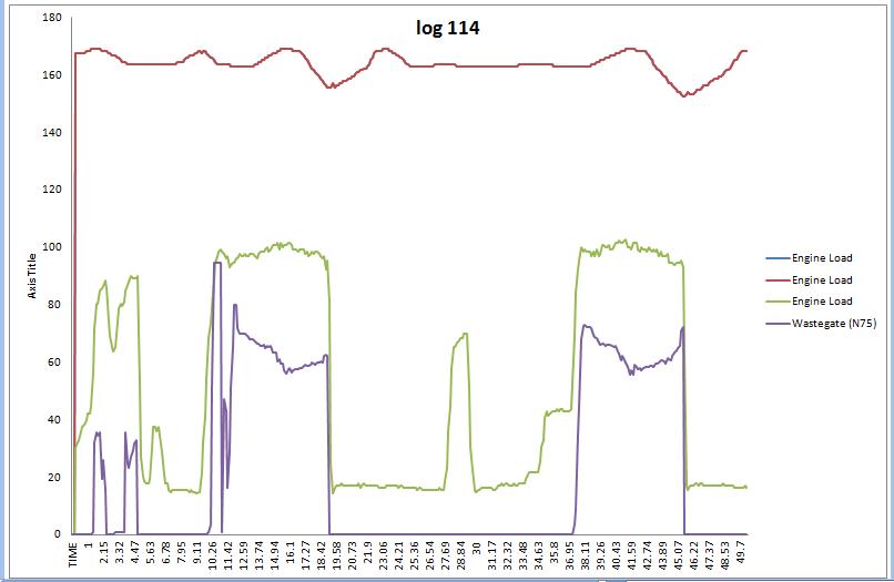

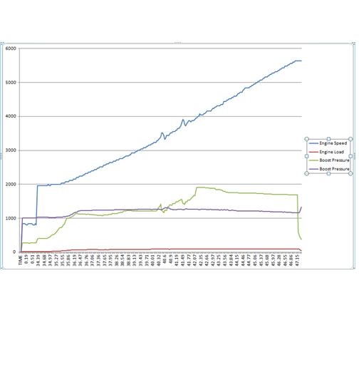

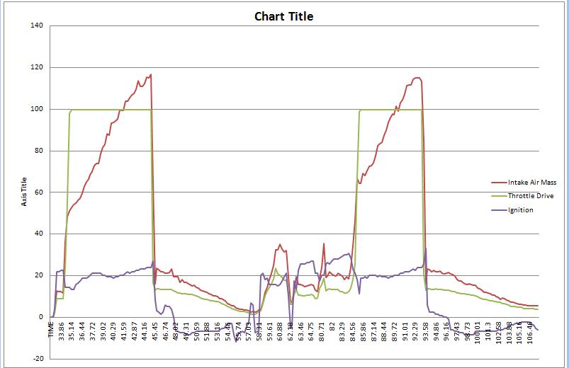

003
114
115
Offline cutchie
  • Posts: 19
Re: p0299
« Reply #9 on: December 18, 2015, 05:13:29 pm »
these are the graphs I logged but tbh I don't really know what im looking at or for! lol does anyone else see out anything out of place?

« Reply #10 on: December 18, 2015, 05:54:29 pm »
Can you share a link to the CSV files? Are they full throttle runs?

Re: p0299
« Reply #12 on: December 19, 2015, 12:36:08 am »
Not really helpful as those logs were done separately.
Log these blocks:
114 115 118
001 002 003
031 023 231
091 118 003
So log 3 at a time on each run (press the turbo button), and do a single full throttle run in 4th gear from 2k rpm to as high as possible. Only log this - no other data
