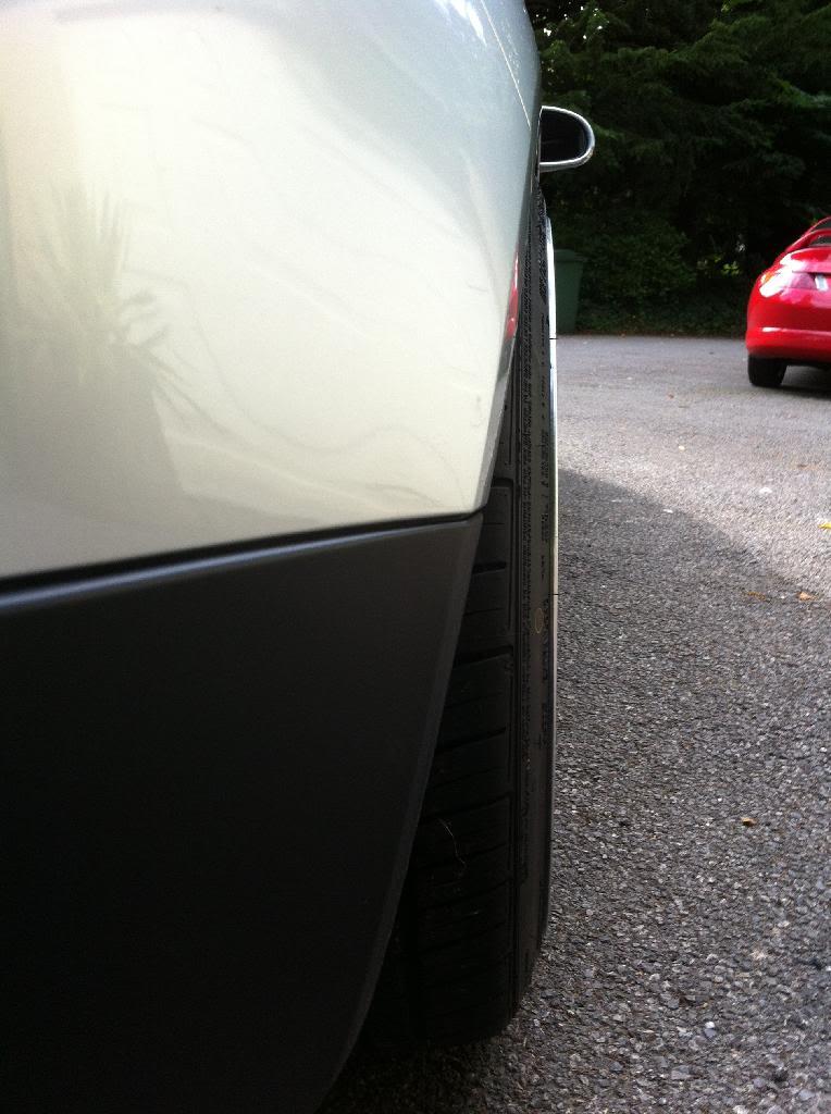

heres a pic before i added camber

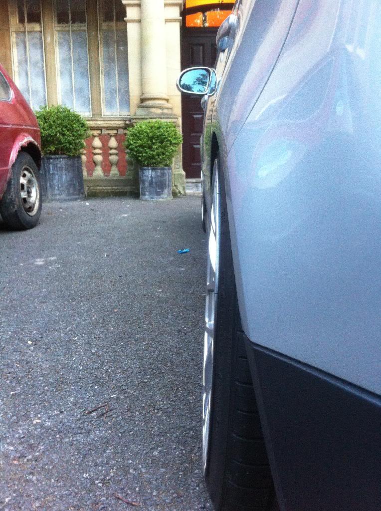

and after
Offline Chedburn
  • Posts: 43
Re: Will these fit?
« Reply #8 on: December 23, 2015, 04:59:46 pm »
Nice one, looking good!
