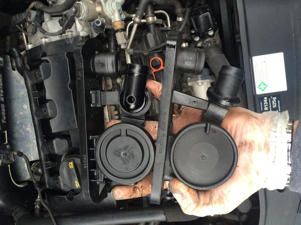

So I've had a second opinion, after already changing the DV and putting new platinum plugs in, down at Colin Gunning or Hertford. They immediately knew the issue and confirmed my initial thoughts that it was the PCV. I've got the PCV and new gasket ordered into my local Volkswagen for tomorrow morning. Hopefully this will solve the issues

« Reply #4 on: December 24, 2015, 10:39:35 am »
New PCV solved the issue, thanks for your input guys
