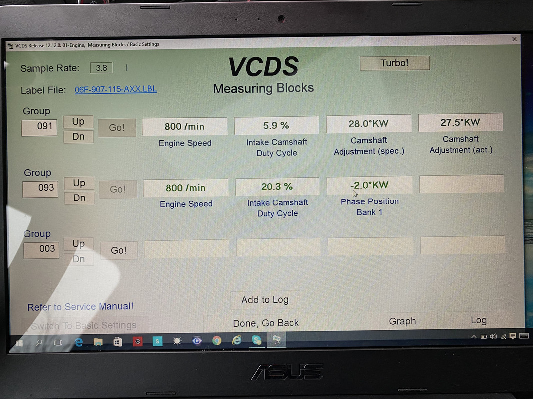

In the mean time I got to sneak out today and had some chain timing check
done…
Phase position bank 1 is -2*
What do you guys think?! Should I change it also or leave it?? :thinking:

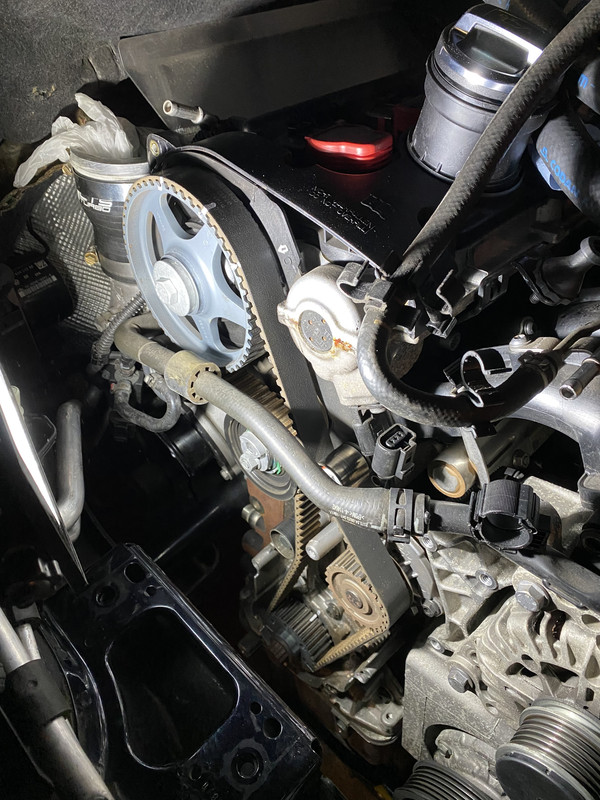

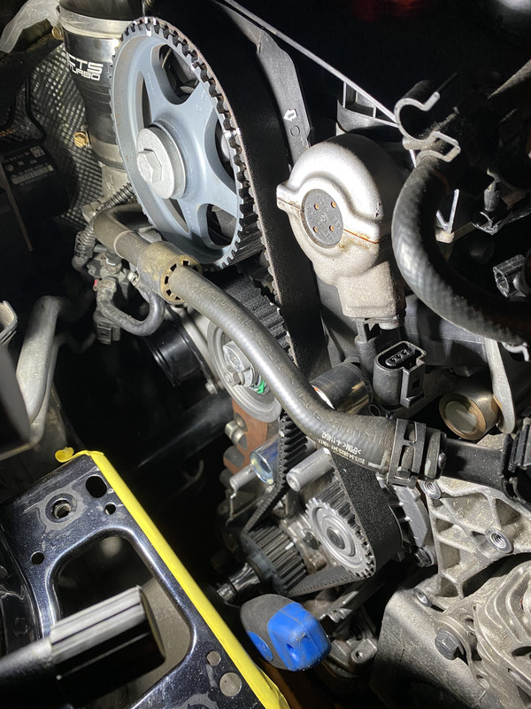

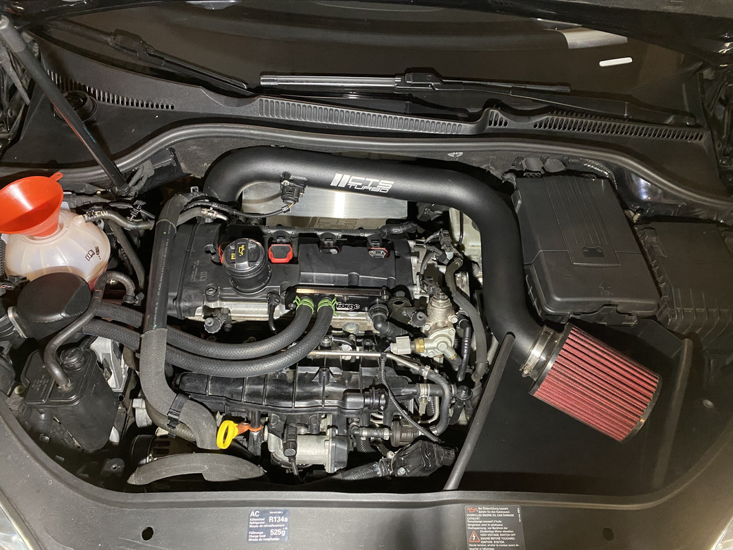

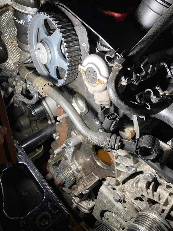

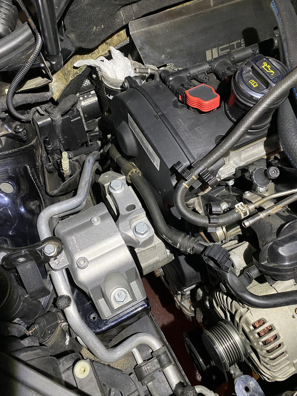

It’s been a couple of weeks now since the cambelt & co
have been changed… everything is allright, engine runs like a kitten :jumpmove:
And here are some shots…
Was a big job but very satisfying😁
The only trouble was the enginemount in the block…
That is the whorst piece of automotive engeniering!! to get out!!😓
But in the end it came out… just stayed calm and thought it over…😁

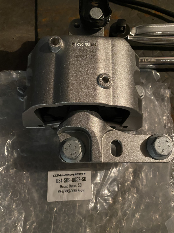

After instaling everything back, a 034 Motorsport enginemount came in.
Next up are the thermostats and the gearboxmount.Will do them in the next following weekends…
So will be continued here :wink:

« Reply #153 on: February 21, 2022, 02:06:19 pm »
Yes! You’re right! It’s actually not the enginebracket but the bolt from the timingbelt
Cover!! That little piece of s**t is hard to reach!! It’s on blind sight and feel to get a bit on to it!! Once it’s loose… it’s party :jumpmove: remove the cover first then
rise the engine completely up!!! And then at last whigle the bracket out… :jumpmove:
Maybe a tip : when putting it all back together… I used the old roller to tighten the belt and check timing. Then I removed it and marked the belt… whigled the bracket and cover back into place. Then I put the new roller on (tightend it to 25Nm).
Tightend the timingcover bolts (7 of them to 8Nm) and then the enginebracket. I think it was 3 x 45Nm for the bolts.
The rest was all simple 😁

Must apologise but family stuff is taking over my weekend!!
So timingbelt & co will be for next weekend…
done…
Those numbers look OK  :happy2:

@Pudding: thanks for the info :happy2:
I was having doubts … should I change it or not… but I bought the whole set so I’ll change it anyway :wink:

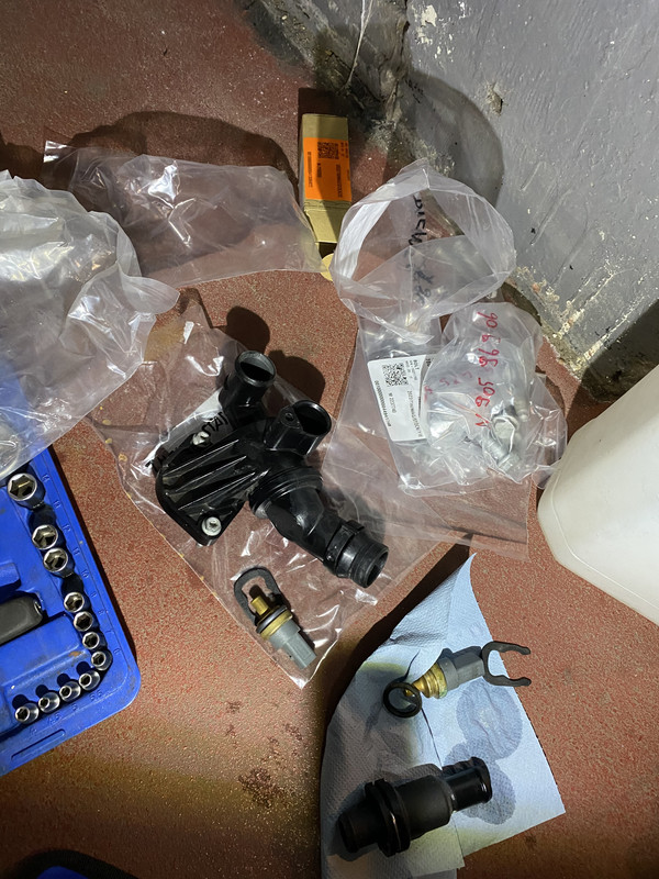

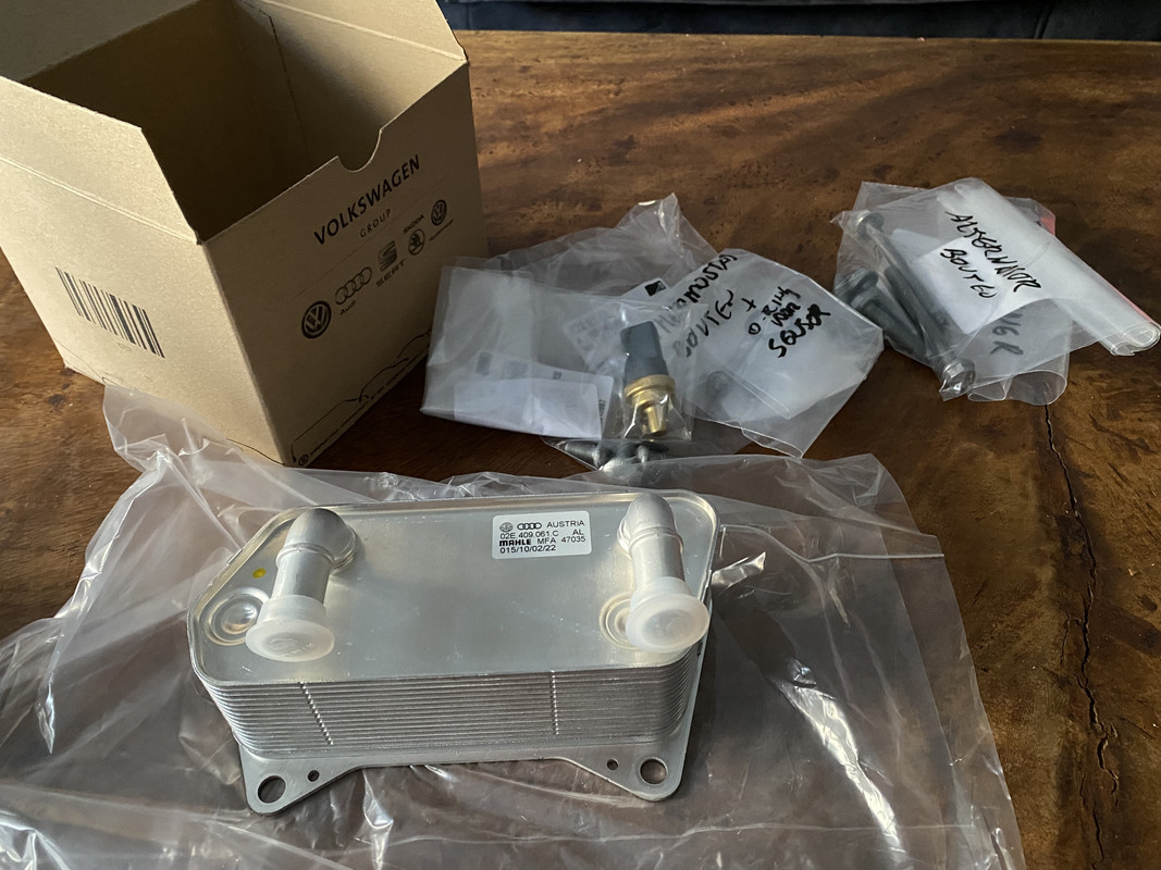

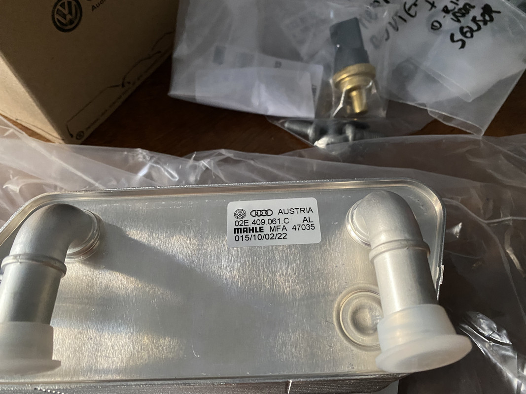

Finally the other parts arrived today😁
Got the temp sensor and bigger DSG cooler with some other bits & bolts…
If everything Goes to plan, this friday I’ll change the 2 thermostats, temp sensor, cooler and again fill up with coolant👍🏻

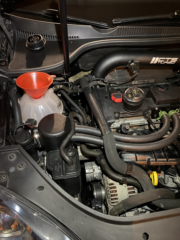

Hi everybody  :wink:
It was time to get back in the garage…
I thought it would be a 3 - 4 hour job… boy was I WRONG!! :doh:

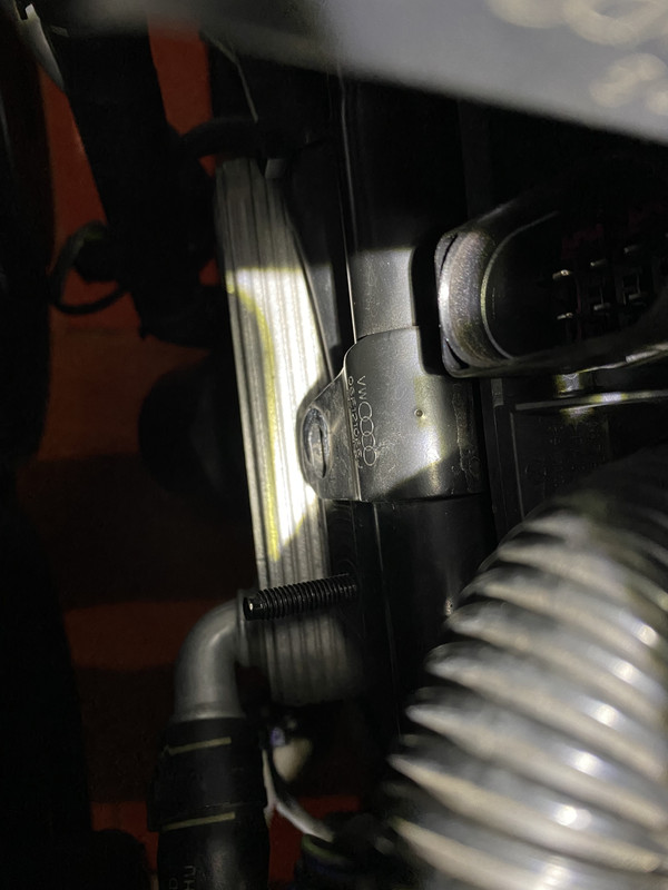

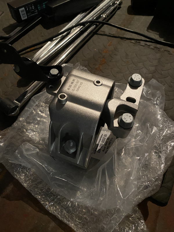

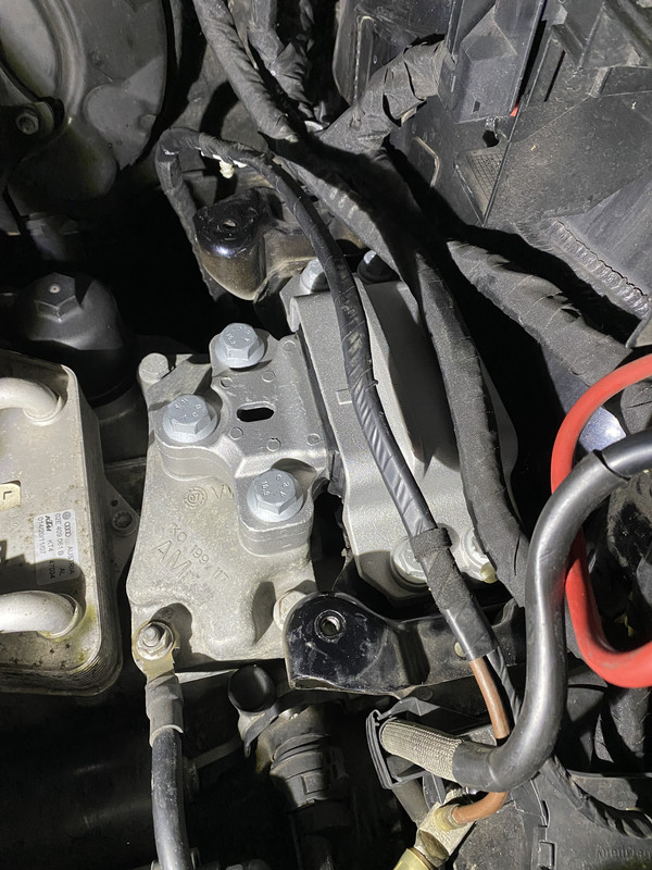

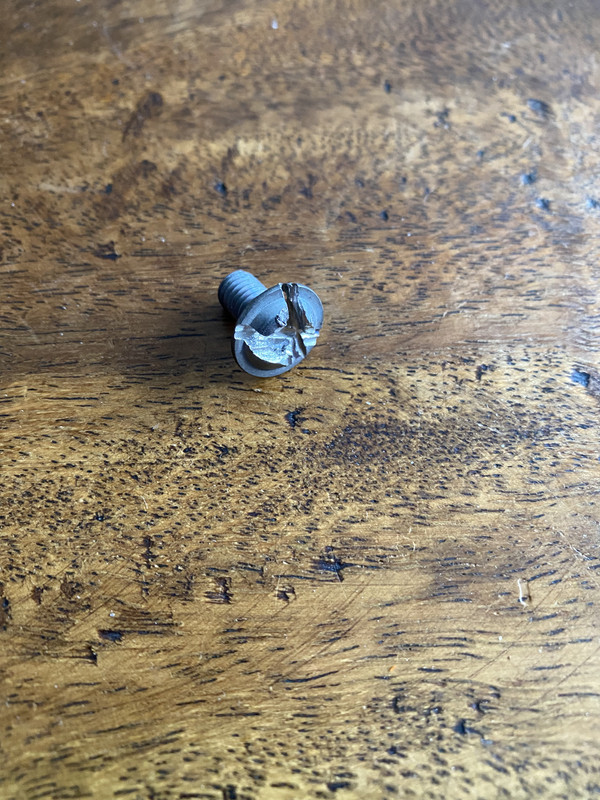

So next step was to change both themostats and temp sensors…
In the whole process I also changed the aircon compressor, DSG gearbox mount from 034 Motorsports (Density) and put in a new Varta battery.

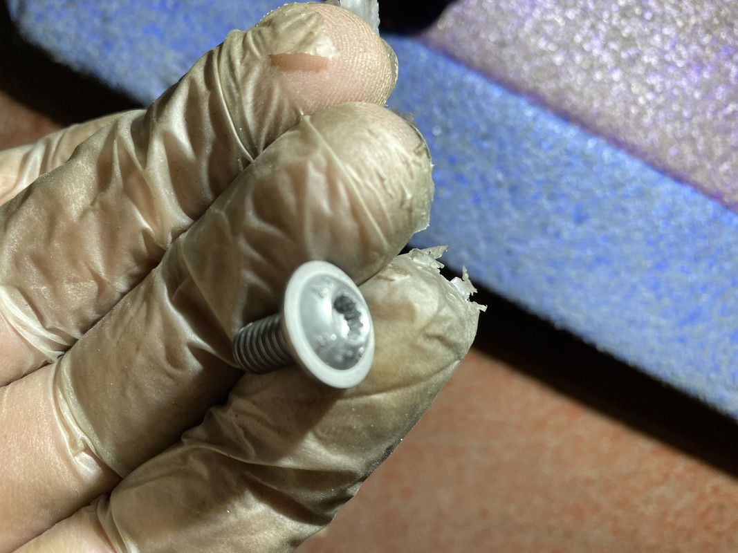

The hole taking appart went fairly smooth until I came across the 5mm triple square which holds the coolant line that goes to the big themostat on the engine block  :slap  that was a real nightmare to get loose/off 😡 but in the end it surrenderd!
In the whole changing out proces I forgot to take some pics  :doh:
In the end I got to change all of that stuff :jumpmove: BUT!!! It took a whopping 10 hours to do all that!!!
Also a wake up call to reality for me… I AM NOT 20 years anymore!!! My
Body is a wreck today😵
But anyway a couple of pics show the stuff I did…

Yeah - why on earth the decided to use those 5mm triple square bolts, they are really annoying.
I suppose they do get used in a few more places on the top end of the engine.
When I changed my thermostat it was something like a 7 hour slog in the rain - I can only dream of a subterranean workshop/lair like yours!
Despite studying the pelican parts guide, I also had to dremel a groove in one of mine after thinking it was a torq.
Can't believe how rust free everything is on yours too!

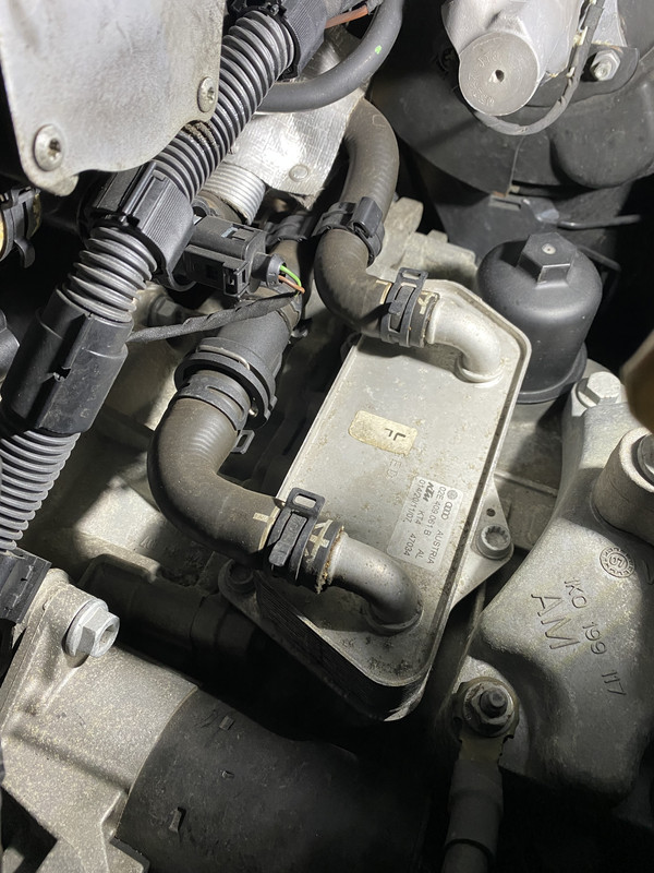

Offline Mekaniko
  • Posts: 129
Re: Edition 30 powered by RBS

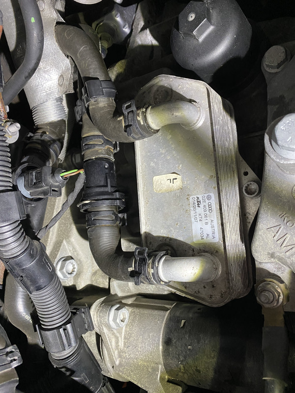

« Reply #163 on: March 21, 2022, 04:31:57 pm »
This second themostat and cooler is for the DSG oil or engine oil?
Very good job with all of that!!
« Last Edit: March 21, 2022, 04:33:37 pm by Mekaniko »
Offline RBS
  • -Receive: 49
  • Posts: 529
« Reply #164 on: March 21, 2022, 06:56:57 pm »
@Mekaniko
yes the small thermostat and cooler are for te DSG box and it is watercooled not oil cooled! :wink:
