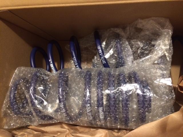

As promised :
H&R parts
Next up is cleaning the intake and put it on the rollers! We'll see this thursday what it gives completely stock. The moment of truth :signLOL:

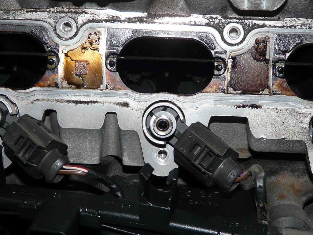

Since your mechanic will have to take the front of your Ed. 30 to fit the IC, it's not that hard to do the intake cleaning. With the front out is much easier to replace the fuel pressure return valve too.
Look at mine with 57.000 km:
My mechanic and I weren't expecting that it was this bad with so few km... :sad1:
It made 243 BHP with all that gunk in the valve stems...
I'd also recommend replacing all thermostats (your car has 2) and temperature sensors (I think you have 2 as well) because they're not that expensive parts, are prone to malfunction and it's the labour to replace them that can be a PITA.
