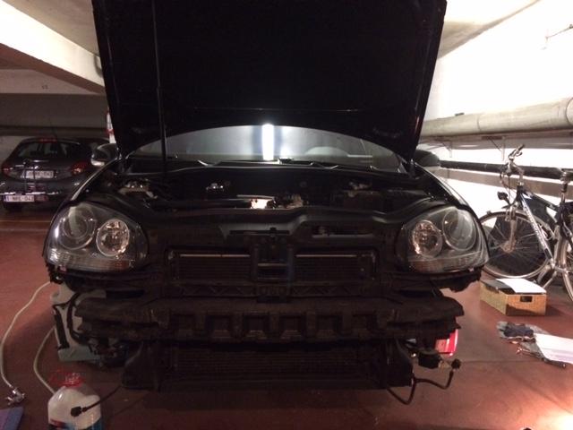

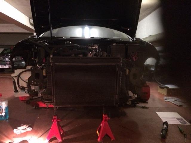

It's about time I posted some updates here :wink:
Been very bussy in my garage, inspected and changed the camfollower after 55.000km.
Had a little bit of ware but nothing special. Put in a new one for peace of mind.

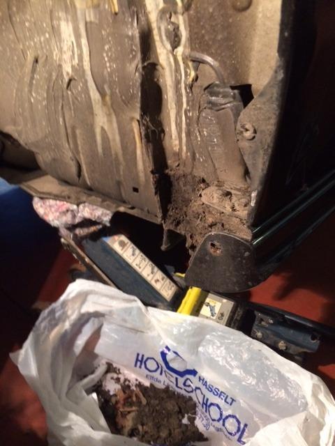

Next up were the innerline protection guards at the front.
Took them out and found a lot of dirt and leaves hiding in there!!! :surprised: :surprised: So cleaned them out too.
Then thought, why not put the tyrrolsport brake bracket support in too. Took the induction kit and battery out. Cut a piece of the battery tray out to insert the bracket. It's a well designed piece of kit which prevents movement of the master brake cylinder.
By the time everything was almost done I managed to drop a torxbit right in front of the engine bay :confused: :doh: :doh:
Looked with a lamp into the compartement but couldn't find it!!!
That ment one thing:

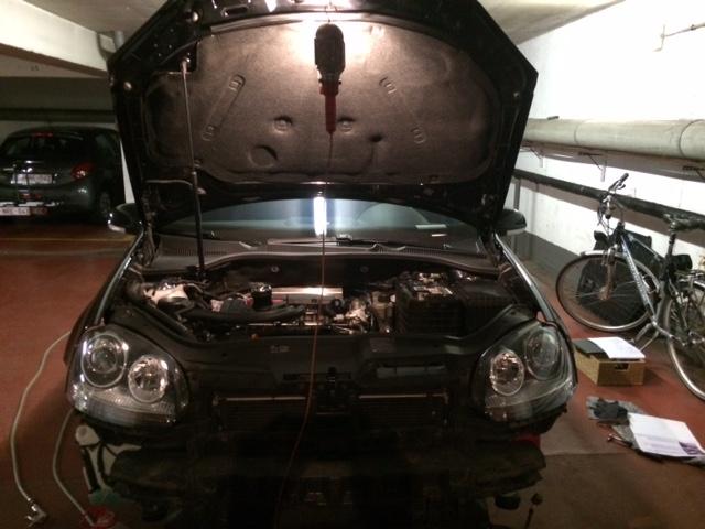

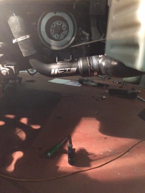

Take off the complete front of my Eddy and finally put in the THS Intercooler along with the CTS pipes and hoses!!:signLOL:
That was a BIG job!!!
What a giant intercooler it is next to the original!!! Same with all the pipework!! They look gigantic comparing it with the stock oem charge pipes!! :surprised:
After the complete front was out I finally found the bit hiding next to the AC compessor!!  :jumping: :jumping:
But all this means nothing without pictures so here they are :wink:
« Last Edit: October 04, 2016, 10:01:43 pm by RBS »

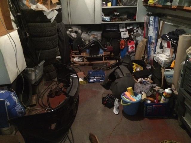

Here they are
I filled 2 bags of dirt!!
Look he's smiling @ me :grin:
Alladin's cave :wink:
What a job :stupid:
some pipe & hose work

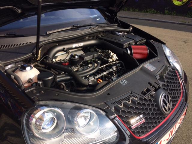

I took some pics today of how it looks now before I finally get it a bit lower to the ground.
Still no document for H&R prings :sad1: Hopefully I'll get it this week.
When my foto's are uploaded I'll post them :happy2:
Offline RBS
  • -Receive: 49
  • Posts: 527
Re: Edition 30 powered by RBS
« Reply #100 on: October 11, 2016, 09:06:06 pm »
Here they are :wink:
Last time it's looking like this :smiley: next time I take pictures it'll be a little bit lower to the ground :wink:
