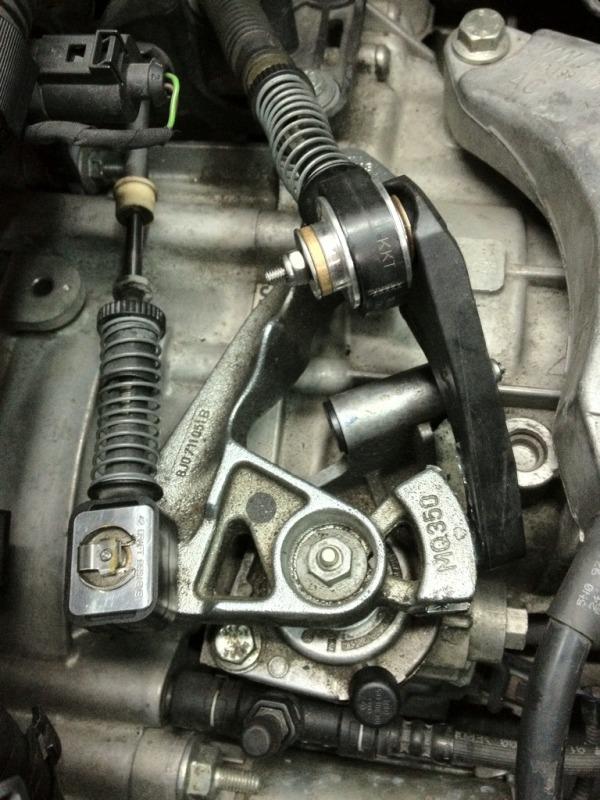

Update 3/03 - 42 Draft Designs Shifter Bushes, RS4 Fuel Pressure Valve & New Miltek
Well I went back to get the rest of the parts done at my tuner which was 42 draft design shifter bushes, RS4 fuel pressure regulator valve & a new Miltek back box as my old one started to crack which Miltek replace FOC as it has lifetime warrenty.
So firstly onto the 42 draft design shifter bushes here is what it says about them
"Eliminate sloppy shifts forever!
Our CNC machined shifter cable bushings tighten up the movement of your shifter cables, literally connecting your hand to the gears. In a performance situation, the factory rubber bushings flex causing a delay in the engagement in the gears. Our bushings eliminate this delay and provide a precision shift free of slop or hesitation.
Our shifter cable bushings are CNC machined from 6061 aluminum and fit precisely within the factory endlink. Each bushing is sleeved with an oil-impregnated bronze bearing. This bearing provides constant lubrication and a lifetime of use without wear.
Specifically machined for a variety of fitments, our shifter cable bushings provide instant results. Installation is a simple task and requires only slight modification to the side/side endlink. If you're looking to feel your shifts, these bushings are the answer"
Here are pictures of them fitted to the car
I can honestly say its one of the best mods ive done, The gearbox throw feels alot sportier & more solid without it being hard to put in gear. I dont know if I am just thinking it but it also feels alot quicker through the gears but was worth the £40 they cost just for the feel.
