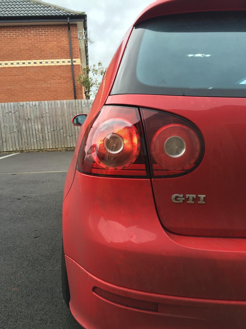

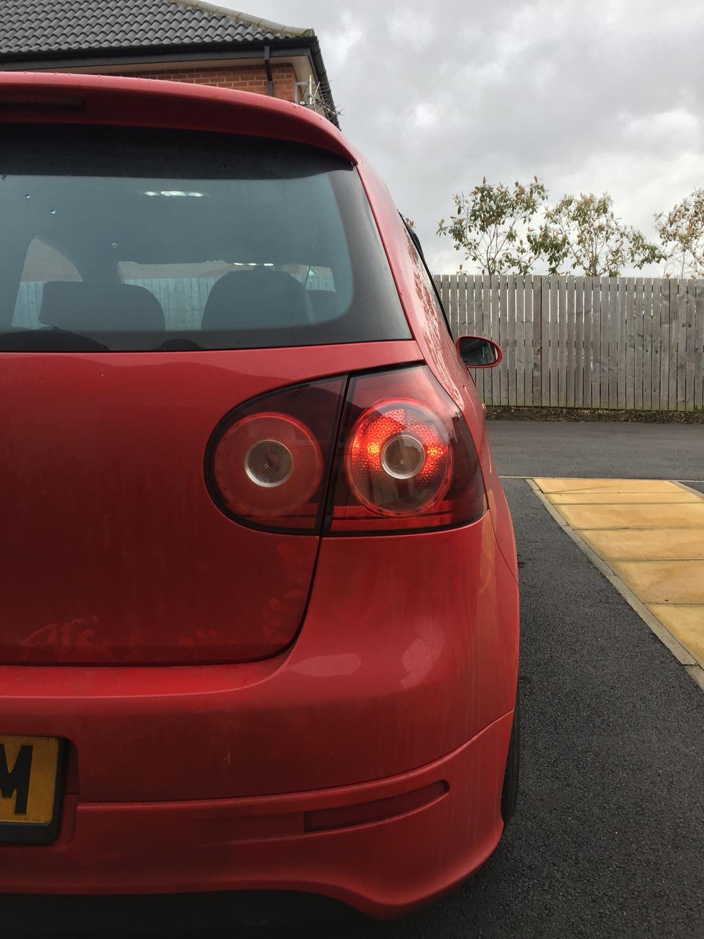

I've got a niggling issue which is annoying me a bit. I've got R32/Ed30 rear lights on my Gti and the tail light output is uneven around the cluster, hopefully the pictures below highlight the problem.
My question is...has anyone come across this before? I've had a look at the bulbs and they are Osram and look ok to me, is it likely to be the bulbs? Is it an issue with the clusters themselves?
Excuse the mucky car, it will be getting a clean tomorrow :ashamed:

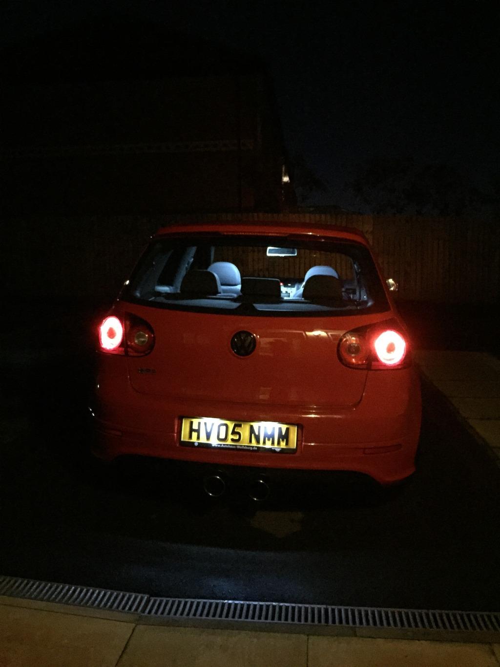

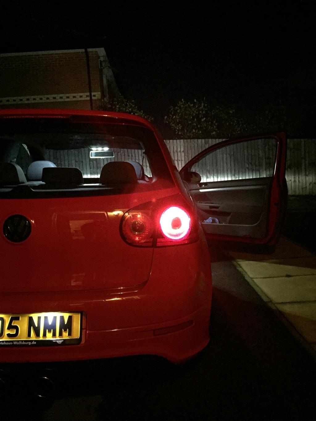

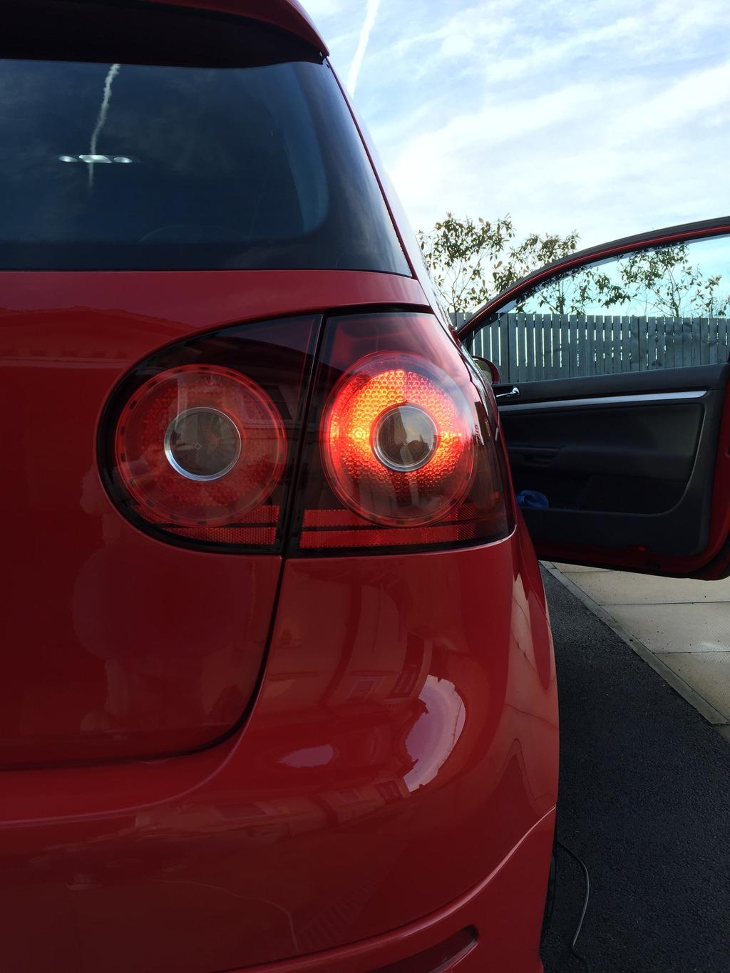

Ok, had a play with VCDS earlier, I turned them up in 10% increments. It got to 60% (started at 20%) and it looked like this:
They looked too bright and still weren't even, I was also a bit concerned that the brake lights wouldn't be obvious enough in daylight, I turned them back down to 40% and then my battery died! An RAC visit and £122 later I got a chance to look at them at 40%:
Quality of the pictures isn't great but in the dark the lights look fine.
BC Racing Coilovers : R32 Rear Bumper : Milltek Cat Back : R32 Rear Lights : S3 Brakes : Colour Coded Side Skirts : US Grill : 18" BBS CH : De-Wipered : Bluefin Remap : Pipercross Filter : S3 Short Shifter : Powerflex Wishbone Bushes : MK6 Steering Wheel : RCD510
